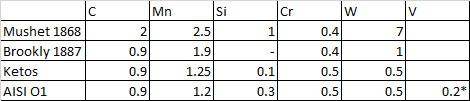

The design and evolution of the composition that became O1 cannot be nailed down exactly, but it does look like a steel that grew out of what was common at the time [6]. The first tool steel was “Mushet steel” developed in 1868 with 2% C, 2.5% Mn, and 7% W. This steel was air hardening due to high manganese and had high wear resistance due to the high carbon and tungsten. It was the main tool steel used other than simple carbon steel for about 25 years. Prior to the work of Taylor and White in the development of high speed steel, there was some evolution of alloying, particularly with testing different combinations of Mn, Cr, and W. There were experiments with “chromium-tungsten” steels as a replacement for the “manganese-tungsten” Mushet steel. In the decade 1880-1890, experiments in France were being conducted on chromium-alloyed steels. And by 1890 there were some studies on low alloyed steels with a combination of chromium and tungsten. By 1887 there is record of a steel with a somewhat similar composition to O1 produced by Brooklyn Chrome Steel Works. Much higher chromium and tungsten contents were those primarily being explored from about 1894 onward leading to the 4% Cr 18% W steel that became the first high speed steel. Therefore O1 looks more like those earlier 1890-era steels which were not being explored specifically for high speed applications. The earliest reported composition I found for O1 is from 1925 [7], it is hard to say how much it might have changed between 1905 and 1925.

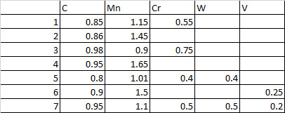

Here is a range of measured compositions from seven manufacturers reported in 1925 [7]:
In the same 1925 article by James Gill (read about him here) he reported that the ~1.6% Mn version was more prone to cracking and grain growth than the lower Mn version with Cr and W. He preferred the O1-type composition, particularly when it had the vanadium addition for grain pinning. Gill liked vanadium additions in general and he worked for the Vanadium Alloys Steel Company. The resistance to cracking and the lower sensitivity to hardening temperature of the O1 composition may have been what led to the modification from the original O2.

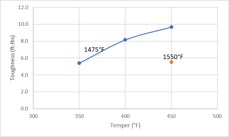

Toughness Testing of O1

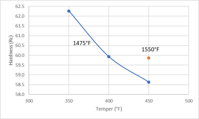

Here are toughness numbers of O1 austenitized at 1475°F or 1550°F for 10 minutes, quenched in fast oil, and tempered between 350 and 450°F. The samples were heat treated by Warren Krywko and machined by Alpha Knife Supply. Austenitizing at 1550°F led to a reduction in toughness either due to an increase in plate martensite or grain size. Tempering up to 450°F did not lead to tempered martensite embrittlement. It may be worth trying 1450 or 1500°F but for now my recommended austenitizing temperature is 1475°F. Medium oil like Parks AAA can be used with O1 due to the high hardenability. A cold treatment can be added after the quench for a small increase in hardness as well as a corresponding decrease in toughness (not tested here).

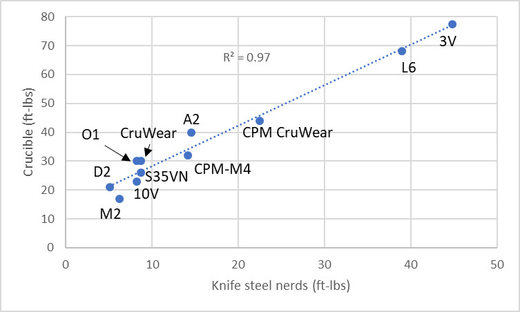

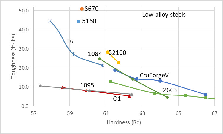

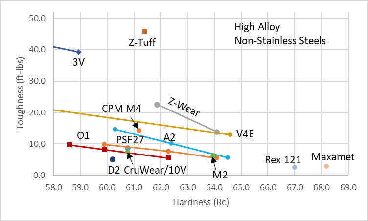

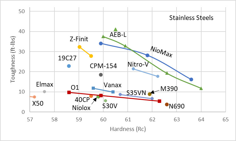

Despite the fine carbide structure of O1, its toughness is not particularly high when compared with other steels. For example, A2 is probably the closest counterpart to O1 in terms of use in die steels but is air hardening instead of oil hardening. However, A2 has both better toughness and wear resistance than O1, despite the fine carbide structure of O1. I believe this is due to “plate martensite” in O1 but can’t say for sure.
The relatively poor toughness of O1 seems to be a consistent finding whether in toughness testing of Knife Steel Nerds, Crucible, or Carpenter. It’s not that the toughness of O1 is especially bad, but that for its fine carbide structure and low level of wear resistance the toughness would be expected to be better. Here is a comparison between Knife Steel Nerds and Crucible toughness numbers showing that they correlate very well and that the results for O1 are also similar (note the scales are different due to different sample geometries):
