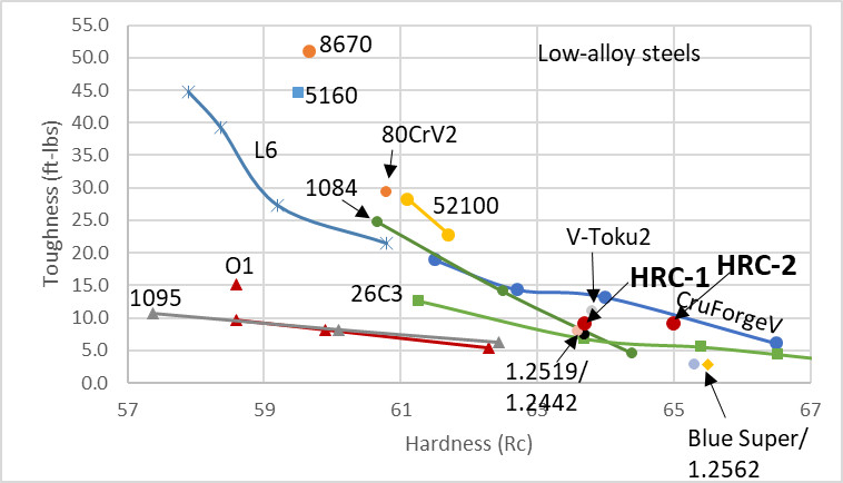

1.2562 Toughness

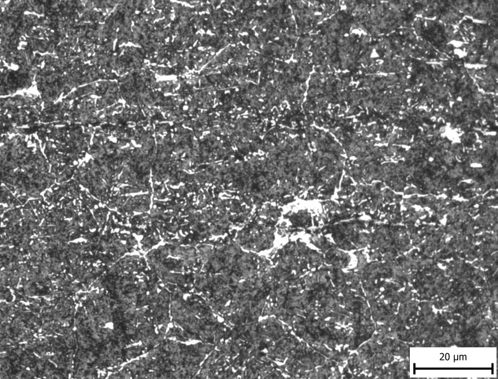

I previously reported a toughness value for the low alloy tungsten steel 1.2562 which scored relatively low. I wrote about the toughness of this steel in the context of other low alloy steels typically used by forging bladesmiths. You can read that article here. I concluded that 1.2562 had low toughness due to “plate martensite” which is difficult to avoid with high carbon low alloy steels, as well as poor carbide structure which included both carbides along grain boundaries and some larger tungsten carbides.
1.2562 area 1 – many carbides visible along grain boundaries
1.2562 area 2 – a large tungsten carbide

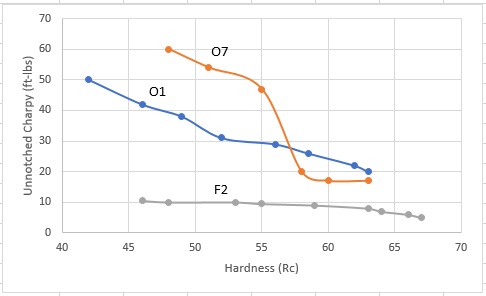

My toughness measurements were consistent with earlier reported values for F2 steel, which was found to have relatively poor toughness:
Data from [1]
New 1.2562 Toughness Measurements

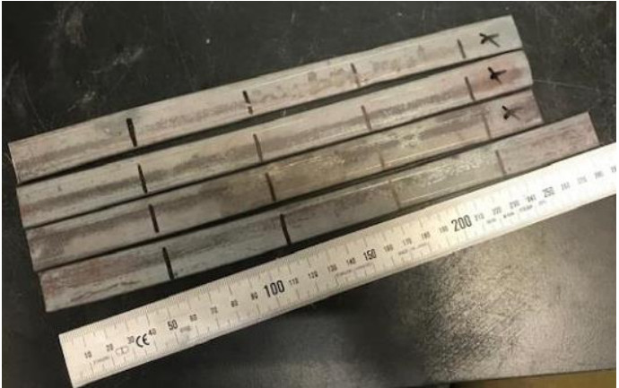

Knifemaker Marco Guldimann contacted me after my toughness measurements of 1.2562 and said he wanted to show that the toughness could be improved. I said I would be interested in seeing the results of whatever experiments he wanted to perform and recommended that he use the same toughness specimen dimensions so that his results could be directly compared to ours. We use a subsize unnotched charpy specimen which is 2.5 x 10 x 55 mm, the exact specifications can be seen on this page. All of the experiments, toughness testing, microscopy, hardness testing, etc. were performed by Marco and a metallurgy technician. I did not perform any experiments or evaluate any specimens. These are the first toughness results I am reporting on that were not tested by myself.
Processing of Steel

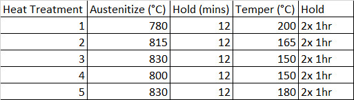

Marco wrote about the processing of his steel and how it was tested in a report; you can read the full report here. Marco wanted to have as much reduction in forging as possible, and this steel does not have particularly great availability and so thickness options are limited. Instead, he forge welded several pieces together, forged them out, cut and restacked, and forge welded and drew out to a final thickness of 3.3 mm. All forge welding and forging was performed between 900 and 750°C (1650-1380°F). These are relatively low temperatures for forging; Marco chose these temperatures because his primary goal was achieving a fine grain size.

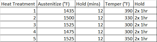

Marco next performed a “temper anneal” by austenitizing at 770°C (1420°F), quenching, then tempering at 690°C (1275°F). The specimens were then given one of 5 heat treatments and tested for toughness and hardness. He heated the samples in a furnace and quenched in molten salt at the tempering temperature of each condition, followed by air cooling. Then each steel was tempered at the indicated temperature.
And in Fahrenheit instead:

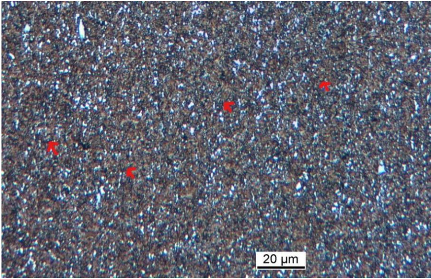

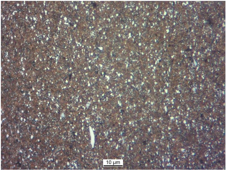

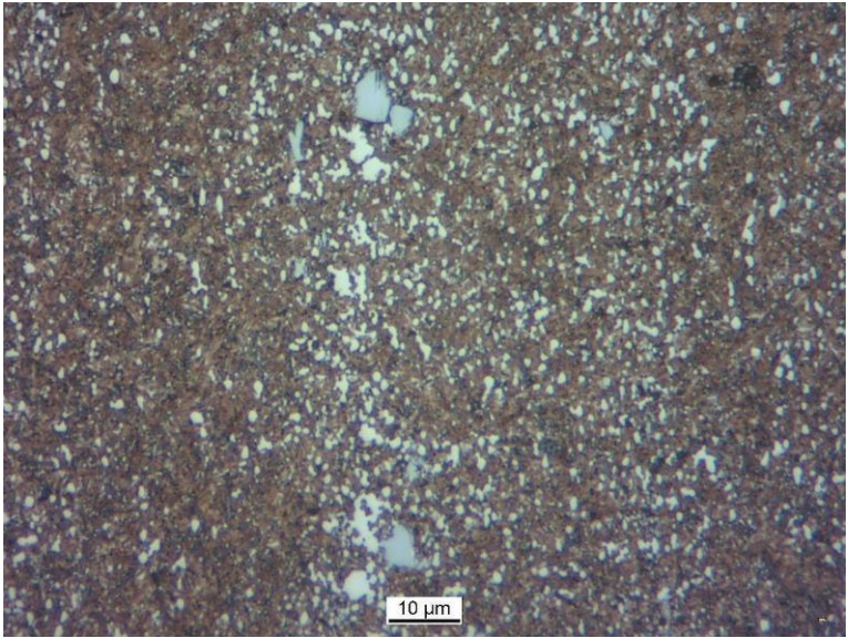

Carbide Structure
No grain boundary carbide was observed in the micrographs shared by Marco, showing that the “thermomechanical processing” (temperature plus forging) led to the elimination of those carbide networks. There were still regions of larger carbides, especially when found in bands in the steel. Perhaps with a higher initial forging temperature those larger carbides could be eliminated, as Thermo-Calc predicts that the tungsten carbides would be dissolved at about 2075°F.
Area with larger carbides in a sample of heat treatment 2
Area with more even carbide structure in a sample of heat treatment 3

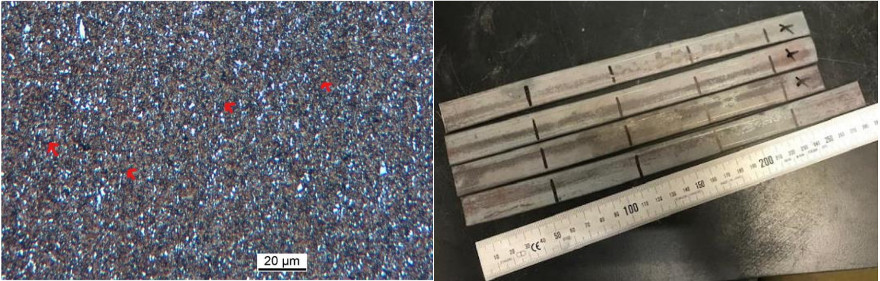

Grain Structure
Revealing grain boundaries in metallographic specimens is very difficult, often requiring specialized etchants and even then revealing them completely is challenging. To demonstrate grain refinement, Marco and the technician helping him pointed out a few visible grains. This is not a good way to measure an average grain size, and no comparison was made to an unprocessed specimen but the visible grains are relatively small, on the order of several microns, and Marco claims an ASTM grain size between 11.5 and 13.
1.2562 steel with a few visible grains

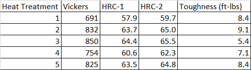

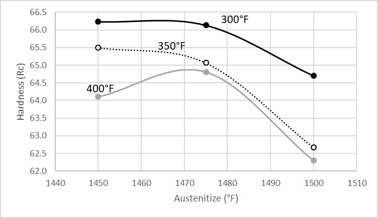

The hardness of each specimen was measured with Vickers and with Ultrasonic Contact Impedence (UCI). I will show both the Vickers value and a conversion to Rockwell C. Conversions between hardness scales is never perfect but gets into the right ballpark. I used two different conversion scales for hardness which are shown as HRC-1 [2] and HRC-2 [3]. The HRC-1 value comes from a hardness conversion from Professor Paul Beiss who created it by using with a large database of values taken with high hardness high speed steels. The HRC-2 value comes from the standard ASTM conversion which agrees better with Marco’s UCI hardness measurements. Three toughness specimens were tested and averaged for each heat treatment which is also shown.
The hardening response was surprisingly lower than in the specimens that I heat treated, such as heat treatment 4 which used 1475°F and a 300°F temper which resulted in about 60.6-62.3 Rc where instead I got over 66 Rc. Higher hardness values were instead seen when austenitizing at about 1500°F. 1500°F was where I was seeing a drop in hardness, presumably due to excess retained austenite. I used hold times of 10 minutes and Marco used 12 minutes, and neither of us used cryo in heat treating.
There are several reasons why the optimal austenitizing temperatures could be shifted higher, such as furnaces that are reading different temperatures, decarburization, different starting structure, or grain refinement. I don’t think that our furnaces would be so far off from each other though that can’t necessarily be ruled out. Decarburization would presumably show up in the micrographs and they did not report any. Different starting structures resulting from different processing and annealing can show up in the final heat treatment. For example, a martensite structure leads to rapid response in heat treatment so lower temperature or shorter hold times are possible. Pearlite structures are a bit slower, and spheroidized carbides can be similar to pearlite or slower depending on how coarse the carbides are. You can read more about the effect of these starting structures here. However, the temper anneal performed should lead to a relatively fine starting structure so I wouldn’t expect a major difference in diffusion time required. Grain refinement can lead to poorer hardening response, however, sometimes requiring higher austenitizing temperatures. Sometimes this is to get enough grain growth to have sufficient hardenability, as 1.2562 is already a low hardenability steel and with some grain refinement it would be even more difficult to harden. It could be that the molten salts Marco quenched in were somewhat slower than the Parks 50 which would be even more significant after grain refinement. Molten salts are typically faster than oil at higher temperatures and slower as the temperature decreases.
The best heat treatment, #2, in particular looks much better than my toughness measurement, resulting in values that look close to what was achieved with CruForgeV, 1.2519, 1.2442, and V-Toku 2. I have noted both HRC-1 and HRC-2 values because of the uncertainty with hardness conversion.
