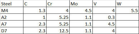

In the early 1900s, high carbon-high chromium steels were developed, and during World War I in England they were used as an alternative to high speed steels with high tungsten content. Tungsten was very expensive and only available to mine in certain countries and so during war it could be difficult to obtain. The earliest common high carbon-high chromium steel was approximately similar to D3 steel, which has higher carbon than the more common D2 which came a couple decades later, though both have about 12% Cr. And while it was discovered that these 12% Cr steels didn’t work nearly as well in high speed machining tasks, they were very good for “cold work” tools, particularly dies, because of excellent wear resistance from the many chromium carbides. You can read more about the development of D3 and D2 in this article. Later there were other modifications of D3 such as D4 which had higher molybdenum for greater “hardenability” meaning it could be quenched more slowly and still achieve full hardness.
High vanadium steels were patented in the late 1930s which became steels like M4 and T15 with 4-5% vanadium. It was found that vanadium carbides are extremely hard and therefore contribute greatly to wear resistance with high speed steels. You can read more about the development of high vanadium steels, M4 and T15 in this article about the metallurgist James P. Gill who developed those steels. Around 1950-1951, David Giles of Latrobe Steel patented two “cold work” high vanadium steels [1][2] which were later named A7 and D7. A7 was a modification of A2 with higher carbon and vanadium for wear resistance. D7 was a modification of D4 with higher vanadium for the same reason. These were the highest wear resistance cold work tool steels for several years before the introduction of powder metallurgy steel production in the early 1970s which allowed the design of even higher vanadium steels like 10V.
In the early 1980s, Bohler steel introduced K190 steel which is a powder metallurgy version of D7 [3]. Bohler promoted the improved toughness and machinability of K190 vs conventionally produced tool steels like D2 because of the powder metallurgy process which led to a refined carbide structure. For the plastics industry Bohler also wanted to have a high wear resistance powder metallurgy product which had high corrosion resistance (ie stainless). Despite the relatively high chromium in K190, it is not stainless, you can read why in this article on D2 corrosion resistance. As stated by Bohler, the design target for M390 was to have high wear resistance and corrosion resistance, though they stated that high toughness is not particularly necessary for plastics processing.

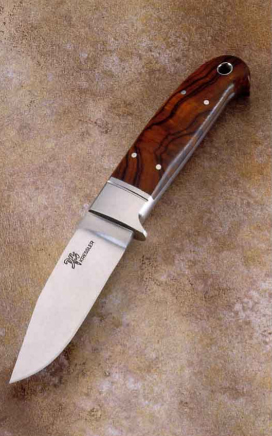

M390 was one of the earliest powder metallurgy stainless tool steels, coming after S60V but before SG2, Elmax, S90V, ZDP-189, or S30V. However, it was not commonly used in knives until after the release of any of those products. The general lack of M390 in knives was presumably because Bohler was more focused on selling the steel to the plastics industry. It saw limited use in some European custom knives, such as this knife by Dietmar Kressler made in 1999 [6]:
Dietmar Kressler knife in M390 made in 1999 [6]

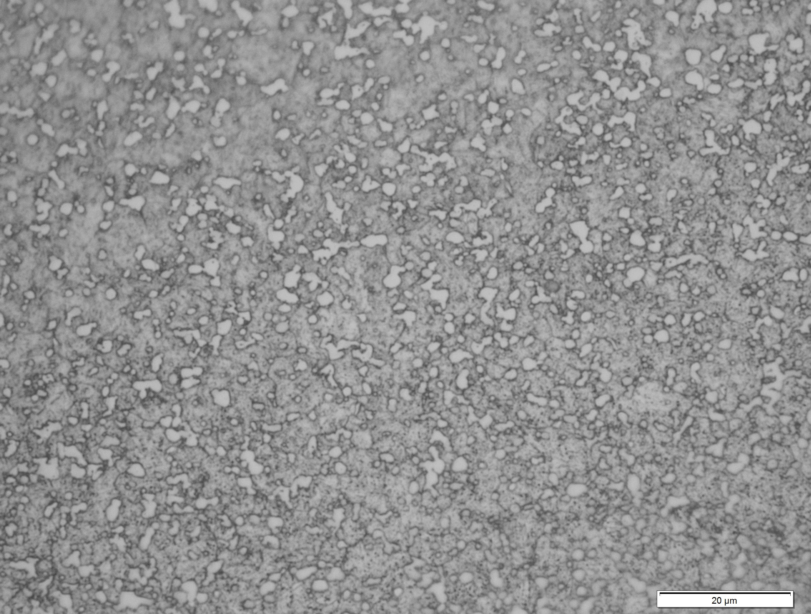

The high chromium content in M390 means that less of the high hardness vanadium carbide is present in the steel, and the majority of carbide is the lower hardness chromium carbide. The vanadium does increase the hardness of the chromium carbides, however. You can read more about the interaction between different elements for carbide formation in this article on carbides.  Chromium carbides tend to be larger than vanadium carbides in power metallurgy steels which limits toughness, but they are easier to sharpen because they are softer than common sharpening abrasives like aluminum oxide. Bohler reports that M390 has about 18% chromium carbide and 2.5% vanadium carbide [20], and in my metallography I found about 22% carbide. This high carbide volume results from the high carbon and chromium in the steel, which puts its carbide content similar to steels like Maxamet, S90V, and 15V. The high volume of chromium carbide means that M390 has a larger carbide structure than those steels, however. Stainless steels with a lower carbide content like S35VN, S45VN, or Vanax also have a finer microstructure. You can compare with many other steels in this article which contains all of my micrographs.

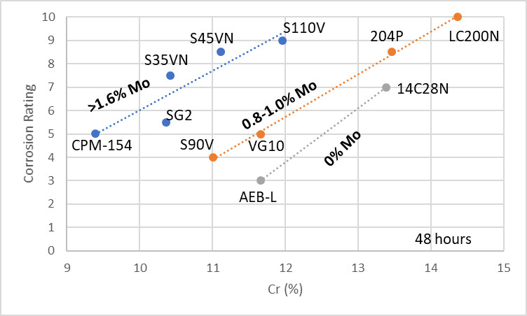

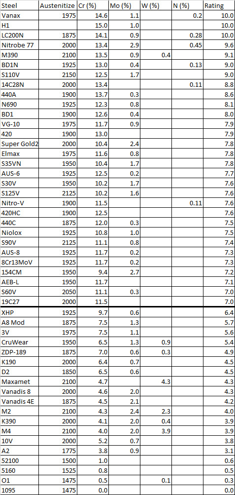

M390 has relatively high “chromium in solution” which is the primary factor that controls corrosion resistance apart from molybdenum and nitrogen. In my corrosion resistance testing, M390 scored very well (I tested CTS-204P), better than S30V, S35VN, S90V, and SG2, and probably a bit better than S45VN. It did not do quite as well as S110V or LC200N. Vanax would also be expected to have superior corrosion resistance though M390 is likely better than Elmax. Overall, the corrosion resistance of M390 is quite good. Below is a summary of my corrosion resistance test where a higher score means that it rusted less in a 1% saltwater test. I also have a chart which estimates corrosion resistance based on Cr, Mo, and N in solution using the results of my corrosion resistance testing which I have shown below.

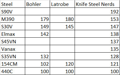

The edge retention of M390 is also relatively high from its high carbide content and the 4% vanadium addition. This good edge retention has been confirmed in many tests, including CATRA results from Bohler-Uddeholm, Latrobe, and my own. The Latrobe data shows all results relative to 440C, where 440C is set to 100, and every other result is divided by 440C to show how it does in comparison. Therefore, I did the same simple math with the Bohler-Uddeholm and Knife Steel Nerds data so that they can be easily compared. You can see the rest of the Knife Steel Nerds data which includes 48 different knife steels here. The Bohler and Latrobe data show a similar result for M390 edge retention while my testing was somewhat lower. Despite the Bohler and Latrobe numbers seeming to confirm a higher result I believe the Knife Steel Nerds number is more reliable (I know, I’m biased). Edge retention estimates based on the carbide content of M390 tend to predict a value closer to what we tested. The relative edge retention I tested is also close to the values found in the dataset presented in this article which came from a major knife manufacturer. I don’t know why the Bohler and Latrobe values are higher, however. The Bohler-Uddeholm tests and mine were with steels at 61-62 Rc except for 440C which was 56-59 Rc. The Latrobe data does not state the hardness values.

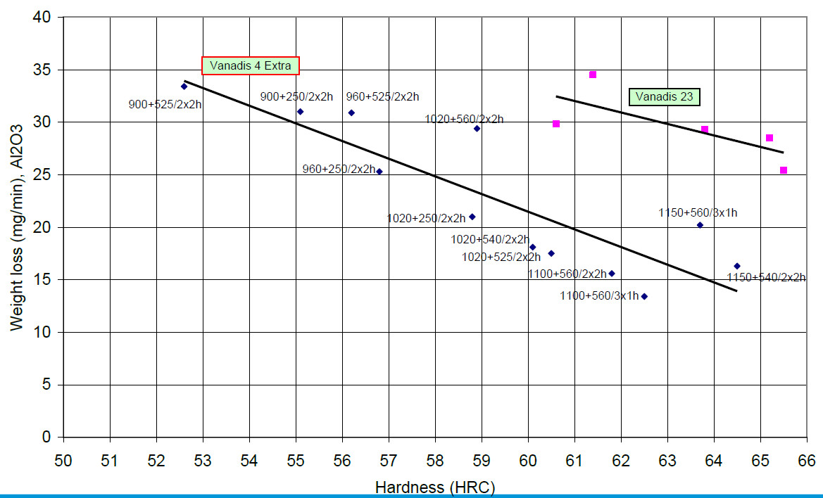

As mentioned previously, with M390 getting its good edge retention through high carbide volume rather than the hard vanadium carbides, ease in sharpening can be somewhat better than steels with comparable edge retention. This is true when using aluminum oxide abrasives, anyway. When sharpening with diamond or CBN stones there would be no benefit.

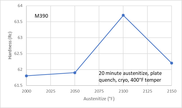

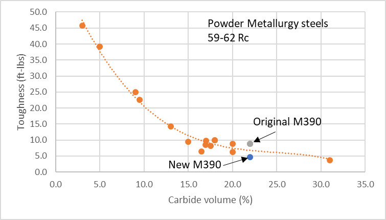

For a while I had a toughness chart which showed a relatively high value of about 8-9 ft-lbs for M390 at ~62 Rc in our toughness testing which put it close to steels like S35VN which have significantly less carbide and therefore would be expected to have superior toughness. This was somewhat puzzling behavior because I don’t know of anything about M390 in particular that would lead to higher than expected toughness for its given amount of carbide. However, I had a suspicion that the samples were heat treated at a temperature which was too high, leading to excess “retained austenite.” Excess retained austenite drops the hardness by a small amount but lowers the “yield strength” relative to the hardness, and also can transform to brittle, untempered martensite during use. Excess retained austenite also makes deburring in sharpening much more challenging. Therefore, even if a higher impact toughness value is measured I would not recommend heat treating the steel in that way. To see if I was right, I enlisted the help of Shawn Houston to heat treat some M390 for me because I was unable to obtain liquid nitrogen because of COVID-19. The previous specimens were heat treated at 2140°F, so we tested temperatures between 2000 and 2150°F:
The chart shows that M390 is capable of rather high hardness, particularly for its level of corrosion resistance. You can also see that there is a peak in hardness when austenitizing at 2100°F, which drops when raising the temperature up to 2150°F, which means that excess retained austenite is in the steel, despite the use of cryo after quenching. To confirm that it was excess retained austenite which was leading to the high toughness, I tested samples using 2100°F and tempered at 500°F. The higher tempering temperature was necessary to achieve a similar hardness to the original samples that were tempered at only 365°F. The toughness of the new specimens was significantly lower, and more in line with expectation based on the carbide content and relatively large carbides:
So when plotting all of the steels for toughness together you can see that M390 has relatively low toughness. This can be acceptable in knives as long as they do not have thin edge geometry and knives that are not subjected to high stresses or impacts.

  4. “The Bohler and Latrobe data show a similar result for M390 edge retention while my testing was somewhat lower. Despite the Bohler and Latrobe numbers seeming to confirm a higher result I believe the Knife Steel Nerds number is more reliable (I know, I’m biased).”
    From what I’ve seen in the datasheets currently available, Bohler uses secondary hardening with three tempers for the the marketing material for highest wear rates. Which would likely correlate with the 179 and the 180 in the chart and 61-62rc is obtainable with secondary hardening using cryo.
    1. My M390 was at the same hardness as Bohler-Uddeholm. They listed “61+” for hardness and mine was 61.5 Rc. I haven’t seen a difference between low and high tempering in edge retention when at similar hardness.
