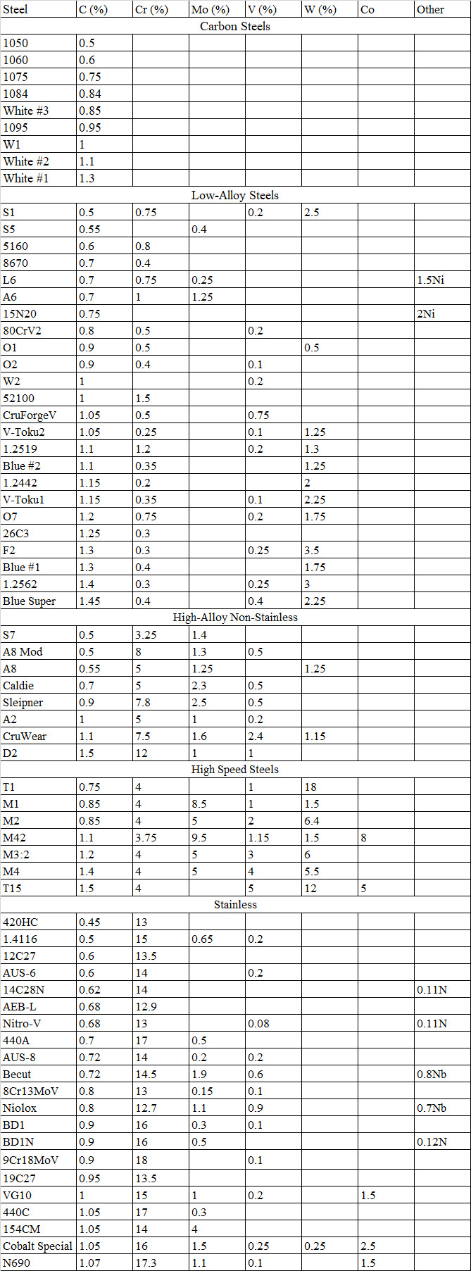

Steels to Consider
Here is a big table of steels so that you can see the compositions of many of the steels that will be discussed in this article. This chart has both too many and too few steels in it as I’m sure other steels will be brought up but I also have several steels listed that I will not be seriously considering. Some of these steels are available as either a PM or ingot version and I am of course only considering the less expensive ingot version. So CruWear is conventional CruWear not CPM CruWear.

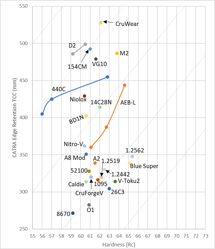

Toughness, slicing edge retention, and corrosion resistance are the primary properties we will be comparing. We have done some experimental work on these properties, which are summarized in the charts below. First is toughness, using our subsize unnotched specimens described here.
Edge retention comes from CATRA experiments which were explained in this article. I have also developed equations for predicting edge retention based on microstructure as described in this article. This will allow estimates for steels which haven’t been tested.

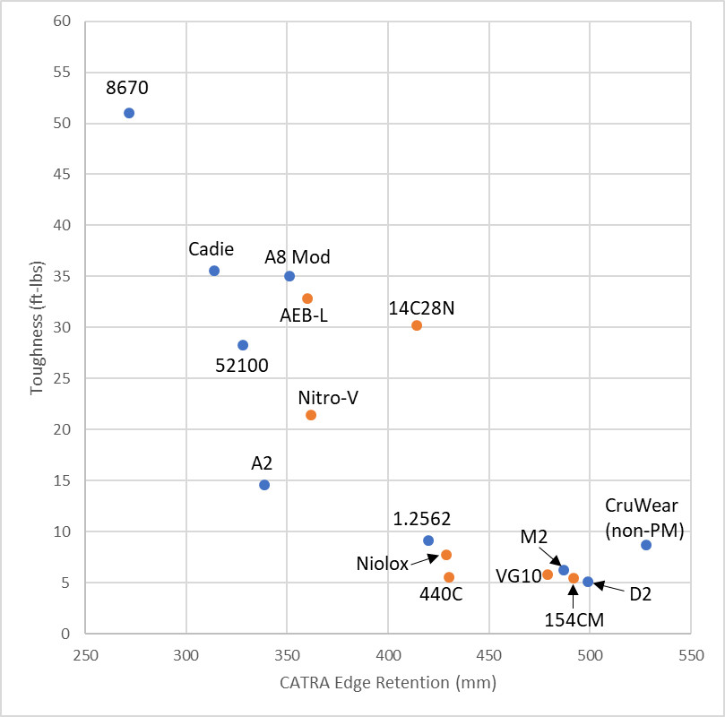

With forging bladesmiths they have a wider range of available steels but most of them have relatively low edge retention. The highest edge retention steels in this category are Blue Super and 1.2562. Blue Super is expensive to obtain outside of Japan and 1.2562 is difficult and expensive to obtain anywhere. There are some relatively inexpensive knives produced in Japan, particularly kitchen knives, that are made in Blue Super, however. These steels have somewhat higher edge retention than other low alloy steels but toughness is not particularly high. I discussed in the CATRA edge retention article that iron carbide didn’t seem to contribute to edge retention in cutting the silica paper. If we assume that this is a quirk of the test and that the cementite would show up in cutting other media, the edge retention of these steels would be more like 420 mm, rather than the 350 mm that was measured. Also in a recent article there were new tests by knifemaker Marco Guldimann where the toughness of 1.2562 was improved. However, even if we give the steels the benefit of the doubt and raise their toughness and edge retention scores based on those factors, it doesn’t push the steels to higher levels than the best of high alloy stainless and non-stainless steels in terms of toughness-edge retention balance, and the lack of corrosion resistance in these steels means I cannot name them the best budget steels.
You can have higher edge retention or you can have higher toughness but it is difficult to get both at the same time. So we want to identify steels that have the highest combination of both. There are several high toughness steels in the budget category because it is possible to design steels with low carbide content which improves toughness. With low carbide contents the carbides can be kept small even without powder metallurgy. However, these steels generally have low edge retention. But when conventional steels have significant amounts of carbide for higher edge retention those carbides tend to become pretty large leading to poor toughness. So we end up with steels with relatively high edge retention but the toughness is also pretty low. It is challenging to design steels which strike a balance in the middle somewhere. Powder metallurgy has allowed the development of more steels which achieve high edge retention with decent toughness or steels that strike a more middle-ground in terms of these properties.
The 1.2562 point used the modified values for toughness and edge retention I discussed before. It looks decent, being better than Niolox or 440C though not spectacular. 52100 also has a decent balance of properties for forging bladesmiths. You can see that 8670 has very low edge retention but also manages stellar toughness along with it. A steel like 5160 would be similar. Either of those choices are good for forging bladesmiths that need excellent toughness. 14C28N manages to have very high toughness along with medium edge retention. The most wear resistant steel we are looking at is CruWear which also manages okay toughness at around 9 ft-lbs.

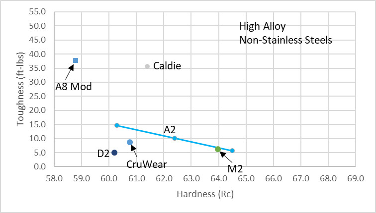

The ~8% Cr steels like A8Mod, Sleipner, and CruWear manage a pretty good balance of properties along with also having some corrosion resistance. I wrote about the history of these steels and their properties in this article. I haven’t tested Sleipner or similar steels but they would be expected to be somewhere in between A8 Mod and CruWear in terms of toughness and edge retention. So these are probably the best choices for non-stainless steels, in my opinion, though they aren’t particularly common in either production or custom knives.
High Speed Steels
High speed steels generally target high hardness, wear resistance, and “hot hardness” without much focus on toughness. M2 is probably the most balanced of the various conventional high speed steels, with good toughness and relatively high wear resistance. I have only tested the toughness of M2 at high hardness though perhaps in the 60-62 Rc range it could do a bit better for different applications. High speed steels are a decent place to look for very high wear resistance conventionally produced steels, as steels like M4 or T15 have been available without PM processing, though non-PM T15 is probably rare at this point. Those steels have 4-5% vanadium giving them excellent edge retention.

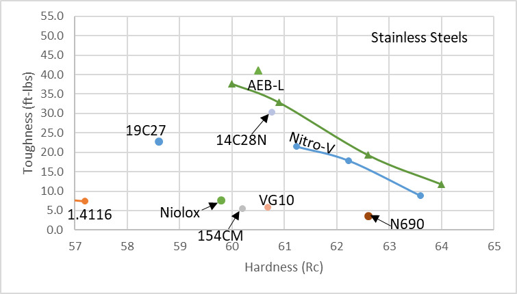

Stainless Steels
Steels like AEB-L or 14C28N manage to have excellent toughness while also being capable of 60+ Rc. The toughness is similar to steels with lower carbon content like 420HC but with higher potential hardness. AEB-L and 14C28N also have moderate edge retention though of course much lower than vanadium-alloyed powder metallurgy steels like S30V or M390. 14C28N is essentially AEB-L (or perhaps more accurately Sandvik 13C26), but with improved corrosion resistance. Despite the improved corrosion resistance, it is still capable of similar hardness (above 62 with cryo), and in CATRA testing it even had slightly improved edge retention. Going any higher in carbon or edge retention means a very large drop in toughness such as Niolox, VG10, or 154CM. There are other steels I didn’t test like AUS-6, AUS-8, or 8Cr13Mov, but those steels are unlikely to have a better combination of properties than 14C28N. So 14C28N has the best balance of the stainless steels in my opinion.

So after reviewing many of these steels I think 14C28N is the best. It has high toughness, above average corrosion resistance, and decent edge retention. It is also “fine blankable” and easy to sharpen with any stones, which were mentioned as bonus categories at the top of the article. The steel also has high “grindability” and “polishability” which makes costs low for knife manufacturers or custom knifemakers. As mentioned in the heat treating section, the hardenability is not particularly high for a stainless so heat treating in large vacuum furnaces is somewhat more difficult but certainly not impossible. Availability of 14C28N is somewhat worse than AEB-L so AEB-L can be a replacement with somewhat lower corrosion resistance when 14C28N is not available in the right size. I think these steels are appropriate for either knife manufacturers or custom makers so I don’t think there’s much reason to differentiate in that respect. The only exception is forging bladesmiths who tend to prefer low alloy steels and to them I would recommend 52100 for its good combination of toughness, edge retention, availability, and ease in grinding and polishing. For custom knifemakers I have a separate article on how to pick steels.
