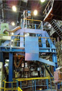

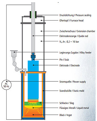

One of the major reasons nitrogen isn’t used more often is because the nitrogen gas is not very soluble in liquid steel. It tends to bubble out when attempting to add it to steel. So with conventional steel production the nitrogen is often limited to the 0.08-0.12% range. Maybe enough to make a difference but not enough to replace much of the carbon in a knife steel needing to be 60+ Rc. One approach to increasing the amount of nitrogen is to produce the steel under high pressure. In the late 1980s Vereinigte Schmiedewerke of Krupp-Kloeckner-Thyssen (VSG) built a pressurized electroslag remelting furnace (PESR) which was capable of having pressure up to 40 bar with a capacity of 20 tons [1]. In the early 1990s they used this technology was used by researchers at Rurh-Universitat Bochum and FAG Bearing Co. VSG to develop high hardness bearing stainless steels [2][3].
Images of PESR from [4]

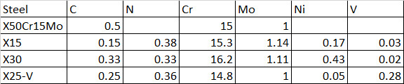

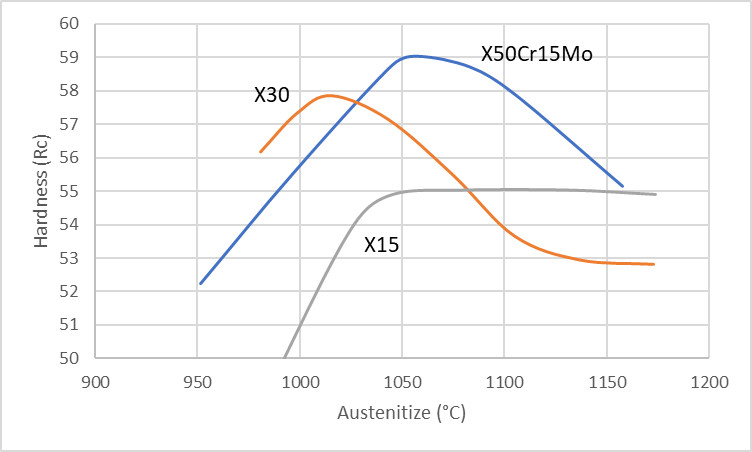

The 40 bar pressure limited them to about 0.4% nitrogen, which is not enough to reach hardness of 58 Rc and above. So instead they experimented with different combinations of carbon and nitrogen to achieve the desired hardness levels. These were produced in a 100kg laboratory furnace which was also capable of 40 bar pressure for increased nitrogen. They used a basis of 15% Cr and 1% Mo, using 1.4116/X50Cr15Mo as their base steel to replace carbon with nitrogen.
Through these test heats they found that more carbon was better for higher hardness, with the “X30” composition reaching similar hardness levels to the X50Cr15Mo. This resulted in a similar composition to what would be named Cronidur 30. However, they also tested a composition with increased vanadium. The vanadium addition was to help with hardness when tempered in the high temperature regime (secondary hardening). This grade does not seem to have been pursued, however.

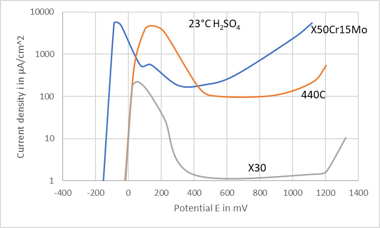

Corrosion testing found greatly improved corrosion resistance when compared with X50Cr15Mo and 440C due to the replacement of carbon with nitrogen, putting nitrogen in solution and also leaving more chromium in solution as opposed to forming chromium carbides. This is shown in a current density-potential curve in sulfuric acid below. The “X30” steel had a significant drop in passive current density, and an increase in breakthrough potential, which demonstrates an improvement in corrosion resistance.

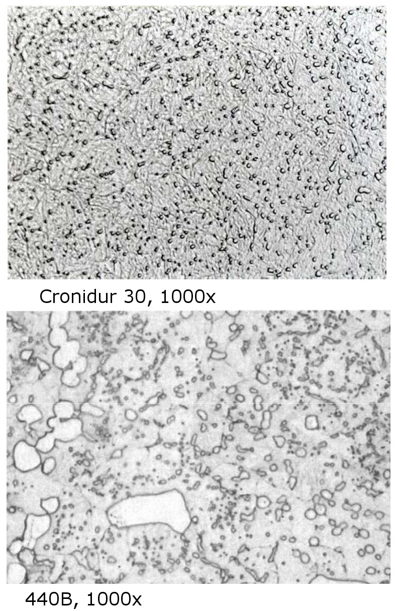

They also found that the reduction in chromium carbide vs other martensitic stainless steels like X50Cr15Mo and 440C led to improved toughness because the carbide size was greatly reduced and the overall volume of carbide/nitride is lower than in those martensitic stainless steels.

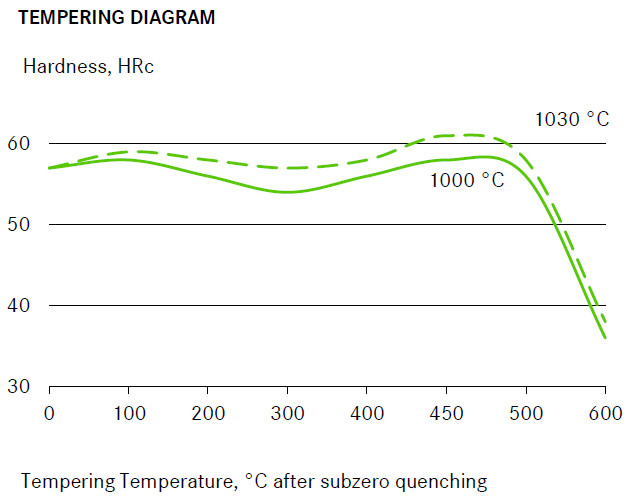

Below is the tempering chart from the Zapp LC200N datasheet [6]:
Those hardness values are roughly equal to those that we have found in our experiments of the steel. These were heat treated either by myself (CATRA) or Warren Krywko (toughness coupons). A summary of the heat treatments we have done are shown in the table below:
It seems that the hardness of the steel tops out around 60 Rc. It may be possible to optimize the heat treatment parameters and achieve 61 Rc or so but using the relatively safe 1900°F austenitize leads to about 59-60 Rc.

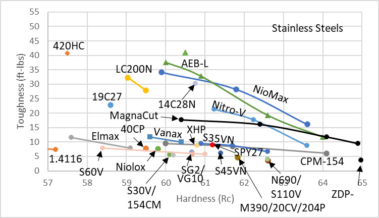

As was previewed in the microstructure section, the toughness of Z-Finit/LC200N/Cronidur 30 is excellent, similar to AEB-L and 14C28N. The fine carbide/nitride structure and the low volume of those particles gives it very high toughness.

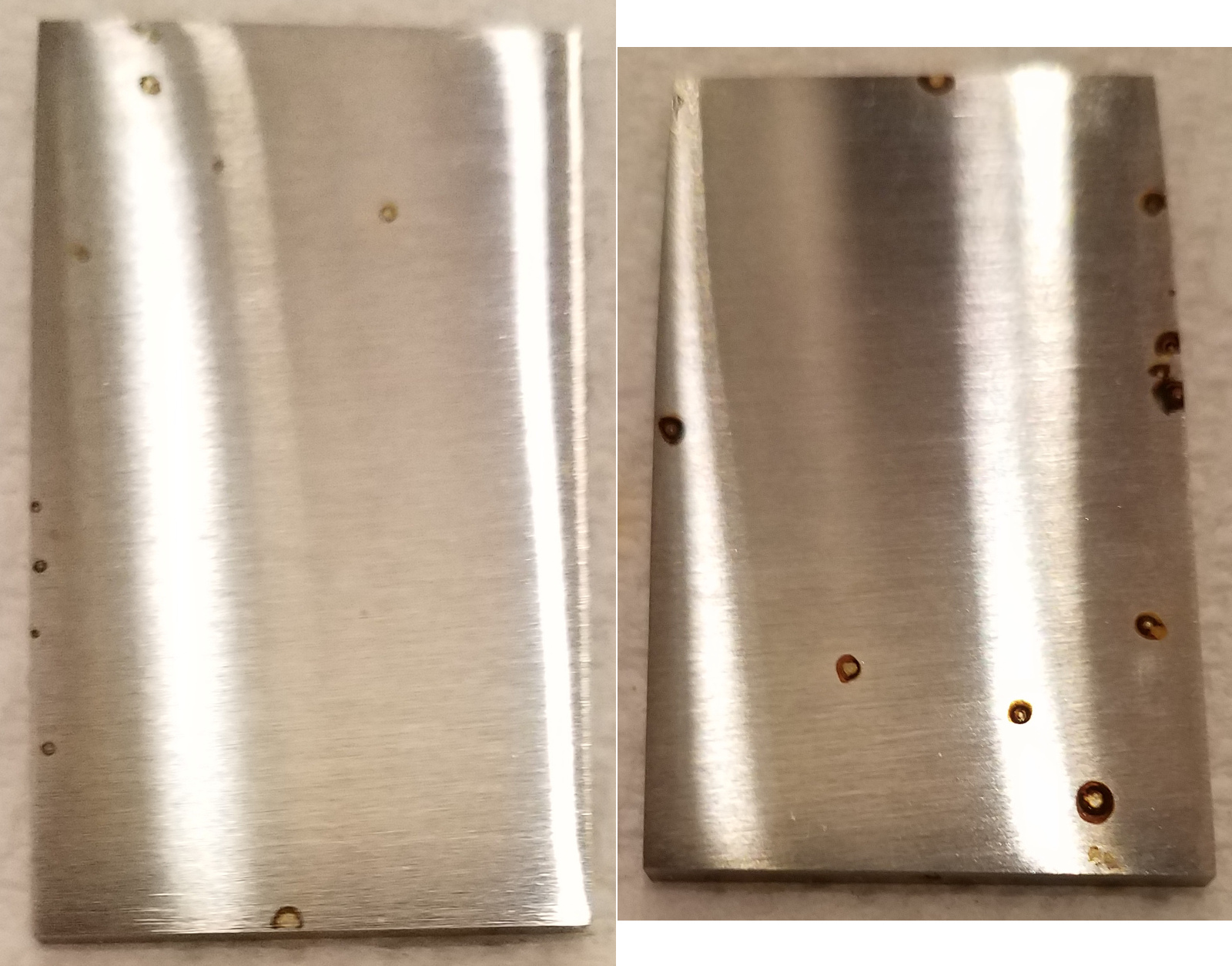

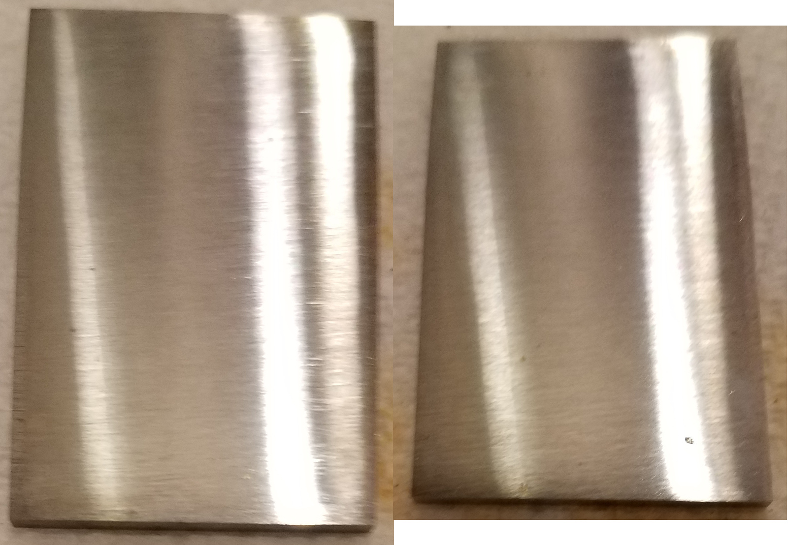

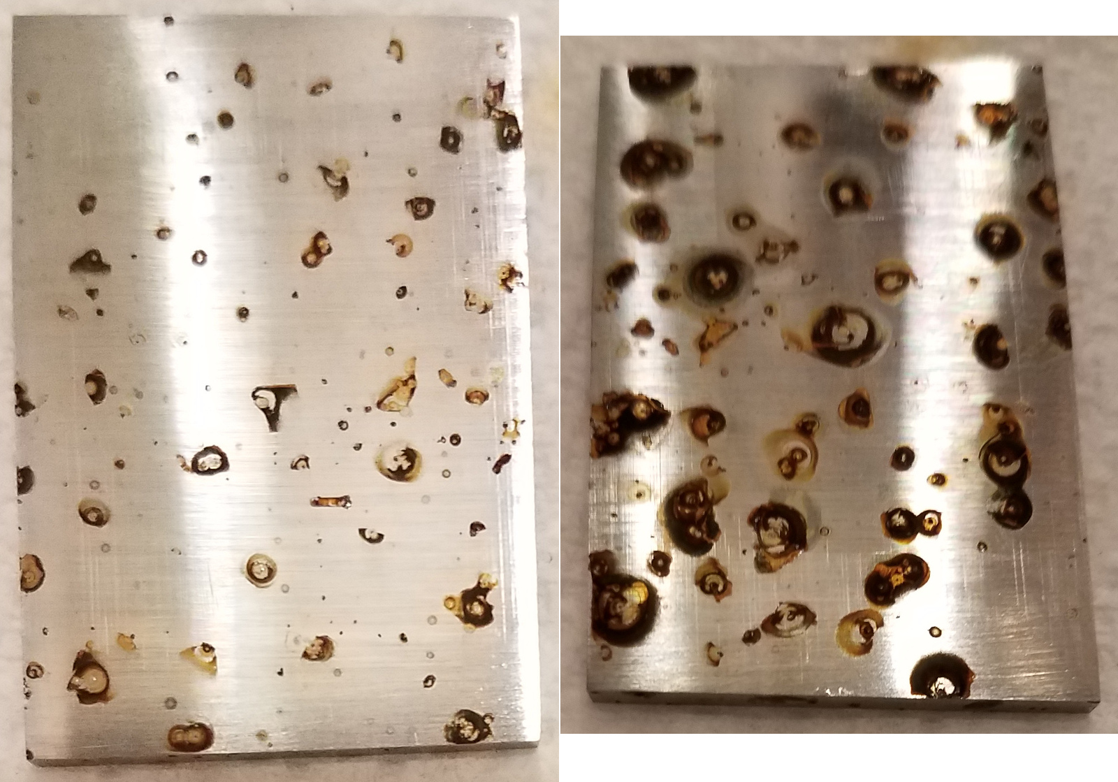

I have tested LC200N with my standard 1% saltwater test and also the more difficult 3.5% saltwater test, and in both cases I found no rust spots on the steel. This puts it at the top of the charts for corrosion resistance of knife steels, along with other high corrosion resistance grade Vanax. This is better corrosion resistance to AEB-L and 14C28N which I have been comparing it to above. In the images below 24 hours of saltwater spray is on the left and 48 hours on the right, for the 1% saltwater test.
