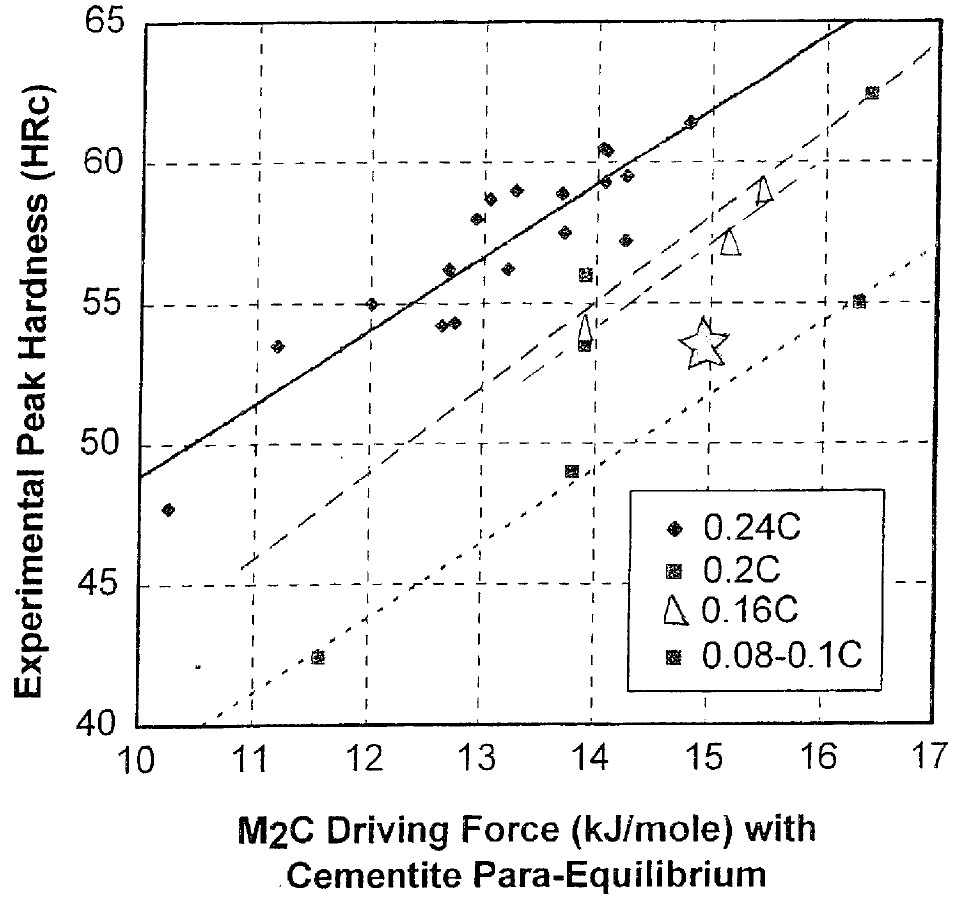

Design of S-Series Steels
So the S-series of steels were designed to be a stainless PH steel which could achieve relatively high hardness while avoiding excess retained austenite. This is somewhat difficult to do with high nickel, chromium, and carbon, though is helped somewhat by the cobalt addition. So the Ferrium S53 grade can reach about 53-54 Rc along with good corrosion resistance through careful composition control by minimizing the required carbon, chromium, and nickel necessary for achieving the hardness and corrosion resistance targets. Another interesting point brought up in the patent is the claim that the high cobalt helps “partition” the chromium to the surface to form the chromium oxide film for corrosion resistance. This effectively improves corrosion resistance for a given amount of chromium. It is an interesting claim in part because cobalt is rarely added to stainless steels, and also because I have read another study that found a reduction in corrosion resistance from cobalt [6]. Read more about how corrosion resistance in stainless steel works in this article. Ferrium S53 and M60S also have a small vanadium addition which can form small VC carbides to contribute to precipitation strengthening as well. And VC can help pin grain boundaries for a small grain size.
