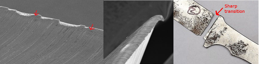

Failure Modes
A common engineering technique is to evaluate designs based on how they failed, or may fail. Failure modes are identified and the designs are modified to prevent those failures. These ideas are simple in concept but it is surprising how easy it can be to miss the forest for the trees. In terms of predicting failure modes in some cases it is easy and in some it is difficult. You would expect a large chopping knife to require heavier edge geometry to prevent chipping and rolling, or a seawater diving knife to require high rust resistance. Other times failure modes are identified through testing of the knife or by returns from customers. Whatever the source of the failure, there are usually relatively simple methods for fixing each one, though the trade-offs for doing so may not be desirable.

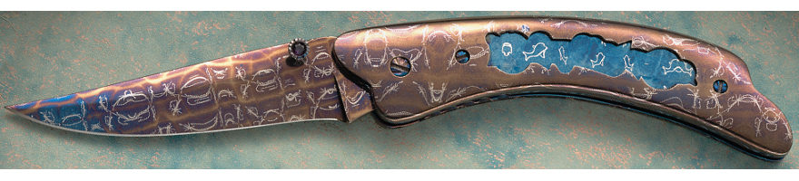

Legendary Heat Treatments
Last week I wrote about What a Good Heat Treatment Can and Cannot Do, and as part of that topic I wrote about how some knifemakers have a legendary or even mythical reputation for their heat treatments. In that article I argued that the big differences are between “bad” and “good” heat treatments, and that the differences between various good heat treatments are much smaller. And that edge geometry and knife design are more important to knife performance than the differences that are possible between different “good” heat treatments. So I think it makes sense to discuss a particular case of a knifemaker known for legendary, unmatched heat treatments, which brings me to…
