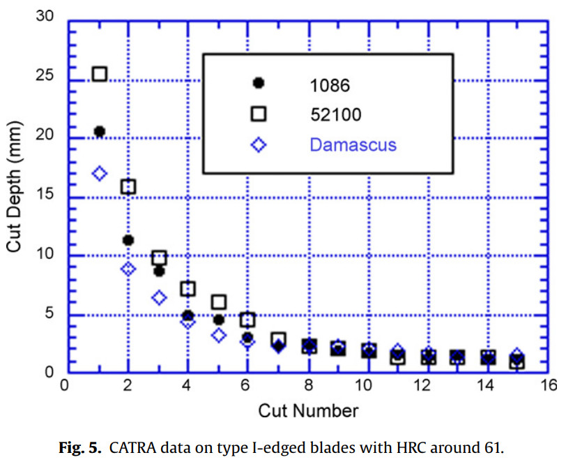

I’m not sure where in the test the average person would decide that the knife needs to be resharpened, but I would guess that it is before cut 60 because the CATRA test wears the edge pretty significantly. In CATRA tests performed by Verhoeven [1] the edge radius was reduced from ~0.5 micron all the way to 3-5 microns after only the second cycle (note he calls the cycles strokes):
The tests performed by Verhoeven were with low wear resistance steels (AEB-L, 52100, 1086, and Wootz) but it still shows the relatively significant wear that occurs with the CATRA test. In the CATRA article on 154CM, it was found that the edge width (rather than radius measured by Verhoeven) was increased to 23 microns with a 20° edge angle and the 50° edge to 17 microns, which is quite dull. A ten micron edge width has been reported previously as a dull edge that needs sharpening [2].

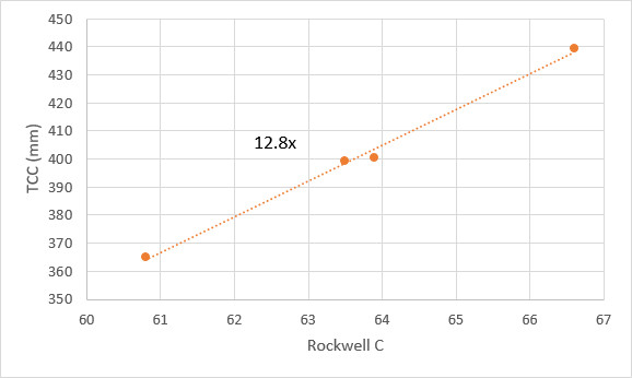

Steel Hardness
The coefficient for hardness of 15.8 means that the regression predicts an increase in ~16 mm TCC for each point of hardness (Rockwell C). If this holds true across all steel types (perhaps a big if) that would mean that low wear resistance steels would get more of an increase percentage-wise than a high wear resistance steel. In other words, an increase from 200 to 232 TCC with a 2 Rc increase is more significant than from 800 to 832. There were some cases due to test variability where there wasn’t much difference in TCC with hardness. Here are a couple examples with clear trends:
There aren’t enough significant hardness comparisons in the data to say much else definitively. I would imagine that the improvement in TCC with increase in hardness would be greater with low edge angles since there is a larger spread of values among steel types with low edge angles. But quantifying that is difficult with the current dataset. The increase of 15.8 mm per Rc is also within range of another independent study performed with CPM-M4 [5]. Ignoring one potential outlier, the increase with hardness was 12.8 mm per Rc.
The CATRA test uses a fixed load and has little lateral stress on the edges of the knives. In “normal” cutting by humans there are larger stresses on the edges which can lead to edge rolling or chipping, especially with thin and low angle edges. Those effects are largely not seen with CATRA and therefore this measured effect of hardness is largely due to an increase in wear resistance. In cutting by humans or in cutting of hard materials there may be a stronger effect of hardness due to other mechanisms like edge rolling.

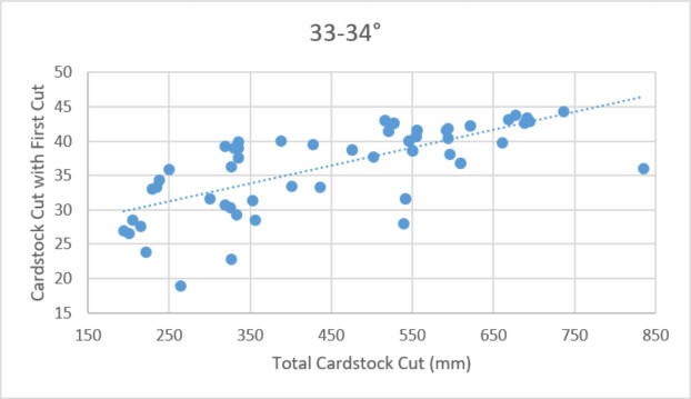

Wear in Cut One
When plotting TCC vs the amount of cardstock cut in the first cut you get a convincing trend, meaning the length of card stock in cut one is a strong predictor of the TCC after all 60 cuts. This indicates that the initial wear of high edge retention steels is less than low edge retention steels.
As described earlier in conjunction with the Verhoeven study and edge micrographs, the CATRA test wears the edge quite rapidly. In fact, the effect of edge wear shows up in the result of the first cut. In other words, high wear resistance steels cut more cardstock in the first cut than low wear resistance steels. This is somewhat surprising as I would expect the wear to show up in cut two after the edge passes over the cardstock not during the cut. If this was only on a few isolated tests I would think that this unusual behavior was due to inconsistency in sharpening. However, it is seen consistently across the dataset here as shown in the plot above, and was also seen in our test comparing AEB-L, 154CM, and AEB-L/154CM damascus and in the Verhoeven study on 52100, 1086, and wootz Damascus [1]:
So to investigate this mysterious behavior I re-watched the CATRA test videos some more to figure out what is going on. I have observed CATRA tests personally but only a few of them and it has been a few years. I watched the video at the top of the article and counted 68 cuts and the display only showed 34 “cycles.” So I realized that the 60 “cycles” are actually both a forward and backward motion. Therefore the reason that steels with higher wear resistance have higher cutting ability in cut number one is because the edge is worn in the first “stroke” then it cuts again in the second stroke in the opposite direction, and the reported cardstock cut per cycle is from both strokes. I think it is a mistake that the CATRA tester does not report each stroke as that would provide a more complete picture of the wear behavior.

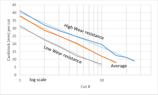

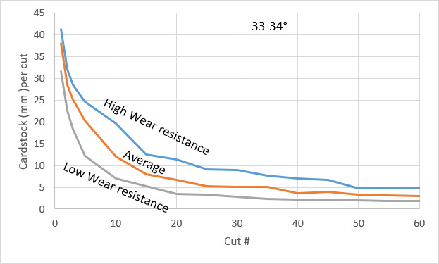

Cutting Ability Loss During Testing
Interestingly the change in cutting ability after the first cut with different levels of wear resistance is very similar. In other words, the primary difference in wear resistance is seen in the first cut rather than future cuts. I have shown averaged CATRA curves for high, medium, and low wear resistance steels with the same edge angle (33-34°). Using averages from several tests removes some of the noise from the tests and makes comparisons easier. The high wear resistance curve is 676 mm TCC, average is 474 mm TCC, and low wear resistance is 284 mm TCC. Below that I plotted the CATRA data on a logarithmic scale instead where it is apparent that the slope is similar regardless of the relative wear resistance of the steel:
Those averaged curves makes it easy to see how wear resistance affects the wear of the edge. The biggest difference is in the first cut; more wear resistant steels lose less cutting ability in the first stroke (half-cycle). From then on the reduction in sharpness is very similar between steels, each is in a “steady state” period. The reduction in sharpness per cut decreases as the test continues which is why the behavior appears linear on a log plot. Therefore the most significant wear of the edge occurs during the first cuts.

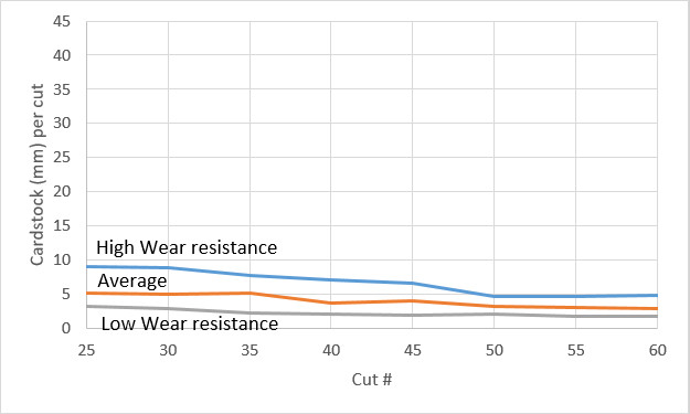

After the steady state period the edges reach a “leveling off” period where the edge loses sharpness more slowly. The number of cuts necessary to reach this point is higher with greater wear resistance. While the slope of the “steady state” edge loss period is similar for all three wear resistance levels, the level of sharpness where the edge wears more slowly is different. The higher wear resistance steels maintain higher sharpness during the slow sharpness loss period. Perhaps this is why high wear resistance steels are known for holding a lousy edge for a long time. It may be that the larger amount of carbide means that the high wear resistance steels are able to maintain somewhat sharper edges.
Therefore we have three periods of sharpness loss in the CATRA test:
  1. Cut number one where lower sharpness is seen with low wear resistance steels due to the “cycle” including both a forward and backward stroke. High wear resistance steels lose much less sharpness in the first half-cycle.
  2. Steady state sharpness loss which is similar regardless of the level of wear resistance
  3. Slow sharpness loss after the edges reach a relatively low level of cutting ability. Higher wear resistance steels maintain a higher cutting ability during this period.

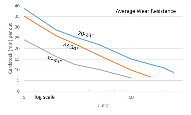

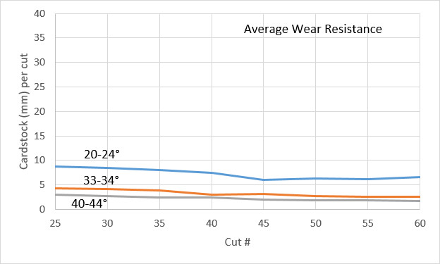

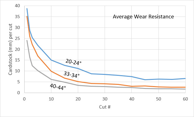

Constant Wear Resistance with Different Edge Angle
I also looked at different edge angles each with “average” wear resistance resulting in different TCC values. The average TCC values are 643 mm for 20-24°, 395 mm for 33-34°, and 243 mm for 40-44°. The comparison overall looks similar to when looking at different wear resistance levels with the same angle:
In this case it is not wear resistance but the superior cutting ability of a lower angle edge that leads to the higher value for the first cut. The steady state period is also, surprisingly, similar regardless of the edge angle. The cutting ability in the slow sharpness loss period also correlates with edge angle, where a more acute edge is at a higher cutting ability. Based on the micrographs of the 154CM edges it appears that the sharpness may be higher for the more obtuse edge (edge width is narrower) but the overall cutting ability is higher for the more acute edges (based on cardstock per cycle).

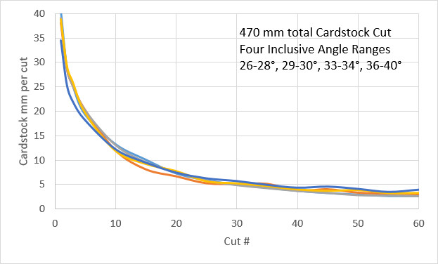

Constant Edge Retention with Different Edge Angles
To some extent it is possible to match the TCC of a high wear resistance steel by using a lower wear resistance steel with a more acute angle. I was curious how the cutting ability loss CATRA curves compare when maintaining the same TCC with different edge angles. This means that the more obtuse edge angle curves are averages of higher wear resistance steels, and more acute edge angles are from low wear resistance steels:
The curves are largely the same regardless of the edge angle, with perhaps the 36-40° having a slightly lower value for the first cut. The slightly different behavior of the 36-40° edges may just be because of the smaller amount of data available in that edge angle range because very high wear resistance steels are required to match the same TCC values. The very similar curves of different edge angles with the same TCC is somewhat surprising because we would expect progressively lower cutting ability with more obtuse edges. Also, the more acute edge angles have to reach a lower level of sharpness to have a similar level of overall cutting ability. If I had guessed beforehand I would think that a more obtuse edge would start out with lower cutting ability but then maintain a higher cutting ability with extended cutting. However, because initial sharpness loss is seen even in cycle number one, the initial cycle is very similar. That is followed by the steady state period where all steels are the same, and each then ended up with a similar level of cutting ability in the slow sharpness loss period.

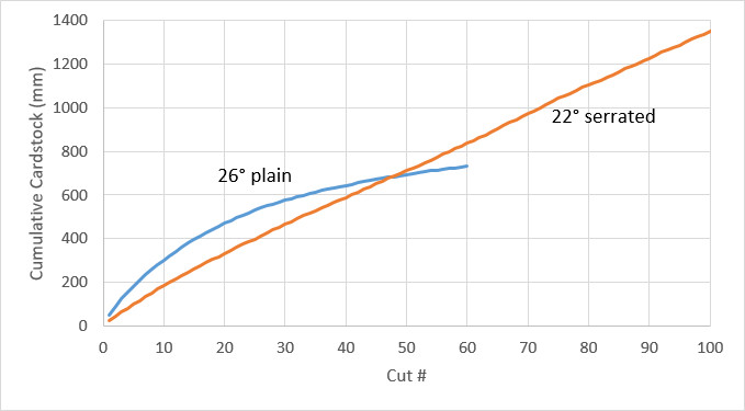

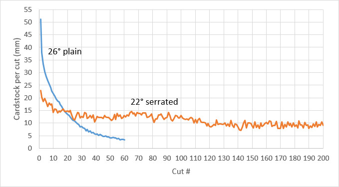

Serrated Edges
There were also a few comparisons between a serrated and a “plain” or non-serrated edge. The serrated edges are typically at lower edge angles to improve their cutting ability relative to plain edges. The serrations mean the edge wears much more slowly than plain edges; the CATRA test is often performed with 200 cuts rather than the standard 60 because the edge wear is so much slower. The initial cutting ability of a serrated edge is significantly lower than a plain edge but after a sufficient number of cuts the serrated edge keeps going while the plain edge has dulled. Below I have a comparison with the same steel, one with a plain edge at 26° and the serrated with a 22° edge angle.
There is a crossover in cutting ability at about 18 cuts, while the total cardstock cut crossed over at about 47 cuts. After the 60 cut standard test the plain edge cut 732 mm TCC and the serrated edge got 837 TCC. However, the plain edge comparison here is more obtuse (26 vs 22°) so it is not a perfect 1:1 comparison. I suspect that if both were at 22° that the TCC at 60 cuts would be similar. Using our regression equation, 732 + 17.8*(26-22) = 803 TCC which is close to the 837 TCC of the serrated knife. The cutting ability of the plain edge would likely still reach a point lower than the serrated edge at some point in the test. It is impressive how little wear the serrated edge saw between cuts 120 and 200; it is essentially flat. If a user is willing to accept a moderately low cutting ability along with the more saw-like cutting of a serrated edge the blade will keep cutting for much longer than a plain edge.

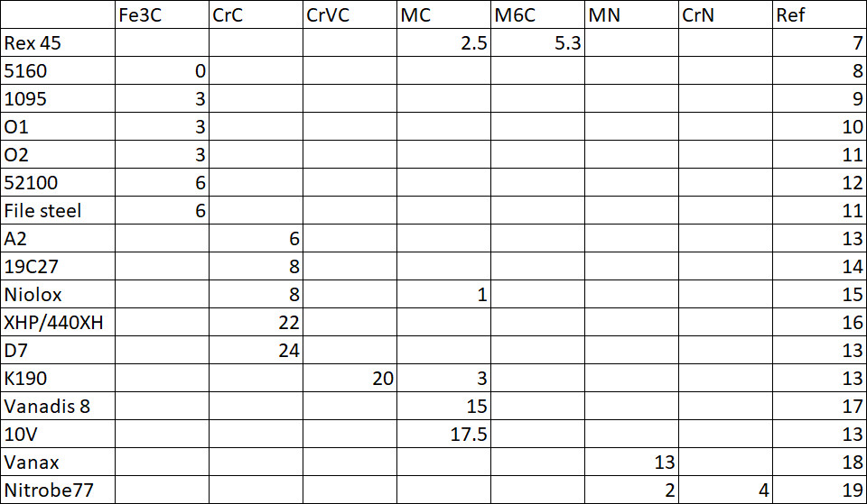

Bonus Carbide Fraction Values
TCC (mm) = -157 + 15.8*Hardness (Rc) – 17.8*EdgeAngle(°) + 11.2*CrC(%) + 14.6*CrVC(%) + 26.2*MC(%) + 9.5*M6C(%) + 20.9*MN(%) + 19.4*CrN(%)
Here are some carbide fractions for other steels not present in Part 1 because they were not tested in the analyzed dataset (other than XHP which I found after publishing Part 1). This allows an estimation of relative edge retention of different steels, hardness levels, and edge angles. The file steel listed is a 1.45%C steel with 0.35% Cr. Some steels I have good guesses or Thermodynamic calculations for carbide volume but I am restricting this to experimentally reported values. S110V is reported to have 21.7% carbide volume in its patent but the breakdown between CrVC and MC was not given so it is not in the table. Many steels are sold under different names like Rex 45 being sold as Hitachi HAP40 or Erasteel 2030. To estimate the TCC of the carbon steels with cementite (Fe3C) use a coefficient of 5 though that has not been experimentally verified. If you find any other reported carbide numbers send them my way.
