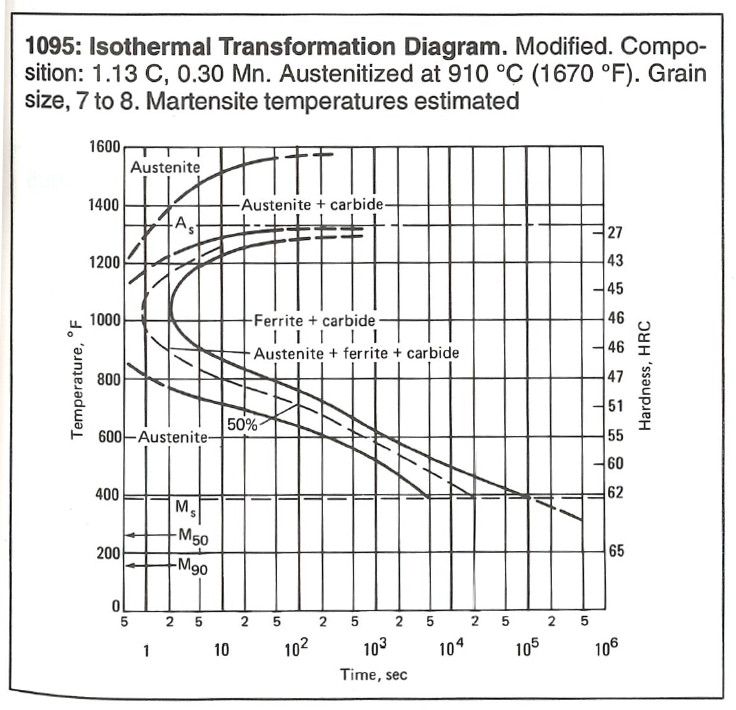

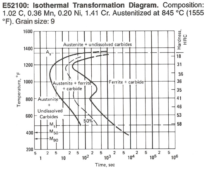

One purpose of the Cr addition is for “hardenability,” a measure of how fast steel must be quenched from high temperature to achieve full hardness. A simple carbon steel such as 1095 requires a very fast water quench to fully harden, where a hard steel phase called martensite is formed. 1095 has nearly 1% carbon like 52100 but without the chromium addition. If quenched in slow oil or allowed to air cool, then some amount of “pearlite” forms which reduces the hardness of steel relative to full martensite. Pearlite is a combination of 0.02 wt% carbon ferrite and 6.67 wt% carbon cementite (Fe3C) that forms in alternating bands, so with a simple carbon steel the carbon must diffuse over a short distance for the bands of ferrite and cementite to form. Chromium is also enriched in the cementite, so in a chromium-alloyed steel the chromium must also diffuse into the cementite to form pearlite. Chromium is a much larger atom than carbon so it diffuses more slowly. Therefore with a chromium addition pearlite formation is suppressed and hardenability is increased.
This hardenability effect can be seen with a Time-Temperature-Transformation (TTT), also called Isothermal Transformation (IT) graph where the “nose” of the transformation (labeled as ferrite+carbide) is pushed to longer times in 52100 relative to 1095. This allows bearings to be fully hardened so that they have sufficient strength and therefore resist deformation during use. The core of a bearing cools slower than the surface during quenching, so the higher hardenability allows larger bearings to be used. 52100 is still not a high hardenability steel, however, and is not considered a true “oil hardening” steel like O1 (as opposed to water hardening). For large bearings requiring higher hardenability, modified versions of 52100 were developed. A higher Mn version was introduced in the mid-1930s, and a Mo-alloyed version after WWII [7]. However, neither of those versions have seen significant use in knives.
The “nose” of the curve in the TTT for 1095 actually extends off the chart because the time is so short. Very fast quenching is required to avoid soft pearlite
The “nose” of the 52100 TTT is at about 3 seconds, allowing less severe quenching to achieve full hardness

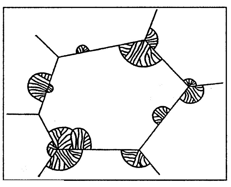

Effect of Chromium on Carbide Size
Carbides are hard particles in steel that improve wear resistance but reduce toughness or resistance to cracking. Therefore, greater amounts of carbides are desirable for applications that require high wear resistance. Applications requiring high toughness usually need the carbides to be as small as possible and to have a small volume fraction of them. A typical high carbon steel like 1095 forms hard particles of iron carbides called cementite, with three iron atoms for every carbon atom: Fe3C. High chromium steels form a chromium carbide such as Cr7C3 or Cr23C6. Some erroneously believe that 52100 forms one of those chromium carbide types. However, it does not have sufficient chromium to form those types of carbides. Some of the chromium is instead enriched in the cementite, forming M3C where M can refer to either iron or chromium. The cementite in 52100 contains about 9 wt% chromium [8].

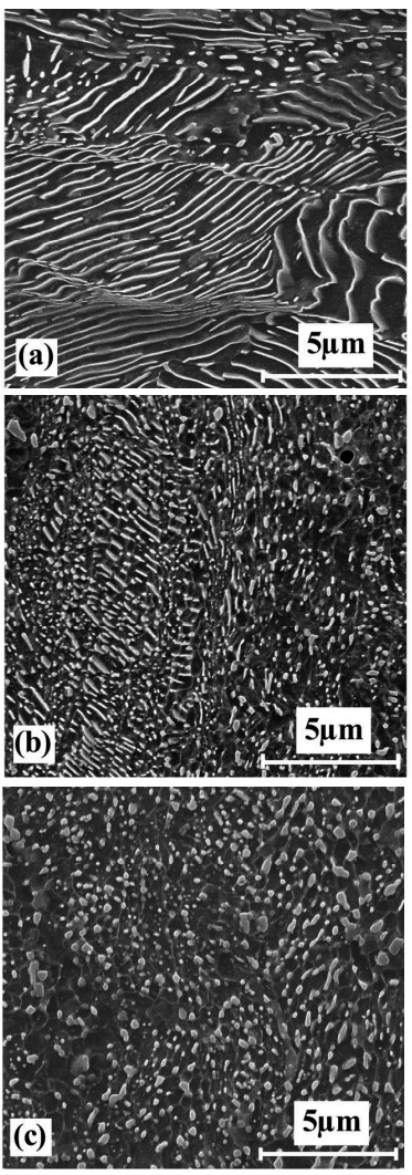

The addition of Cr helps to reduce the carbide size. Smaller carbides means better toughness and resistance to fracture. 52100 is known for its very small carbide size and high density of carbides, even when compared to other carbon and alloy steels like 1095. The carbide size is reduced by a similar mechanism to the increase in hardenability. Prior to delivering steel to the end customer, the steel is annealed to be soft for machining and to set it up for final heat treating. One method for annealing is to slow cool the steel from high temperature to form pearlite, followed by an intermediate temperature treatment where the pearlite structure is “spheroidized” to form small round carbides [9]:

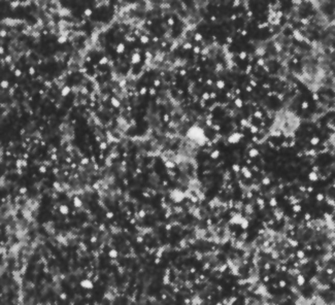

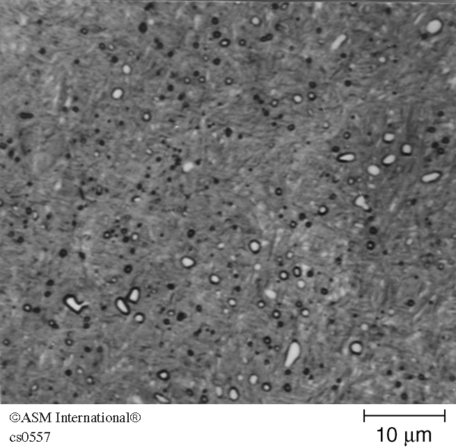

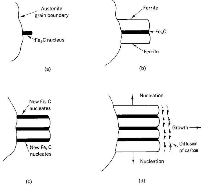

Because Cr is part of the carbides which diffuses more slowly than carbon, the spacing between cementite in pearlite is smaller, and then the rate of “spheroidization” and growth of the round carbides is reduced. Here are images [10] comparing 52100 (top) with 1095 (bottom), where the white particles are carbides. The 1095 is quite fine, but the 52100 has a greater density of carbides and the maximum carbide size is smaller than 1095.
52100
1095

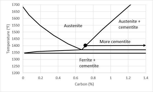

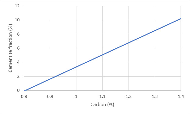

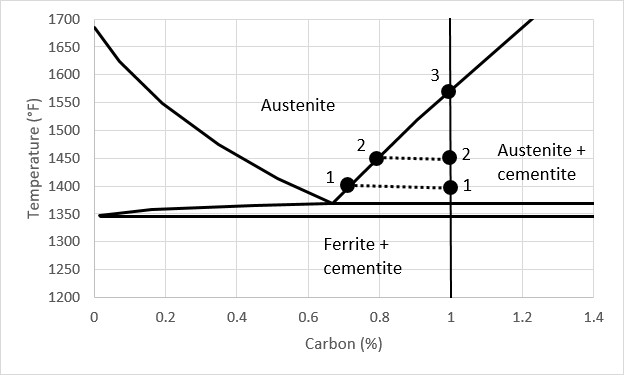

When comparing steels at the same high hardening temperature but with increasing carbon content, the amount of carbon in solution remains constant but the amount of carbide increases. You can see that by looking at the iron-carbon phase diagram below; the black circle on the line represents the carbon in solution which does not change with increasing carbon content. However, with higher carbon the line extends further into the “austenite + cementite” field indicating that more cementite is present.
The phase diagram represents the microstructure of steel at different carbon contents and temperatures. At a temperature of 1400°F, at a carbon content between about 0.55-0.7% the steel is in the “austenite” region where no carbides/cementite is present. If quenched from that temperature the final microstructure is hard martensite without carbides. If the carbon content is increased above 0.7% then carbides are present at the high temperature, resulting in a final microstructure of martensite with carbides. The carbides contribute to wear resistance. The more carbon is added above 0.7% the higher the amount of carbide is present:
The amount of carbon “in solution” to contribute to hardness remains the same at a fixed temperature despite the increasing bulk carbon content, because the carbon is contributing to carbide formation. However, if the temperature is increased then the carbon in solution goes up along the line. If we look at a 1% carbon steel at 1400°F (point 1) there is the same 0.7% carbon in solution as a steel with any other steel with carbon greater than 0.7%. Dotted lines show the carbon in solution vs the bulk composition of the steel. At 1450°F there is 0.8% carbon (point 2), and 1% carbon in solution at about 1570°F (point 3). The length of the dotted line shortens with increasing temperature indicating that the amount of carbide is decreasing, until point 3 where no more carbide is present and it has reached the “austenite” field:
The addition of 1.5% Cr shifts the position of the iron-carbon phase diagram, to higher temperatures and lower carbon contents:
The shift in the phase diagram means that for the same bulk carbon content, there is less carbon in solution and a greater volume fraction of carbide. This is why the recommended hardening/austenitizing temperatures of 52100 is higher than 1095, usually 1550°F rather than 1475°F. The reduction in carbon in solution vs 1095 helps improve toughness, as carbon above about 0.6% in solution leads to plate martensite which reduces toughness. Experimentally, 52100 has about 0.63% carbon in solution with a hardening treatment from 1550°F [11] which provides maximum hardness without forming plate martensite. Lower hardening temperatures further reduce the carbon in solution for better toughness. You can read more in this article about the hardness of steel. The increase in carbide fraction also improves the wear resistance of 52100, where heat treated 52100 has around 6-10% carbide volume [12], and 1095 has approximately half that.

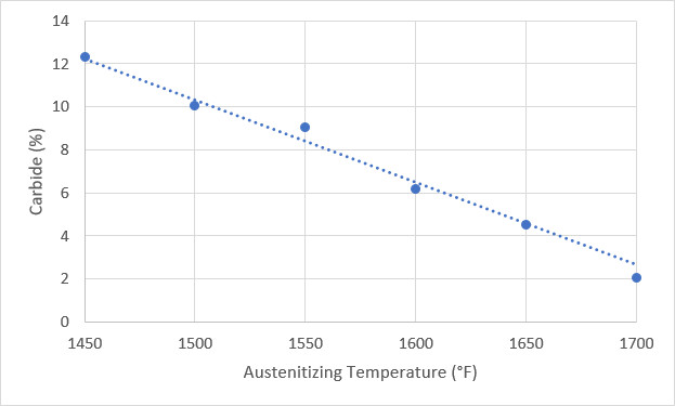

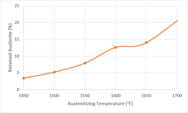

As discussed above, increasing the hardening/austenitizing temperature of 52100 leads to an increase in carbon in solution and a decrease in carbide fraction. That is seen experimentally as well, though numbers are somewhat different than those predicted by the phase diagrams, as those predictions are for an infinite hold time at temperature, as opposed to the 10-30 minutes used in heat treating. As the carbon in solution increases, the amount of retained austenite after quenching also increases. You can read about why in this article about cryogenic processing of steel. The peak in hardness comes from an austenitizing temperature of about 1650°F; above that excessive retained austenite forms which reduces hardness. Here is retained austenite and carbide volume vs austenitizing temperature [8]:

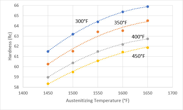

With lower tempering temperatures and higher austenitizing temperatures, hardness is increased. Using 1650°F and 300°F results in approximately 66 Rc [8], though that condition likely also leads to relatively low toughness. A typical heat treatment of 1550°F austenitizing and 400°F tempering results in about 61.5 Rc. Many knifemakers use 1475°F and 400°F, which would lead to about 59.5 Rc. I’m not exactly sure why they use 1475°F, perhaps it comes from copying recommended heat treatments from 1095. Knifemakers, like many other people, like round numbers, so an austenitizing temperature that leads to the round number of 60 Rc after a nice round number temper of 400°F is probably appealing.

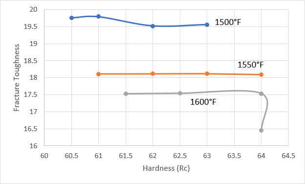

Using lower austenitizing temperatures can lead to improved toughness, which you can read about in this article on austentiizing. Typically, it is better to reduce both the austenitizing temperature and the tempering temperature, rather than to maintain the same austenitizing temperature and increasing the tempering temperature. One reason is because the carbon in solution is reduced when the austenitizing temperature is lower, as described above. Another concern is the “tempered martensite embrittlement” (TME) range when tempering too high, you can see a drop in toughness in the figure below when using a tempering temperature of 230°C (450°F) You can read more about TME in this article on silicon additions, an element that minimizes embrittlement. You can see the improved toughness of 52100 with lower austenitizing temperature in this figure [11]:
Increasing the austenitizing temperature also increases hardness, but even when the toughness is plotted vs hardness, the improvement with lower austenitizing temperature still holds. I removed the as-quenched and 230°C tempered conditions because those conditions had poor toughness:

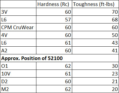

Despite all of the studies on 52100, it is somewhat difficult to find good comparisons in terms of toughness relative to other steels. Many of the studies focus on 52100 itself, as it is the starting point being the most commonly used bearing steel. Tool Steels [13] rates 52100 as a “4” out of 10, which is similar to A2, and higher than O1, M2, and D2, and lower than L6 and shock resisting steels, according to the book. We will be testing a sample of 52100 soon to compare with our current toughness dataset. And if someone knows any good published comparative toughness numbers please send them to me. Using the Tool Steels ratings we can position 52100 within other steels with reported toughness values from Crucible [14][15][16][17]:
