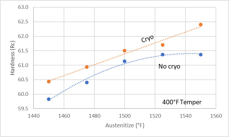

After that prior processing, the effect of austenitizing and cryo was studied with a constant tempering temperature of 400°F. Each was austenitized for 15 minutes at 1450, 1475, 1500, 1525, and 1550°F and quenched in Parks 50. Half were given a cryo treatment in liquid nitrogen for 30-60 minutes. All were tempered at 400°F twice for 1 hour. As expected, higher austenitizing temperatures led to higher hardness, and the cryogenic process led to higher hardness. Cryo leads to higher hardness by converting retained austenite to martensite.
These hardness values line up relatively well with a tempering vs hardness chart I showed in the previous 52100 article that came from a journal article:
Adapted from [3]

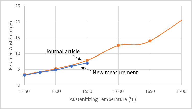

I measured the retained austenite in the specimens and they also lined up with the journal article:
The retained austenite content is relatively low even with 1550°F. The samples that were given a cryo treatment all read as zero retained austenite. Retained austenite decreases hardness somewhat, but also improves toughness because of the high ductility of the austenite. As expected, the cryo-processed steel had reduced toughness relative to the non-cryo samples. Somewhat surprisingly, there was a peak in toughness around 1500-1525°F austenitize:

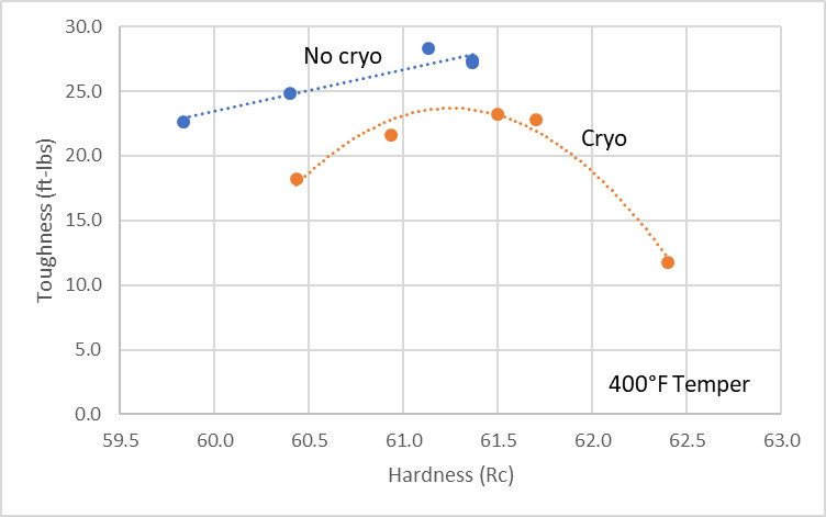

With the non-cryo samples, high toughness was also maintained at 1550°F, but with the cryo version the toughness was reduced. Higher austenitizing temperatures means more carbon in solution which reduces toughness. Perhaps the retained austenite in the non-cryo version is able to counteract the negative effects of higher carbon, while the cryo sample did not have that benefit. Higher austenitizing temperature also leads to grain growth, but a previous study on 52100 [4] indicates that as high as 1600°F austenitize does not lead to significant grain growth.
The reason for the peak in toughness at 1500°F is somewhat more difficult to explain. Typically lower austenitizing temperature is better for toughness because of the reduction in carbon in solution. The increase in retained austenite may explain the improvement in toughness, but the cryo samples without retained austenite showed the same trend. Perhaps the reduction in carbide volume with higher austenitizing temperatures led to an improvement in toughness. It has been reported that 1500°F austenitize results in 8% carbide, while 1550°F gives 6% and 1600°F 5%. More carbide leads to reduced toughness but typically higher carbon in solution drowns out the effect of carbide within a given steel. Comparisons between different steels generally show the bigger effect of carbide. In this case of 52100 it appears that the optimum combination of properties is achieved in the 1500-1525°F range which results in a fine grain size, good hardness, and sufficient carbide for wear resistance and edge retention.
Since the cryogenic processing led to increased hardness, it is hard to tell based on the previous chart whether the toughness has been reduced for a given hardness. However, if we plot toughness vs hardness we can see that without cryo toughness was higher:

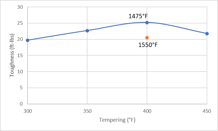

The steel was then austenitized from 1475°F or 1550°F for 10 minutes followed by a quench in DT-48 oil. The thermal cycled, pearlitic steel was austenitized at 1475°F and tempered at 300°F. The as-received steel austenitized at 1475°F was tempered at 350, 400, or 450°F, and the 1550°F samples were tempered at 400°F. Surprisingly, the 1475-300 sample fits the same trend for hardness as the higher tempering temperatures used with the spheroidized steel. This is surprising because the pearlitic starting structure was expected to lead to better heat treatment response. The 1550°F austenitize did lead to slightly higher hardness, as expected. The hardness in general was lower than the DET samples. Perhaps the shorter hold time (10 vs 15 minutes) contributed to the difference.

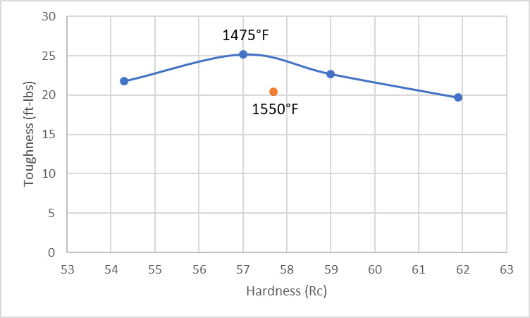

Lower tempering temperature led to reduced toughness, as expected. Again the 300°F temper fits the same trend line as the rest of the samples, so the thermal cycling does not seem to have affected toughness. Tempering at 450°F led to a slight reduction in toughness because of tempered martensite embrittlement. The 1550°F austenitize led to a reduction in toughness relative to the 1475°F. No major dropoff in toughness was observed by reducing the temper below 400°, unlike what was seen with 5160.
Plotting toughness vs hardness instead shows that the best hardness-toughness balance was obtained with the 1475°F austenitize and tempered between 300-400°F. The thermal cycled sample doesn’t look out of place with the rest. The 1550°F austenitize led to somewhat worse hardness-toughness balance.

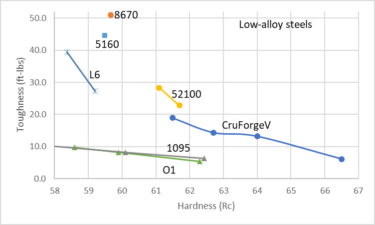

52100 shows good toughness when compared with other low alloy steels, showing superior values to 1095 and O1 that we have also tested. 5160 and 8670 show higher toughness but that is expected since those steels have significantly lower carbon content. It is not entirely clear why 52100 would be tougher than O1 and 1095, since those steels also have a small volume of carbide for high toughness. I believe that the lower carbon in solution with 52100 from the chromium addition gives it better toughness. Alternatively, it may be that the larger amount of carbide in 52100 and CruForgeV provides better resistance to grain coarsening.

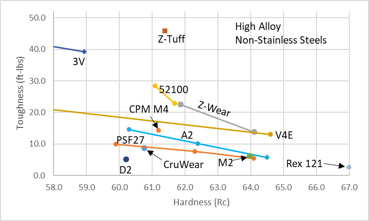

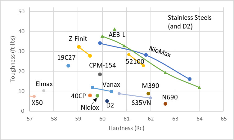

When compared with high alloy steels and stainless steels, 52100 also looks good where toughness is concerned; it has sufficient toughness for many applications.
