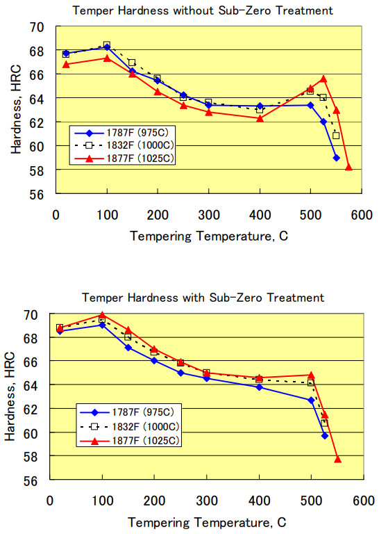

The most intriguing thing about ZDP-189 and Cowry-X is the very high obtainable hardness, 67 Rc or even higher. According to the ZDP-189 datasheet, the maximum hardness is about 70 Rc if given a cold treatment in dry ice.
So one of the biggest mysteries about ZDP-189 is why it is able to reach such high hardness. I have done heat treatment experiments over a range of different stainless tool steels and most max out around 63-65 Rc, so how is ZDP-189 able to make it to 70 Rc? To answer that question we need to discuss what controls hardness so we can see which factors ZDP-189 is exploiting.

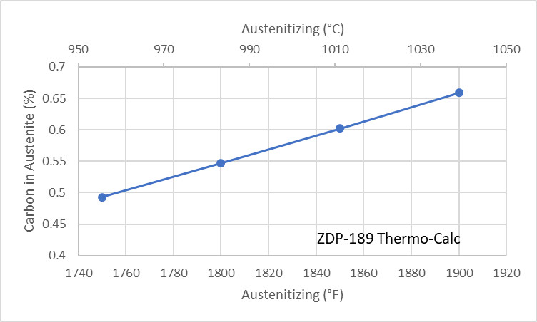

The primary factor that controls hardness in tool steels is the amount of carbon which is in the martensite. During austenitizing, carbide is dissolved putting carbon in solution in austenite, and then the steel is rapidly quenched to “lock in” the carbon in the martensite. Read more about the strength of martensite in this article. With 3% carbon, it is possible to get quite a bit of carbon in solution with ZDP-189 and Cowry-X.
You can see that the max hardness reaches a peak around 67 Rc or so and either levels off or even decreases past a carbon content of about 1%. The reason why the hardness can drop is because of excessive retained austenite. This can be seen in the “without subzero” tempering chart of ZDP-189 where the 1025°C austenitize led to lower hardness than the 1000°C austenitize. The higher austenitize led to more carbon in solution but excessive retained austenite so its hardness was reduced.

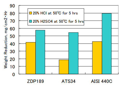

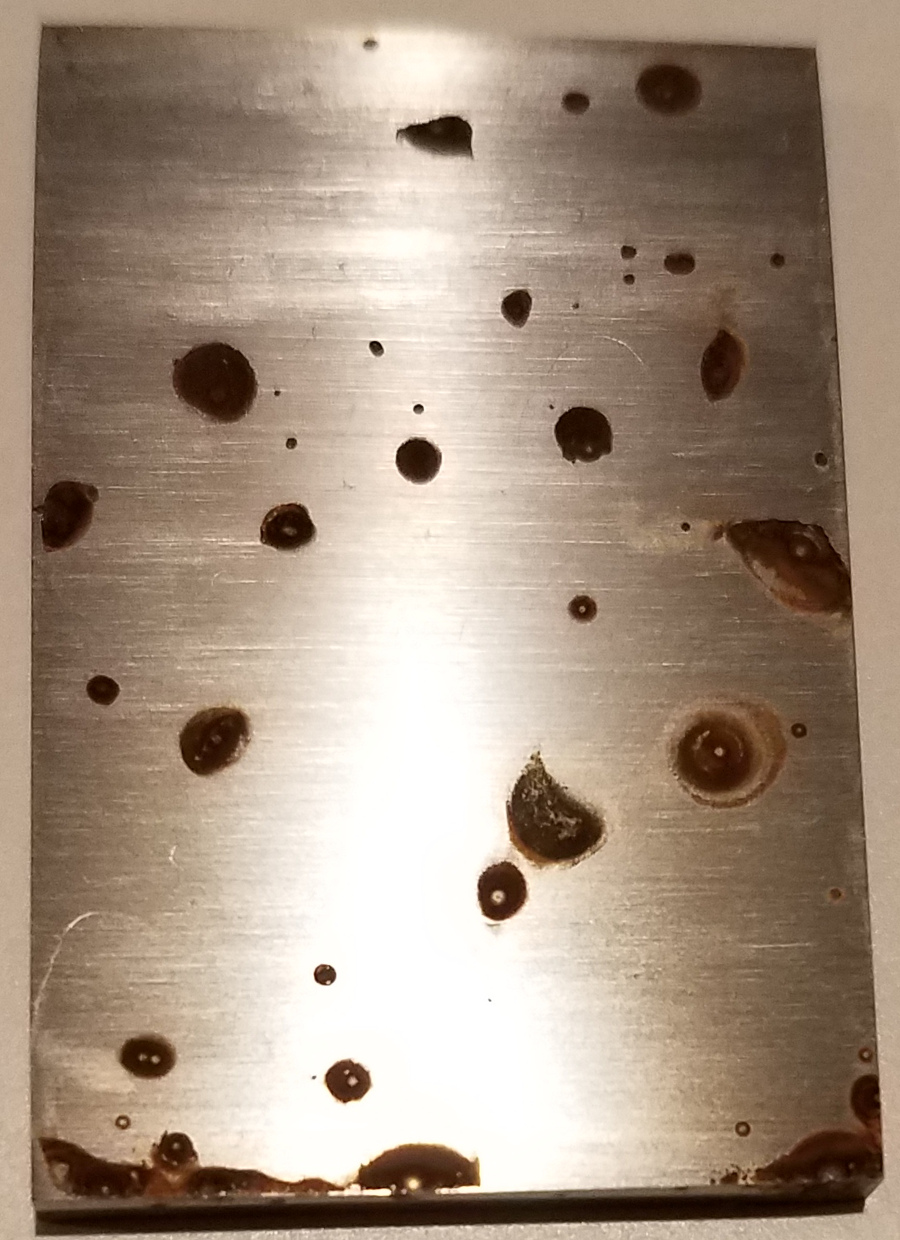

As indicated in the hardness section, ZDP-189 appears to have low chromium “in solution” which is primarily what controls corrosion resistance. However, Hitachi presented corrosion experiments with ZDP-189 that show the steel having comparable corrosion resistance to 440C and ATS34:
I previously wrote about corrosion resistance in this article, where I gave ZDP-189 a very low rating for corrosion resistance and predicted that it did not qualify as “stainless.” In that article I finished a range of steels to 400 grit after heat treating them and sprayed water on them. All of the steels were rust/corrosion free except for XHP and so I deemed that it does not qualify as a “stainless” steel though that definition is surprisingly dubious among metallurgists. I repeated this experiment with ZDP-189 along with Takefu SG2 and VG10 at the same time. The two Takefu steels passed without corrosion but the ZDP-189 steel saw significant rusting after only 8 hours.
I have no good explanation for why Hitachi found decent corrosion resistance with ZDP-189 while I did not. Perhaps those mass-loss acid tests do not predict rusting well. Or maybe they had poor testing procedures or exaggerated their results; I cannot say. However, Thermo-Calc predicts low Cr in solution, the Cr:C ratio is very low, and the high obtainable hardness all point to the Cr in solution being low. Furthermore, there are reports from users about ZDP-189 corrosion resistance being relatively poor [3]. So I trust my corrosion test over Hitachi’s. ZDP-189 is not a stainless steel.

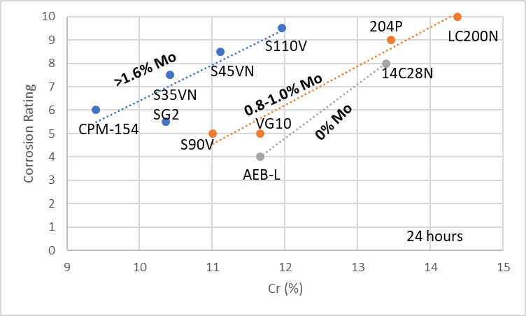

To achieve high hardness we want the chromium in solution to be on the lower side but still be stainless. One way to improve corrosion resistance without chromium is with molybdenum, as shown in this chart from my corrosion resistance experiments:
You can see that CPM-154 has the lowest Cr of the steels on the chart, but has decent corrosion resistance thanks to its high Mo content. CPM-154 also passed the “is it stainless?” test with distilled water. Molybdenum has less effect on retained austenite than Cr (see the Ms equation) so this may be a way to achieve relatively high hardness despite being stainless. I also tried low tempering temperatures (<300°F) to see the boost possible from precipitation strengthening. I don’t normally recommend tempering below 300°F but Hitachi does with ZDP-189 so I figure it’s not cheating. CPM-154 also has the benefit of being made up of chromium carbides so sharpening is not affected by the harder vanadium carbides.

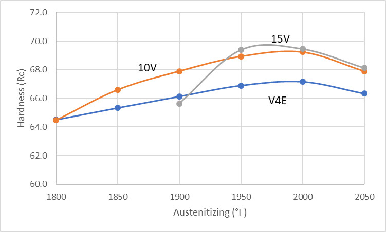

I already knew the approximate austenitizing temperature for peak hardness from previous heat treating experiments so I restricted my analysis to 2000, 2025, and 2050°F austenitizing temperatures with a 20 minute hold. I then plate quenched, dipped in liquid nitrogen for 12 hours or so, and then tempered twice for 2 hours each time at the following temperatures:
It looks like we did not quite reach 66 Rc but we almost got there. The drop in hardness above 2025°F is from excess retained austenite with all that carbon and chromium in solution. I did a heat treatment of 2025°F with 300°F temper that resulted in about 64.1 Rc for toughness specimens that you can see in the previous toughness diagrams. The ~64 Rc CPM-154 had significantly higher toughness than ZDP-189 so it has a toughness benefit over the ZDP. It would be interesting to see what the hardness is like with the 250°F temper and 65+ Rc but perhaps 64 Rc is enough for most people.
