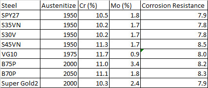

I have previously performed corrosion resistance experiments and related it to predicted chromium and other alloying elements “in solution,” as you can read here. Based on the predicted alloy in solution for SPY27 it should have similar corrosion resistance to S30V and S35VN. You can see my corrosion resistance rating in the table below:
This is a pretty decent corrosion resistance, similar to Elmax (7.8), but is below steels like S45VN (8.4), M390 (9.1), and Vanax (10). You can see more ratings in the corrosion resistance article I linked to above.

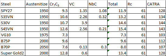

I used carbide contents from Thermo-Calc to estimate CATRA edge retention relative to 440C at 58 Rc (100%). I estimated edge retention for a hardness of 61 Rc. You can read about edge retention and predicting it based on carbide content and hardness here. The edge retention of SPY27 is expected to be a bit below S35VN, similar to Super Gold 2, though higher than steels like VG10, 440C, and CPM-154.

Toughness of steel can be difficult to predict based only on composition or carbide content. In general, lower carbide volume means higher toughness. However, it is also controlled by carbide size and I do not have any micrographs of the new steel. The 1% niobium content may help refine the overall carbide structure when compared with 0% or 0.5% Nb PM stainless steels. It may be that the reduced carbon content when compared with S35VN leads to superior toughness. See the edge retention prediction chart to see the expected carbide volume of SPY27 which came in under S35VN, S30V, S45VN, and Super Gold 2, and is also lower than Elmax and M390 which are not shown in the table. Therefore I would expect SPY27 to have toughness at least as good as S35VN and probably better, but that would have to be confirmed experimentally. Here is a chart of other steels to compare with S35VN:

CPM SPY27 is a steel produced by Crucible exclusively for Spyderco. The steel looks somewhat similar to S35VN but with increased Nb and N, decreased C and V, and a 1.5% cobalt addition. The resulting steel is expected to have similar hardness and corrosion resistance to S30V and S35VN. The edge retention is likely a small step down from S35VN. The toughness is probably a bit better than S35VN. And sharpening is probably a bit easier to S35VN. Hopefully we will be able to learn more as knives are released. Unfortunately, I am probably unlikely to get flatstock for experiments due to the steel being exclusive to Spyderco.
