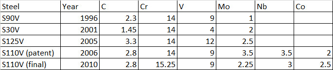

To put S110V into context, we should compare the composition of the steel with previous Crucible products to see how the evolution led to S110V. You will also see I have two compositions listed for S110V, one labeled “patent” and one labeled “final.” The initial version of S110V was modified leading to the version that we have today. I will discuss the differences after describing more about the general design of the steel.

The patent for S110V and the original datasheet released in September 2008 (I archived it here) is the original composition labeled as “patent” in the composition table. However, a revised version of the steel was released, and the datasheet was revised in July 2010. I have seen almost no discussion of the change in composition, and I think most people are unaware that it ever changed. In fact the revised datasheet shows all of the same data for corrosion resistance, hardness, and wear resistance despite the fact that the change in composition was relatively substantial.
I don’t know how much S110V would have been made into knives before the change in composition, but it is interesting that a relatively large change was made to the steel but without a name change. I have asked current Crucible metallurgist Bob Skibitski as well as the main inventor on the patent, Alojz Kajinic, and neither knew why the change was made as they were not directly involved with it. However, I have some speculation about why the composition was changed.
The changes were likely made to improve “manufacturability,” such as issues with gas atomization, forging, or annealing of the steel. One change to S110V was a reduction in Nb from 3.5% to 3%. As mentioned in the niobium section, there are limits to niobium alloying with typical powder metallurgy steel production. It could be that Crucible decided that the niobium was too close to the danger zone. Whether this was due to a problem that was observed in production or simply being cautious I am not sure. I don’t know of any other powder metallurgy steels that even have as much as the 3% in the current version of S110V.
The reduction in Nb may have led to the other changes in the steel. Since Nb improves corrosion resistance by helping the Cr go further, they may have attempted to compensate for the reduction in Nb by increasing the bulk Cr from 14% to 15.25%. But the chromium increase was more than was necessary to achieve a similar amount of chromium in solution (see the table below), and they also decreased the Mo content by a similar amount to how much the Cr was increased (from 3.5 to 2.25%), so the reason for that change is not completely clear to me. Perhaps they identified high Mo as an issue as well, such as difficulty in annealing or excessive hardenability leading to cracking during cooling after forging. With increased Cr in solution, but decreased Mo, it is not clear which version would have superior corrosion resistance. In previous corrosion testing I performed, I found that the effect of Mo topped out at a certain level, but it would be surprising if Crucible also came to a similar conclusion.
The cobalt content was increased from 2 to 2.5%, likely based on updated estimates of how much austenite stabilization is necessary after the changes to Nb, Cr, and Mo. Or maybe they thought it gave a bit more “factor of safety” to ensure full austenitization would be possible. In older versions of ThermoCalc it showed that S110V with 2% Co would be fine, which Crucible would have been using at the time, but newer versions show a small amount of ferrite at 2150°F, around 4%. If they found a small amount of ferrite in S110V that would have contributed to the decision to increase Co, of course.
In terms of carbide differences, the total carbide content was slightly increased in the final version, primarily from an increase in chromium carbide (labeled M7C3 below). This would likely make the new version marginally worse in terms of toughness-wear resistance balance, as the original version had a higher proportion of NbC and VC and slightly less overall carbide.

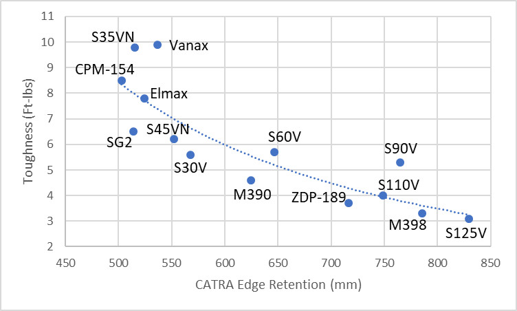

I did a large number of edge retention experiments which were summarized in this article, and I also added M398 which was discussed here. This uses a standard rectangular knife ground to 0.015″ prior to putting a final edge of 15 dps with a 400 grit CBN matrix stone. The results can be seen below.
S110V has very high edge retention, as expected, being similar to CPM-10V. However, what is surprising is that it did worse than S90V. S110V is essentially S90V with more C, Cr, Co, Mo, and Nb, and it is difficult to think of scenarios where adding more of those elements would lead to reduced edge retention. This does not appear to be an issue of experimental variability as none of the tests performed on S110V resulted in as high values as the average result of S90V (each was tested 3 times). In my original edge retention article I speculated that perhaps the smaller carbide size was the difference and I made some comparisons with the size of the abrasive particles used in the testing. But I still don’t know for sure why S110V wasn’t as good as S90V in testing. Regardless, the edge retention of the steel is high and perhaps worrying about whether or not it is as good as S90V isn’t of practical use.

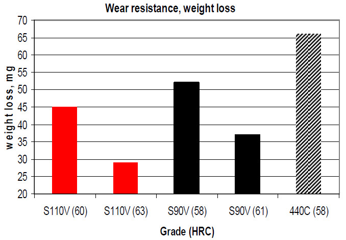

In Crucible’s wear resistance testing of the original S110V, they show the following chart for wear resistance, that appears to show an improvement over S90V:
However, if you plot those values versus hardness it becomes apparent that the two steels have the same wear resistance:
So Crucible’s data shows that there was no improvement in wear resistance from S90V to S110V, which lines up relatively well with our edge retention testing. However, Crucible’s testing was with the original S110V which, as I described before, would have a greater proportion of NbC and VC carbides for wear resistance.

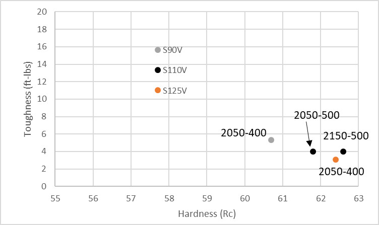

I tested two conditions of S110V, one austenitized at 2050 and another at 2150°F, with both tempered at 500°F. These heat treatments all included a cryo step after quenching. Somewhat surprisingly, they both resulted in identical toughness despite the higher austenitizing temperature leading to higher hardness. In heat treatments of S30V, S35VN, S45VN, and SPY27, an increase in austenitizing temperature was found to increase both hardness and toughness, so this result would be consistent with that. However, this steel has high hardness and corrosion resistance which can mean excess retained austenite which sometimes leads to inflated toughness values. This behavior was seen with M390 when austenitizing too high. And with some users reporting difficulty in deburring S110V (usually means high retained austenite), I’m not sure I would actually recommend heat treating S110V from 2150°F despite the apparent superior hardness-toughness balance.
Below I have plotted the steel also in relation to other stainless steels along with a hardness-toughness trendline from S60V. You can see that S90V and S110V are along a similar trendline (only the 2150 condition of S110V is shown). So it could be that S110V has similar toughness to S90V, but also recall that the 2050 condition led to lower hardness with no improvement in toughness. So more heat treatments would have to be tested to see if greater toughness at lower hardness could be achieved. So being conservative we would say that S90V is tougher than S110V which has higher toughness than S125V. This makes sense because of the lower carbide content of S90V, while the smaller carbides of S110V provides better toughness than S125V despite the similar carbide content. S90V and S110V both offer superior carbide structure and toughness when compared with M398.

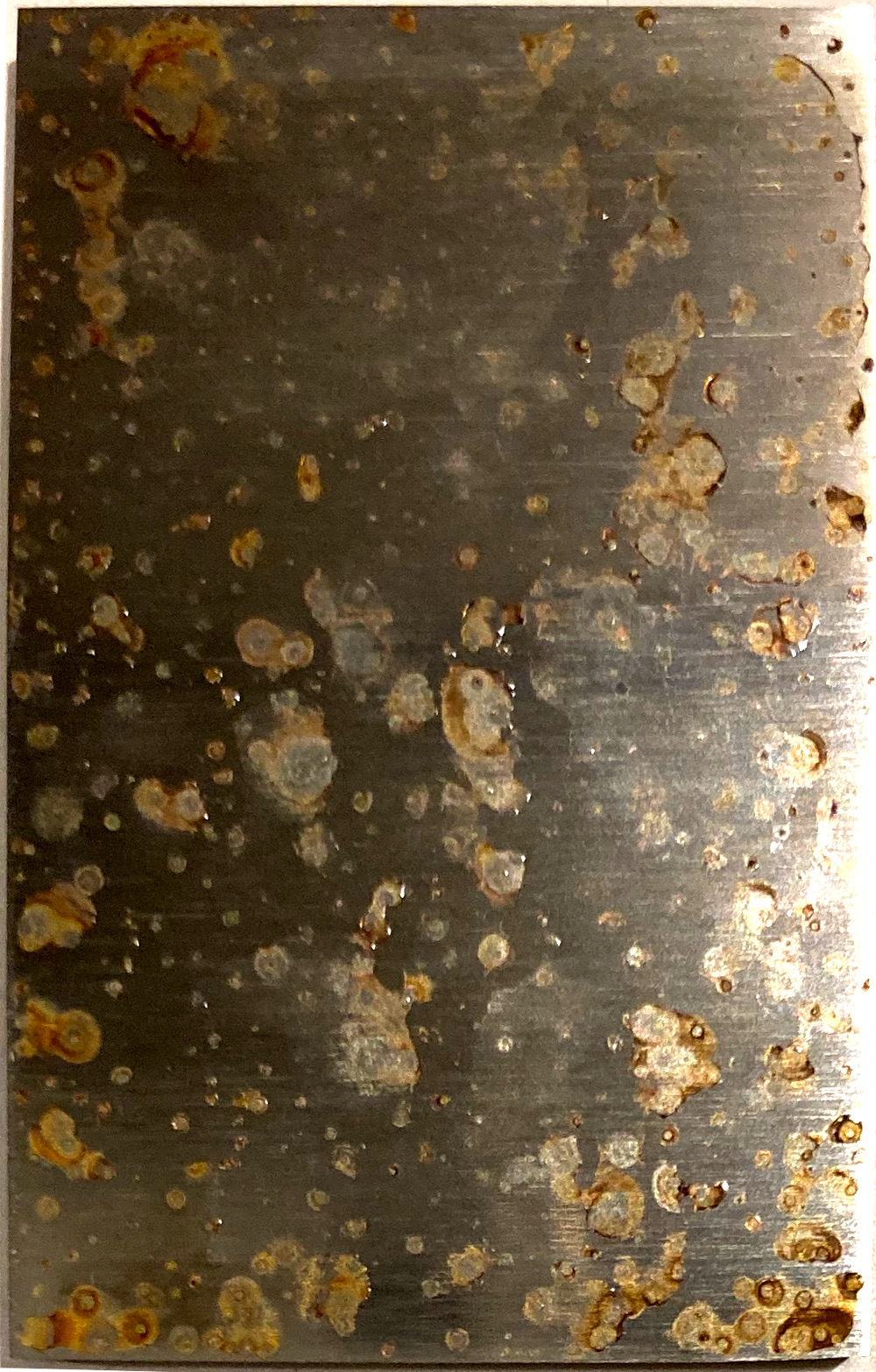

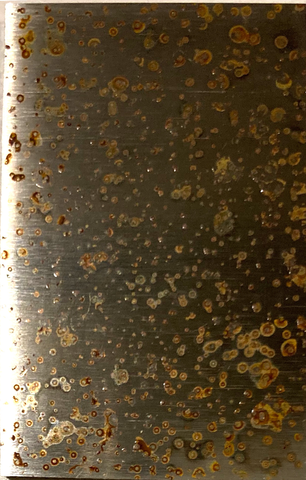

In my original corrosion resistance experiments with 1% saltwater I found S110V to have very good corrosion resistance, certainly a significant upgrade over S90V and S125V, and being similar to M390, another grade with very good corrosion resistance. This improvement in corrosion resistance was expected based on the modifications with Nb and Mo that were described earlier. And in the more recent comparison directly with M398, S110V again performed similarly.
S110V
M398
S90V
S125V
