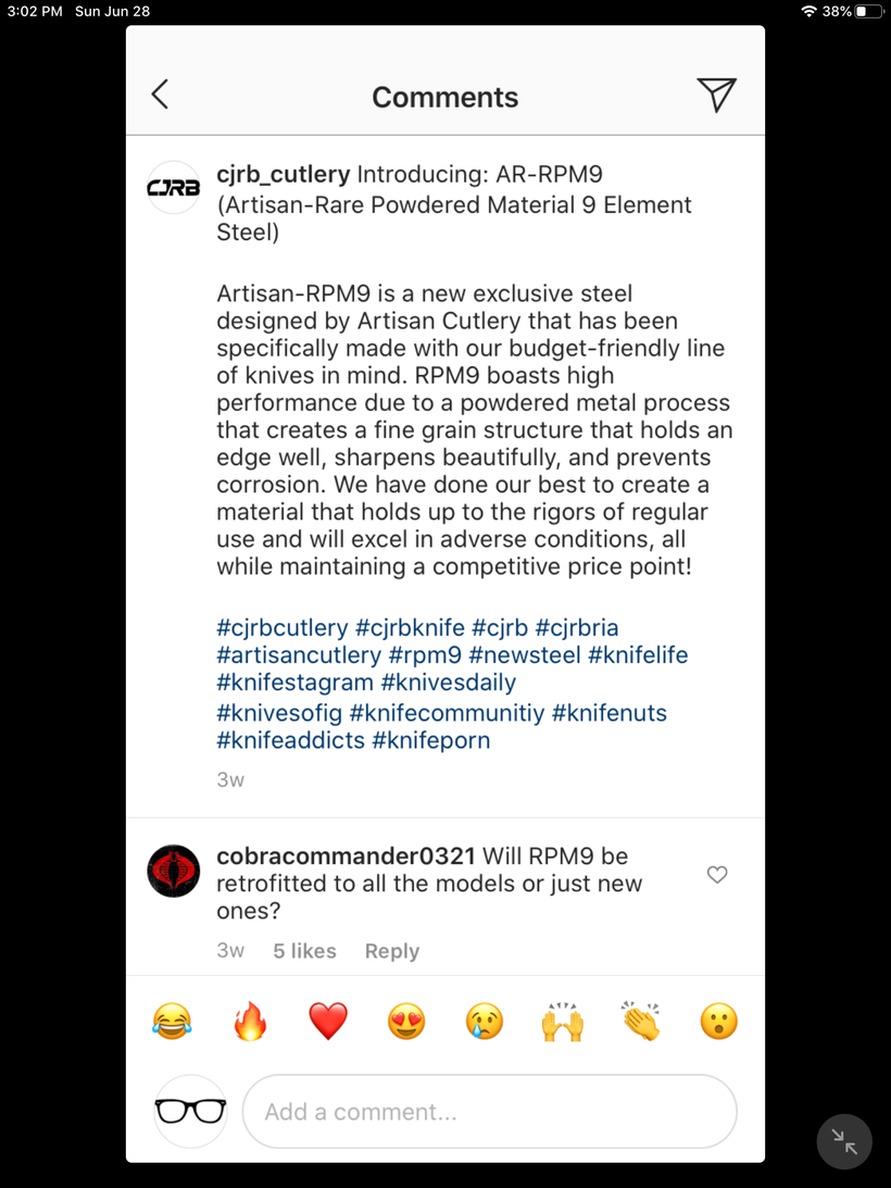

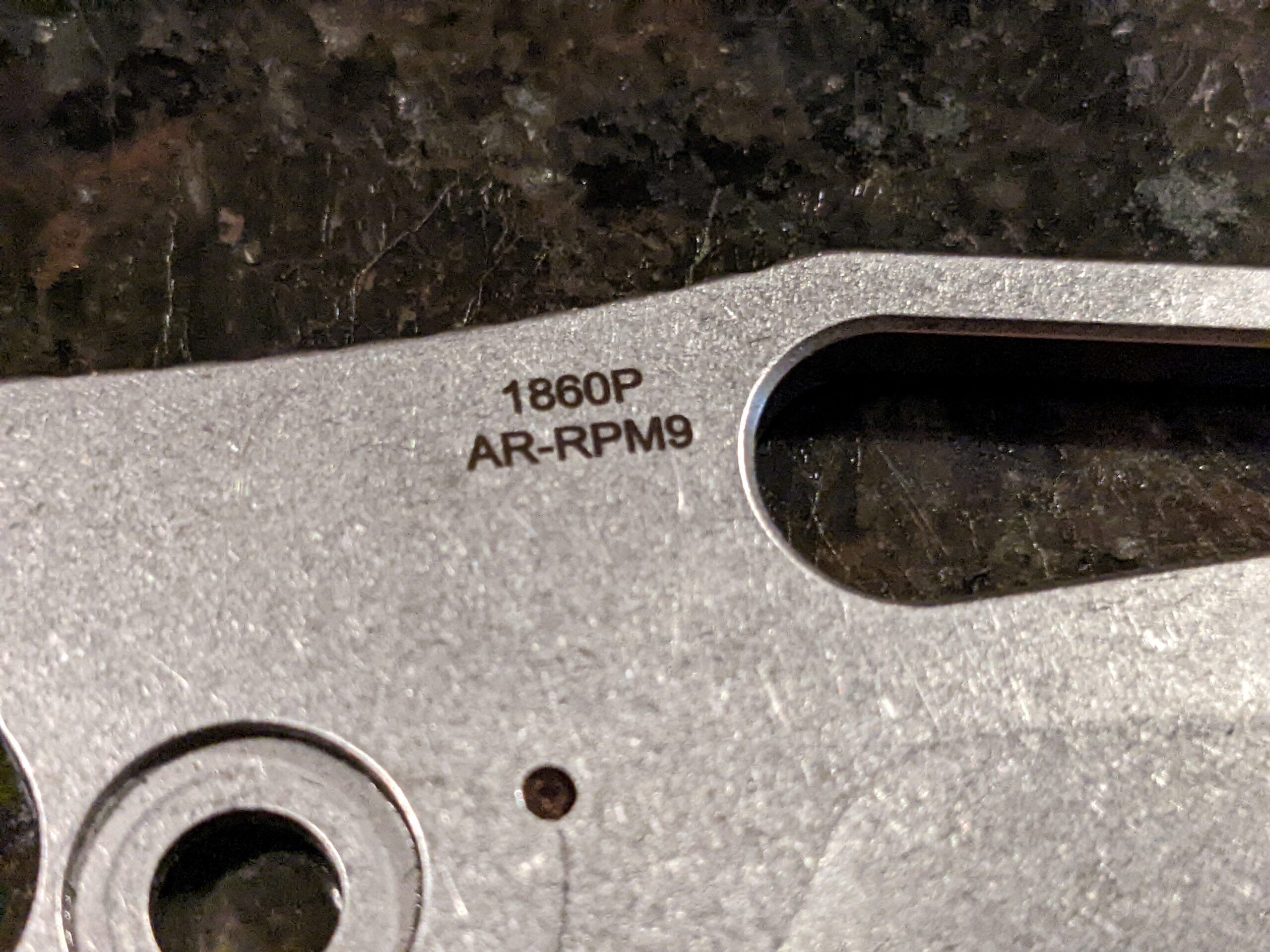

AR-RPM9 Announcement and Name
AR-RPM9 was first announced in June 2020 on the CJRB Instagram, though oddly their Instagram doesn’t seem to go back that far now. I have a screenshot of it here:
CJRB is another brand owned by Artisan Cutlery. AR-RPM9 stands for “Artisan-Rare Powdered Material 9 Element Steel.” That is a very odd name so let’s break it down one element at a time. Artisan makes sense, it refers to Artisan Cutlery. But why “Artisan-Rare”? Just to have an oblique reference to AR rifles? I honestly don’t know. Then “Powdered Material” is odd, generally when we say “PM” steel that means “Powder Metallurgy” or “Particle Metallurgy” but not “powdered material.” In my original Patreon post about this steel I hypothesized that perhaps they were using weasel words for some other process that isn’t powder metallurgy but then they released a video in September 2020 where they specifically called it “powdered metallurgy” process, but we will come back to that. Then “9 Element Steel” which is a good lead-in to the composition discussion.

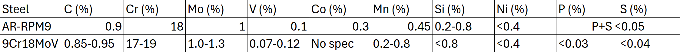

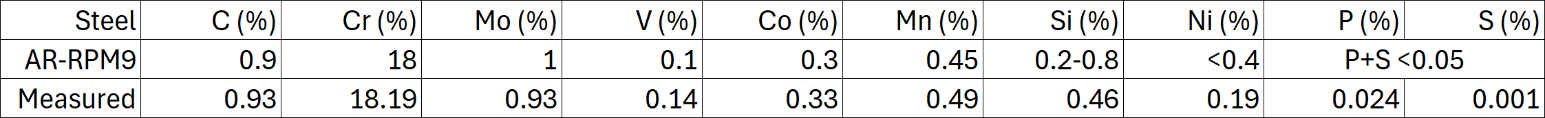

Composition of AR-RPM9 (Why it should actually be called AR-RPM7)
Artisan Cutlery revealed the composition of the steel in that September 2020 video. I was excited to see what it might be since they claimed to have designed a “new exclusive steel” designed specifically “with our…knives in mind.” Plus nine elements is quite a bit, so they must have gotten very creative in the design of the steel. Unfortunately, the reveal was quite underwhelming. The composition they specified was identical to the common 9Cr18MoV, the same steel as the European 1.4112, and very similar to American 440B. There were a few oddities in the description. One of the elements the video said was part of the 9 was “less than 0.4% nickel.” That is the same maximum allowable nickel content in 9Cr18MoV. Having a maximum allowable content means that it isn’t intentionally added; there is no minimum requirement. This is because nickel is present in a lot of recycled stainless steel. For example, I measured between 0.16 and 0.28% nickel in stainless powder metallurgy steels from Crucible, Carpenter, Bohler, and Uddeholm. So we are already down to 8 elements not nine.

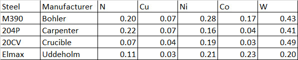

Measurements of nitrogen, copper, nickel, cobalt, and tungsten in a range of powder metallurgy steels
Another oddity in the Instagram video was that he said there were “rare earth elements” in the steel, with elements plural so potentially we are back up to 9 or maybe even more. Before saying what those rare earth elements were, the Instagram video cut off. Rare earth elements are used in some steels and include elements like lanthanum and cerium, used for a couple different reasons in the steelmaking process. So a pretty unusual addition, especially to announce publicly, as often they are used without advertising to the public, in part because it is a trade secret and in part because they are used in very small amounts. Fortunately, Artisan Cutlery later clarified to Knife Newsroom shortly after what these elements are, and even later in December they uploaded a full version of the cutoff instagram video to YouTube. The answer was baffling: phosphorus and sulfur. Phosphorus and sulfur are not rare earth elements. I have never heard anyone say they are rare earth elements. Those are common impurity elements that are often specified with a maximum allowable content. They are not desirable, and are not considered an addition to the steel. So now we are down to 7 elements. We need to rename the steel AR-RPM7.
The only potentially relevant change is cobalt, which they said is 0.3%. 9Cr18MoV doesn’t have a cobalt specification, and 0.3% is a very small amount, so an argument could be made that it would still fit under the 9Cr18MoV spec. Cobalt is also present in a lot of recycled steel, so there is generally at least a small amount of it, though usually less than 0.3%. Furthermore, an addition of 0.3% cobalt to a steel would have a very minor effect on properties. Even with controlled testing of properties with and without 0.3% cobalt I’m not sure a metallurgist could come up with which is which. So maybe this is the change to 9Cr18MoV that they thought was enough to be a “new steel.”
I measured the composition of the steel with Optical Emission Spectroscopy (OES) and the elements were within expected ranges. Of course other trace elements were present which is also expected but I have not included them so as to not confuse anyone.

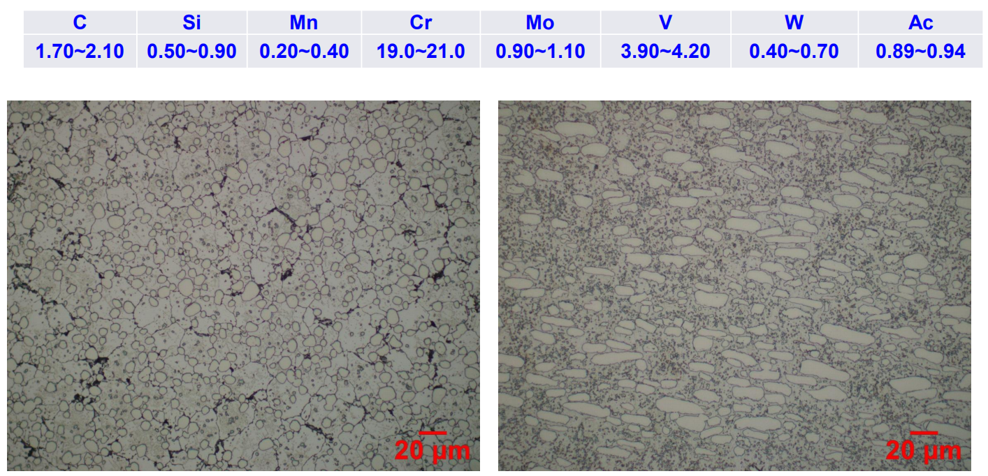

What is Spray Form?
Sprayform is an intermediate technology in between conventional casting and powder metallurgy. In conventional casting, the liquid steel is slowly cooled in a mold to form an ingot. The slow cooling leads to alloy segregation and large carbides. With powder metallurgy the liquid steel passes through a nozzle and is sprayed with nitrogen gas to rapidly solidify (gas atomization) the steel into fine particles (powder), which is then placed in a canister under high pressure and temperature called hot isostatic pressing (HIP) to create a solid ingot. The steel is then forged and rolled like normal. I previously wrote about powder metallurgy in this article.
Sprayform is somewhat similar to powder metallurgy in that the liquid iron is sprayed with nitrogen gas, but instead of fully solidifying, the partially solidified steel is sprayed onto a table which lowers during processing to create the entire ingot. This leads to an intermediate microstructure which is not as fine as powder metallurgy but also not as coarse as conventional steelmaking. I have an article comparing D2, sprayform D2, and powder metallurgy D2. Below are micrographs showing the difference in D2 microstructure with the three different technologies:
Conventional D2
Sprayform D2
Powder Metallurgy D2
As one more example, here are micrographs from Fenghe PSF showing their ripoff of M390 made with sprayform (right) compared with the powder metallurgy version (left):
Powder Metallurgy M390 (left) and Sprayform M390 (right)
You can see that the carbides in a sprayform steel are in between powder metallurgy and conventional. Sprayforming is done because it is lower cost vs powder metallurgy, eliminating the HIP step.

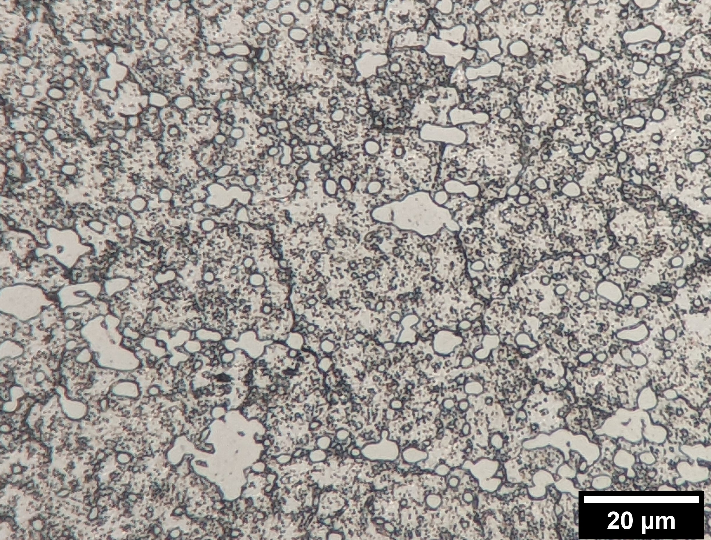

What Technology is Used for AR-RPM9?

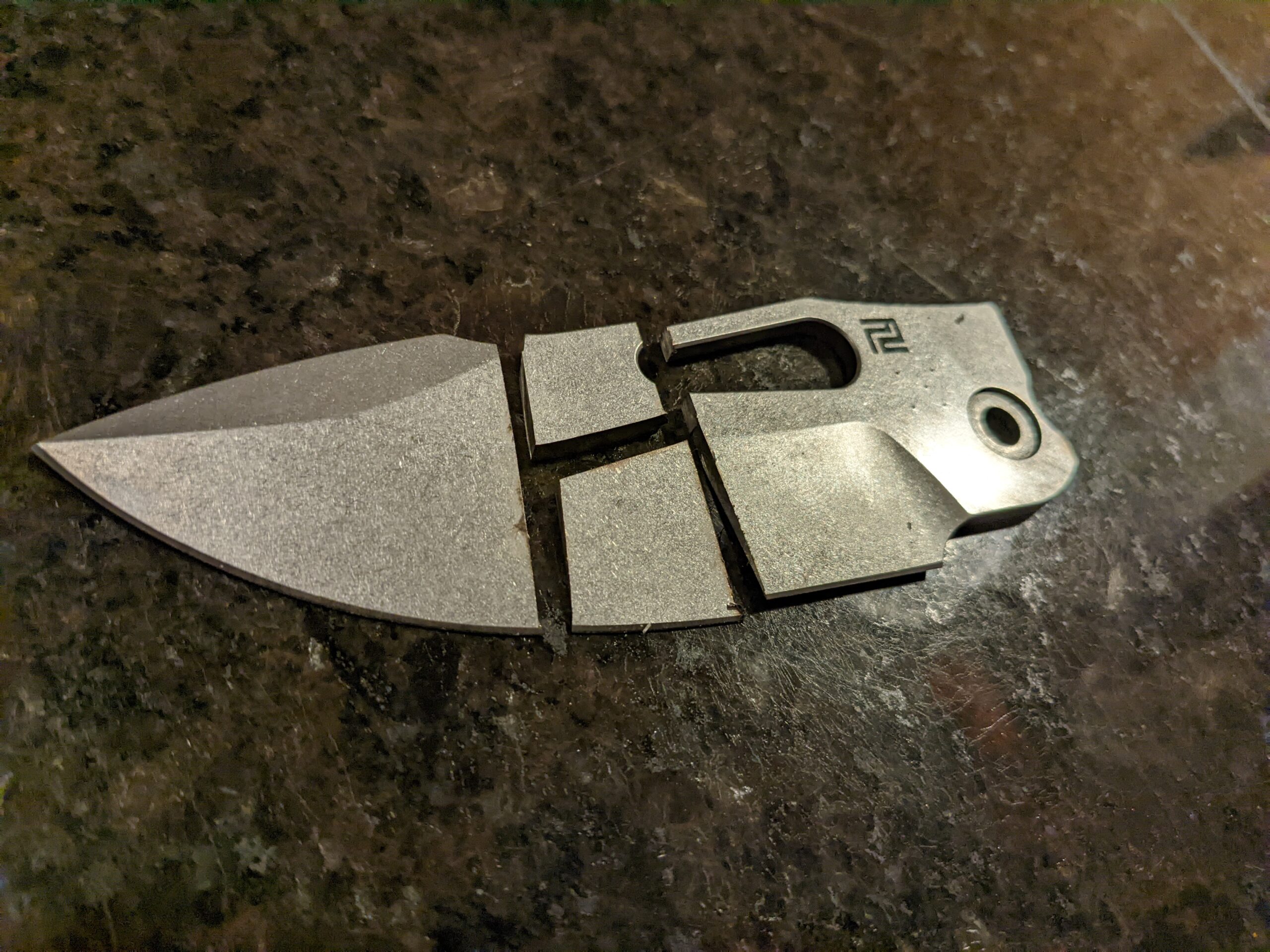

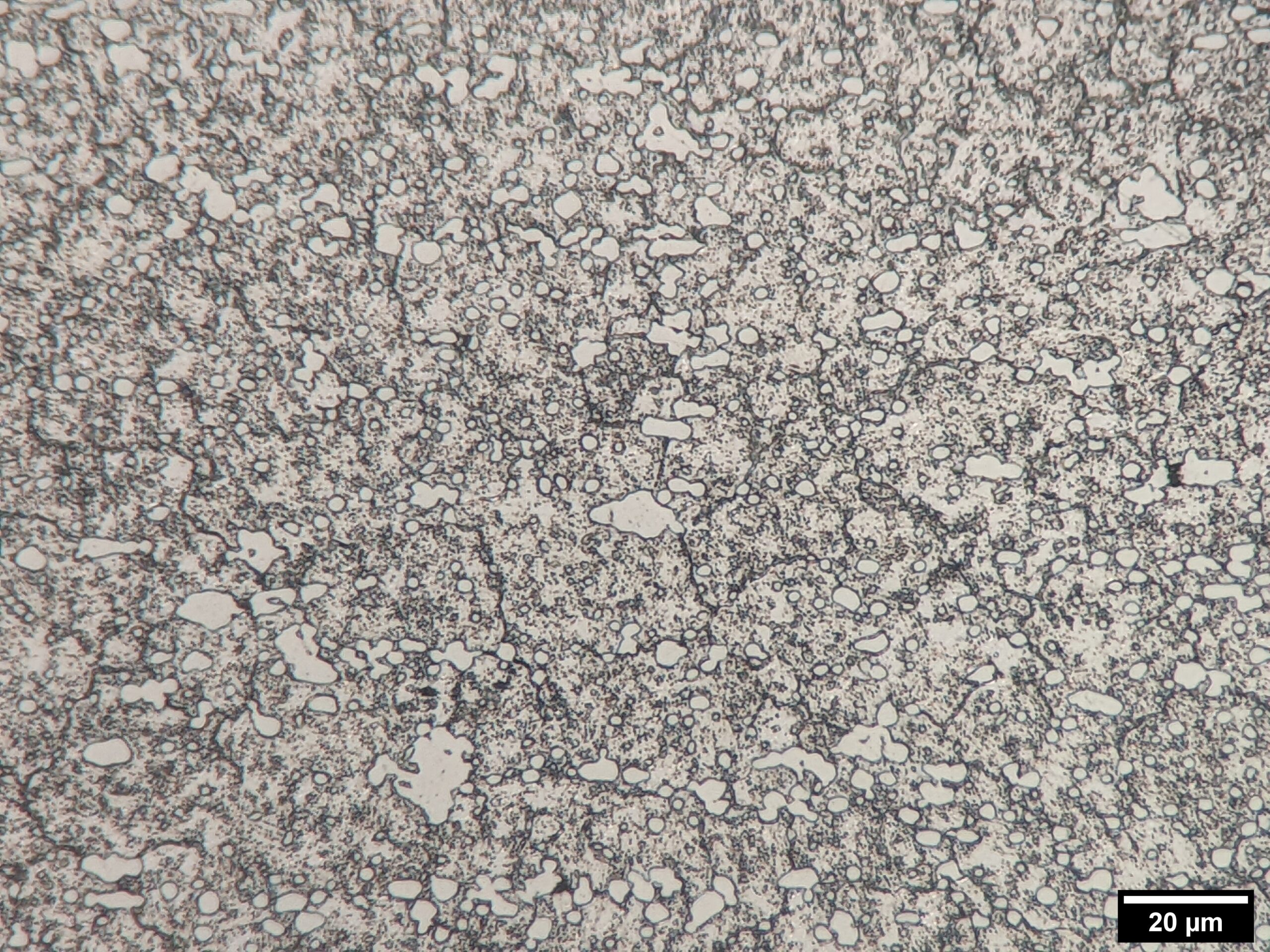

So Shawn Houston of Triple B Handmade and I bought a couple knives from Artisan Cutlery to investigate the microstructure.
High Magnification (same as prior D2 micrographs)

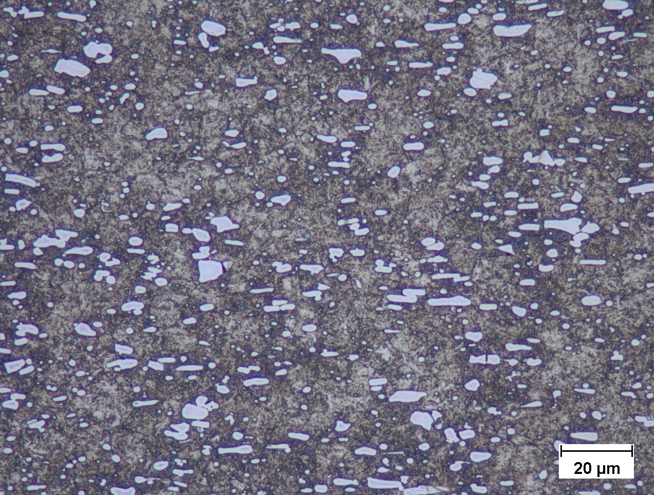

AR-RPM9 Medium Magnification
Here is Sprayform D2 for comparison:
Sprayform D2 Medium Magnification
It is evident immediately that this is certainly not a powder metallurgy steel. There are many large carbides that I have never seen in any PM steel. I don’t believe that it would be possible to make a PM steel with carbides that large. With the largest carbides being around 10 microns I think sprayform is the most likely, though I could almost be talked into it being a conventionally produced steel. To compare the carbide size with 9Cr18MoV, the conventional version of this steel, we looked at edges of knives in both steels:

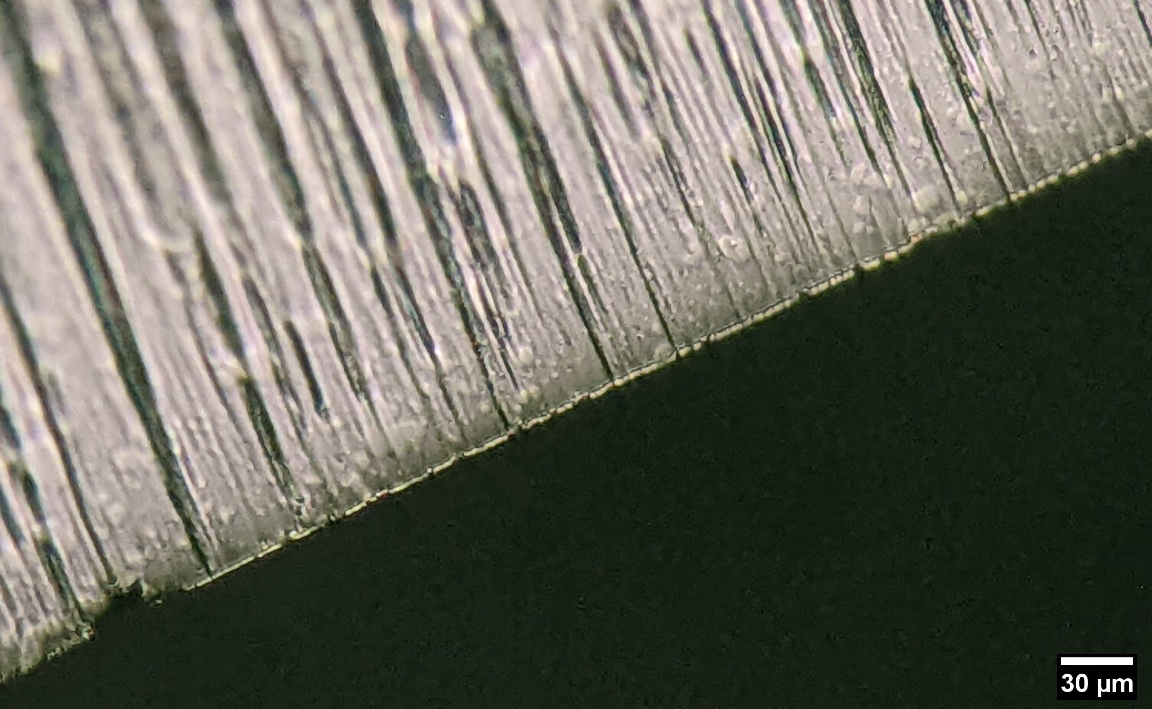

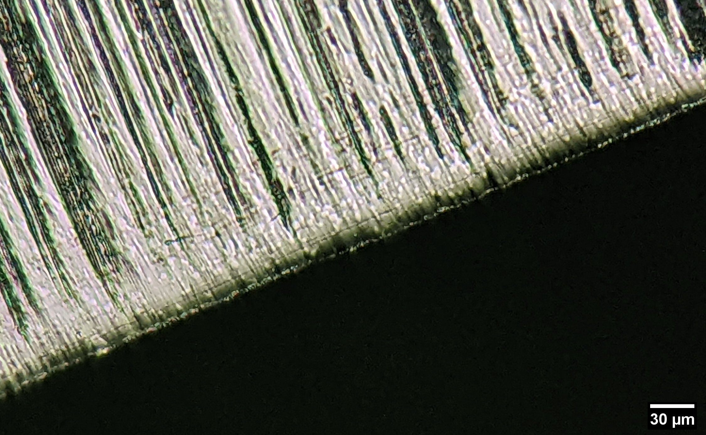

AR-RPM9 knife with relatively small carbides visible
9Cr18MoV knife with relatively large carbides visible
The carbides appear larger in the edge of the 9Cr18MoV knife when compared with the AR-RPM9. And the carbides in the AR-RPM9 look much too large to be powder metallurgy. So I think sprayform is the most likely production technology.
