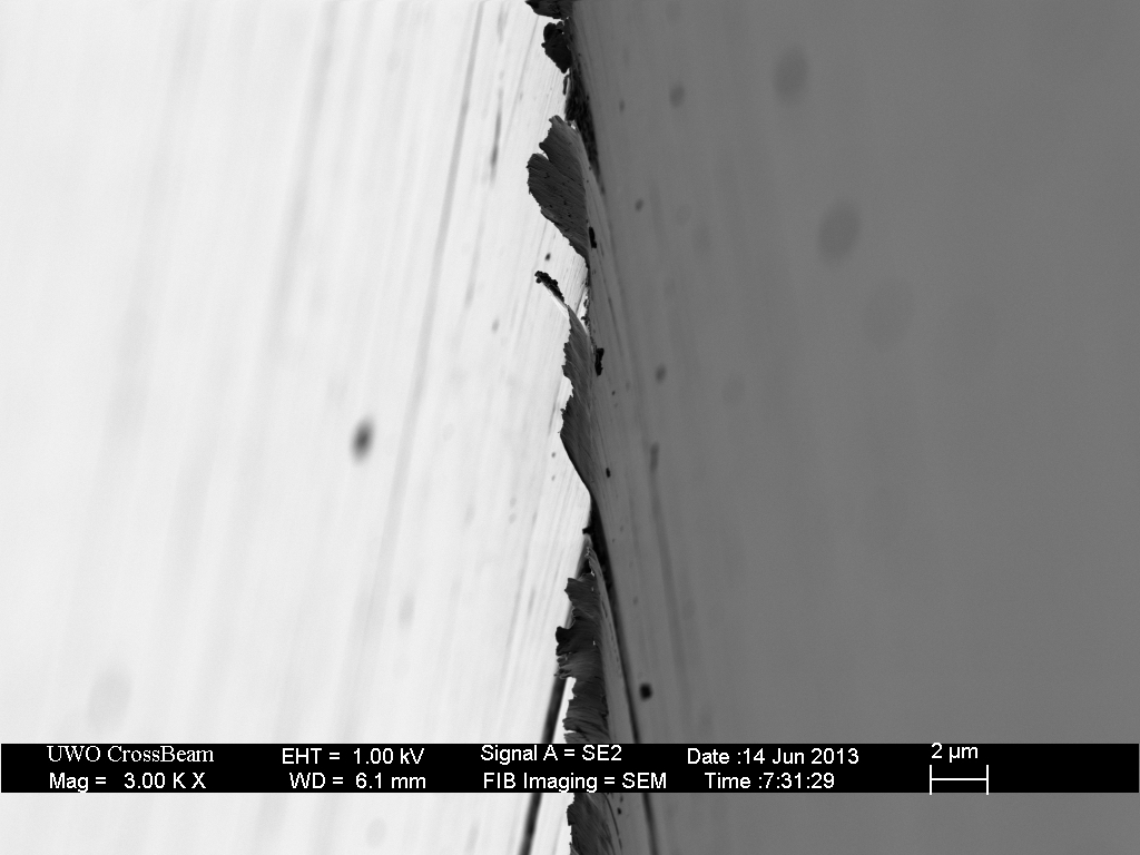

Rolling of Edges
Rolling of edges is in some ways connected to chipping and in other ways the opposite. They are similar in that thicker or more obtuse geometry is the easiest way to help prevent rolling. Thicker geometry has a very strong effect on strength of edges, the simple calculations are described here. After geometry the prevention of rolling is controlled by the strength of the steel. The most common measure of knife steel strength is rockwell hardness, though that is not always a perfect measure of strength. Steel can have a low “yield strength” for a given hardness which means that rolling will occur more easily. Undertempering or excessive retained austenite are two reasons for low yield strength. Read more in this article.

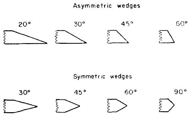

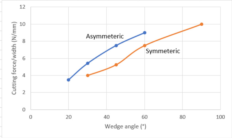

Cutting Ability vs Strength and Toughness
Thinner and more acute edges cut better than thicker and more obtuse edges. This is independent of sharpness. A knife can be sharp but still have poor cutting ability. On the flip side, as described above, the thicker and more obtuse edges have better resistance to chipping and rolling. This is one of the primary design tensions in knives. Unfortunately, humans are not always predictable. One user may be fine with a very cutting ability knife while another will chip the edges or break the knife. And it is also dependent on the intended application, from choppers to kitchen knives to “general use” folding knives. It’s difficult to give broad recommendations, it is up to the knifemaker and customer to determine the best balance. The customer does have some control over the edge geometry through sharpening. The knife can be sharpened to a more acute edge, or through more work the edge can be thinned.
Cutting force (lower means better cutting ability) vs edge angle

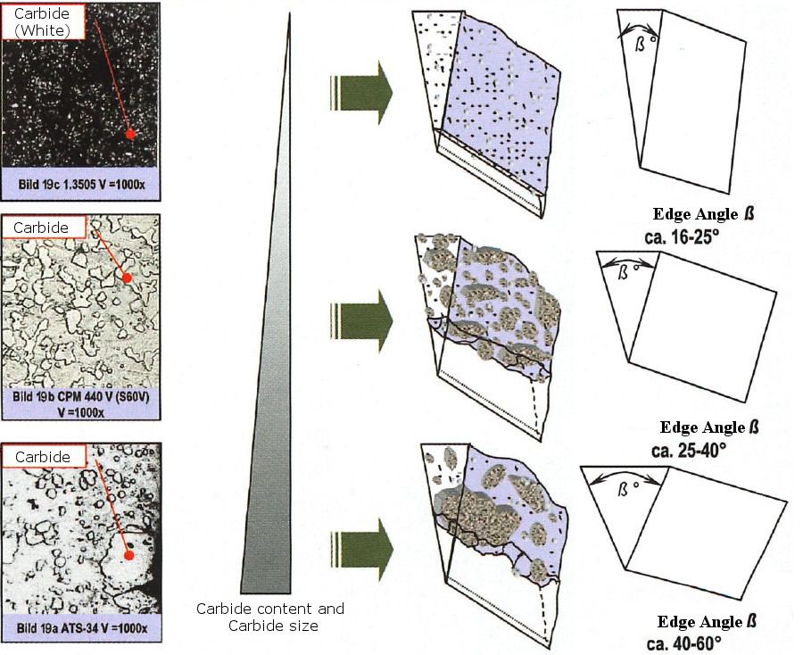

Edge Stability
Roman Landes likes the term “edge stability” to describe an edge’s ability to resist rolling and chipping. A combination of tough steel at high hardness provides the best resistance to rolling and chipping, allowing the design of fine cutting knives with thin edge geometry. I recommend my linked article and Roman’s book if you want to learn more about edge stability.

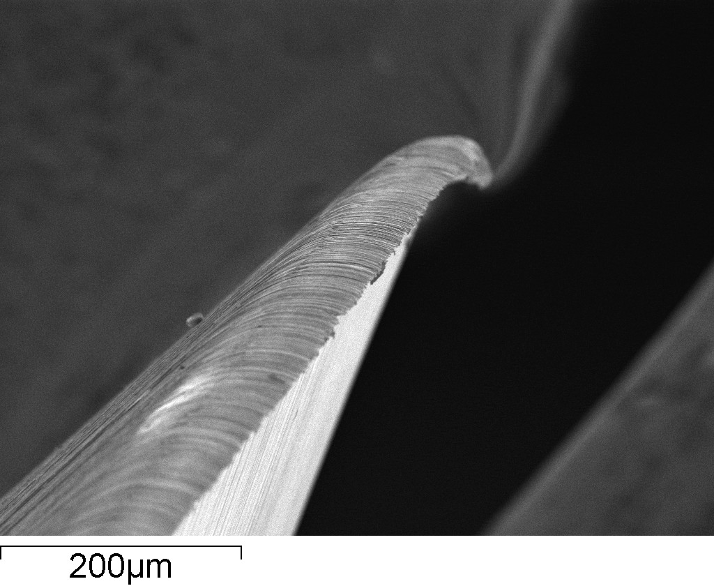

More wear resistant steels are also more time consuming to sharpen because sharpening is a process of wearing the steel back to sharpness. However, thinner edges also require less material to be removed in sharpening which makes it less time consuming. Time in polishing isn’t necessarily changed by thin geometry so highly finished edges with the highest sharpness are most affected by high wear resistance steels. Some customers are more sensitive to “hard to sharpen” steels than others. And some customers prefer a steel that is easy to sharpen and willing to give up some edge retention, such as those that like to regularly stop their knives to keep high sharpness in between light to medium cutting tasks. Other customers prefer high edge retention either because they want to sharpen less frequently, or the cutting tasks they perform are not conducive to regular sharpening, or the customers are good at sharpening and don’t mind a more difficult to sharpen steel. This is another case where the customer needs to understand her own preferences and behavior. A related but somewhat different issue is that sharpening can be more time consuming due to knives that are difficult to “deburr” which can happen due to low hardness or excessive retained austenite, both of which can be solved with heat treatment.
Image of a burr from [1]
