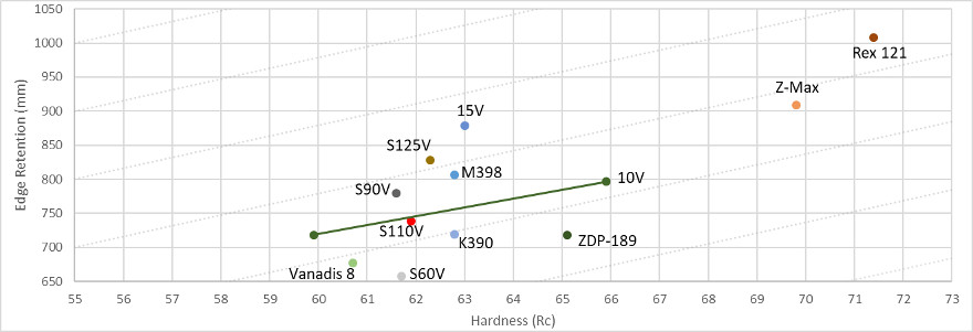

M398 Steel Testing – Edge Retention, Toughness, and More

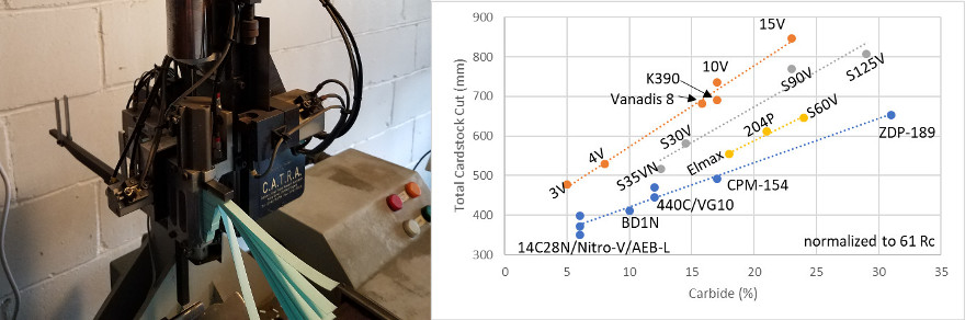

Testing the Edge Retention of 48 Knife Steels

Edge retention testing is continuing, we have now tested 18 different steels, and four of those steels with multiple heat treatments. Come to Patreon if you want updates on testing as it is completed.
