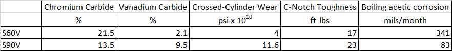

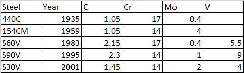

154CM was designed for bearings, and was essentially a modification of 440C by reducing the chromium (Cr) by ~3% and adding 4% molybdenum (Mo). The molybdenum was added so that the bearings could be operated at high temperature, but it was discovered that partially replacing Cr with Mo led to similar corrosion resistance to 440C. S60V, however, was essentially 440C but with 5.5% vanadium added and enough carbon to maintain similar hardness potential. In the development of S90V, the Cr was reduced relative to S60V, dropping from 17% to 14% similar to the modification of 440C to make 154CM. However, the Mo was not increased to compensate. The Cr was reduced for a different reason, however. Chromium and vanadium both compete to form carbides. Carbides are hard particles in steel that add to wear resistance but detract from toughness. With a low Cr (5%) steel like 10V, basically all of the vanadium forms the very hard vanadium carbides (VC) which contribute to wear resistance and edge retention. The chromium also forms some softer chromium carbides but they are dissolved at typical heat treating temperatures. Softer chromium carbides do not contribute as much to wear resistance but they detract just as much (or more) from toughness as vanadium carbides do. Therefore, having only vanadium carbides means a better wear resistance-toughness balance. The higher the chromium content, the less vanadium carbide is formed for a given vanadium content, and more and more chromium carbide is formed. You can read more about carbide types and how elements interact to lead to different amounts in this article on carbides.

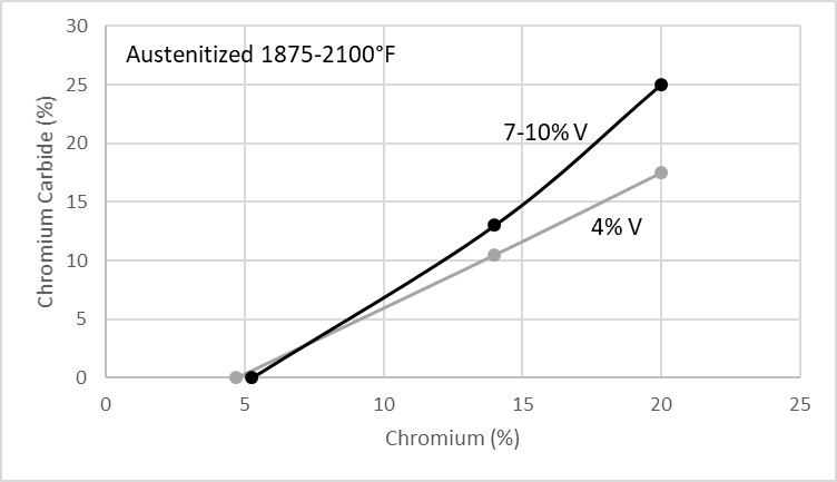

So what they did in the development of S90V was reduce the chromium content by 3% and add a corresponding amount of vanadium while maintaining a similar carbon content. This resulted in a similar amount of carbide, but much more of it is vanadium carbide, which results in higher wear resistance. Vanadium carbides also tend to be smaller (read this article) so having less chromium carbide means better toughness as well. And less chromium carbide means that even though S90V has less chromium, less is tied up in carbides so that the chromium is free in the steel to improve corrosion resistance. See this article to learn about corrosion resistance. Below is a table summarizing the resulting properties including the amount of chromium carbide (M7C3), vanadium carbide (MC), measured toughness (higher is better) wear resistance in a crossed-cylinder wear test (higher is better), and corrosion measured in a 10% boiling acetic acid solution (lower is better):

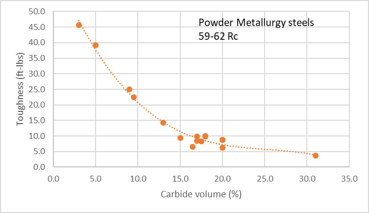

So with all of those lessons learned, it was known that a lower chromium content would allow vanadium to go further in terms of its contribution to wear resistance. Another fact known is that a reduced carbon and vanadium content would lead to a steel that was tougher and easier to grind because of a reduction in overall carbide content. This is why 3% vanadium 3V has much better toughness and grindability than the 10% vanadium 10V, though at the cost of wear resistance. So to design a more balanced steel than S90V with improved toughness and grindability, a reduction in carbon and vanadium was necessary.
Crucible started with 154CM as their basis, replacing 2% Mo with 2% vanadium. However, in testing of that steel Chris Reeve Knives wanted more wear resistance to better differentiate from BG42, leading to an increase in vanadium up to the final 4%. The increase in Mo from 1% in S90V up to 2% in S30V provided an increase in corrosion resistance with the relatively low 14% Cr. Molybdenum improves corrosion resistance, as mentioned earlier in connection with 154CM. Another change to S30V is that an intentional nitrogen addition was made of about 0.2%, which was made to improve corrosion resistance but also means improved hardening when heat treating. You can read more about what nitrogen additions do in this article on nitrogen additions as well as this article on S45VN. As described in the S45VN article, nitrogen also decreases the chromium carbide content while increasing the vanadium carbide content, though I’m not sure that was recognized at the time that S30V was designed.

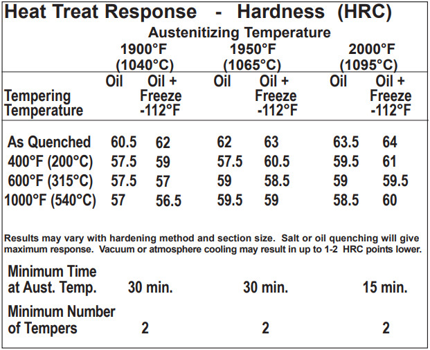

The goal in terms of making a steel “easy to heat treat” was accomplished primarily by ensuring the steel could by austenitized (hardened) by heating to a temperature no higher than 2000°F. Some furnaces are limited to relatively low temperatures, and at the time of the release of S30V, there were many knifemakers with Paragon brand furnaces with a maximum temperature of 2000°F. Another factor with ease in heat treating is how fast the steel must be quenched from high temperature and still achieve full hardness. Molybdenum additions improve “hardenability” so that slower air quenches can be used, so the 2% Mo helped in that regard. As shown in the datasheet, S30V can reach at least 64 Rc when using cold treatments, and can easily be tempered down to the 58-61 Rc range common for many knives.
