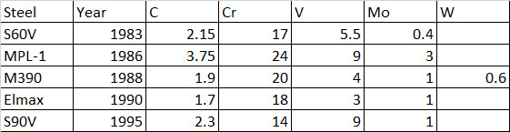

At that time there were several powder metallurgy stainless steels available, both from Crucible and competitors. Crucible’s first PM stainless was S60V (originally 440V) which I wrote about in this article. Crucible then patented a steel with very high wear resistance called MPL-1, the patent for which was submitted in 1986 [2]. Bohler patented M390 steel in 1988. And Uddeholm released Elmax sometime around 1990 [3]. All of these previously released PM stainless steels had high chromium (16-24%) for corrosion resistance in combination with some amount of vanadium for wear resistance. This is perhaps expected as the most common martensitic stainless steel for high wear applications was 440C with ~17% chromium. In fact both S60V and Elmax appear to be modifications of 440C with added vanadium and carbon. Increased amounts of vanadium in powder metallurgy were being used in steels like CPM-10V which achieved better combinations of toughness and wear resistance so this makes sense as the route for designing early powder metallurgy stainless steels. Vanadium carbides are very hard and contribute greatly to wear resistance but are detrimental to toughness in conventionally-produced steels. However, it was discovered that in powder metallurgy steels the carbides are very small and therefore actually are better for toughness than other carbide types.
So where S90V deviated from the previous vanadium-alloyed powder metallurgy stainless steels was the reduction in Cr down to 14%. Why reduce the Cr content and what did it accomplish? One important thing to know is that Crucible at that time used the “crossed-cylinder wear test” to measure the adhesive wear resistance of their steels. In this test a cylinder of the tool steel is worn against a cylinder of tungsten carbide. High vanadium steels like 10V had very high results in the crossed-cylinder wear test so Crucible metallurgists were also trying to get higher values in their stainless steels. In the S90V patent they point out that the major improvement in the design of the steel was improved adhesive wear as measured in the crossed-cylinder wear test.

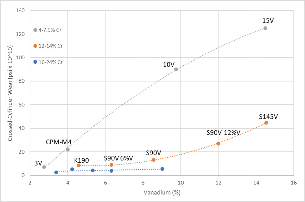

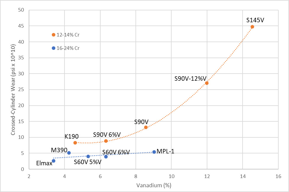

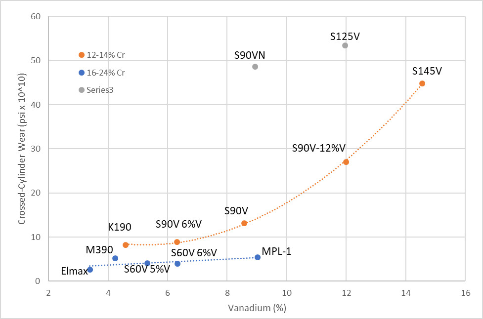

Crossed-Cylinder Wear Test
However, the existing PM stainless steels like S60V, M390, Elmax, and even MPL-1 had very low values in the crossed-cylinder test when compared with 10V. The reason was that the high chromium in the steels would lead to the formation of chromium carbide rather than the high hardness vanadium carbide. The higher the chromium content the less vanadium carbide is formed. Small vanadium carbides are the key to high values in the crossed-cylinder test. You can read more about the decrease in vanadium carbide with chromium content in this article about carbides.
Higher chromium means less vanadium carbide
Higher chromium means more chromium carbide
So Crucible metallurgists discovered that if the chromium content were reduced that more vanadium carbide (and less chromium carbide) would be formed in the steel, and therefore increase the crossed-cylinder wear test results. They compared vanadium content vs wear resistance for a range of steels at different chromium levels and found that a 14% Cr content led to greatly increased performance. (Note: Higher is better).
And if the chromium is reduced further you have non-stainless PM tool steels which have even better adhesive wear resistance.

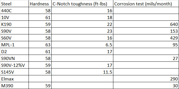

S90V was also found to have improved corrosion resistance and toughness when compared with the earlier S60V. And certainly better toughness than MPL-1. In the chart below higher values mean better toughness, but for corrosion resistance lower is better.

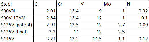

Other Steel Designs Explored in the Patent
Note: The ~0.1% nitrogen is the “baseline” nitrogen that the steel picks up from nitrogen atomization and the atmosphere. The average nitrogen content in the commercial S125V is not public information.
High Nitrogen S90V
Interestingly, the Crucible metallurgists also looked at partial replacements of carbon with nitrogen in amounts of 0.32 or 0.46%. The authors of the patent stated that higher nitrogen contents were explored in an attempt to improve corrosion resistance without affecting wear resistance. And it appears that they were successful in doing that (see the previous chart for the grade marked S90VN for improvement in corrosion resistance). And interestingly the crossed-cylinder wear test also showed markedly improved results in the S90VN with 0.32% nitrogen and 2.01% carbon. This may be from nitrogen promoting the formation of vanadium carbide rather than chromium carbide as I wrote about in this article on S45VN. So I’m not sure why they didn’t further pursue a nitrogen-modified version since the stated improvement in the patent was in the area of crossed-cylinder wear. I was able to speak to one of the developers of S90V, Dr. Ken Pinnow, and he said that the benefit to using nitrogen wasn’t great enough and so they used the simpler design instead. It wasn’t until S30V a few years later than an intentional addition of 0.2% nitrogen was used in a commercial product. There was definitely some scatter in the crossed-cylinder results (a slightly different steel or heat treatment could lead to significantly different values) so maybe the difference between S90V and S90VN was not as big as it appears.
S125V and S145V
They also looked at yet higher vanadium contents than S90V, including steels I have labeled S90V-12%V, S125V, and S145V. They looked at a few different variants of the 12% vanadium steel, including one with 1% Mo and two with 2.7% Mo (with two different carbon levels). The 12% vanadium version was not immediately sold commercially but eventually we got a version of it with 2.5% Mo sometime around 2005 called S125V [4]. The final version also had even higher carbon than either version that was shown in the patent (3.3 vs 2.95% carbon). I don’t know why they went higher carbon because in the patent they show higher hardness than S90V at the lower carbon content. Reduced carbon would mean better corrosion resistance and toughness. However, the hardness of S90V and S125V is not incredibly far apart as will be seen in the hardness tests later in this article so perhaps modifications were necessary. Apparently they went with the 2.5% Mo version because it had better wear resistance as shown in the chart above, and a bit better corrosion resistance. I spoke to Al Kajinic who formerly worked for Crucible Research and he said that he doesn’t remember any details but that he and Maria Sawford would have decided on the final composition of S125V. Kajinic also patented S110V a few years later.
The 14.5% V version I have called S145V has never been commercially produced as far as I know.

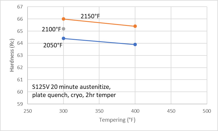

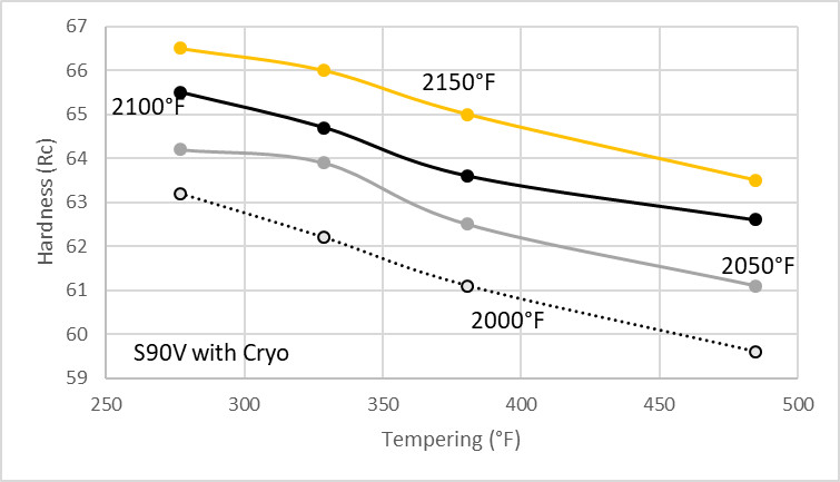

S90V and S125V are capable of rather high hardness, approximately 66 Rc given an appropriate heat treatment. The two steels have relatively similar “as-quenched” hardness or with a low temper of 300°F, though S125V seems to have somewhat better tempering resistance (hardness is higher with a 400°F temper). The following hardness values came from heat treating small coupons with a 20 minute austenitize, plate quench, liquid nitrogen cryo, and tempering twice for two hours each time.
An S90V CATRA knife I heat treated with 2050-400 resulted in 61.7 Rc, within range of the above values. However, the toughness specimens measured about 1 Rc lower. Perhaps the quenching rate was somewhat slower because of the larger volume of steel. A CATRA knife and toughness specimens of S125V were about 0.5 Rc higher than the S90V. The S90V datasheet recommends austenitizing 2100-2150°F; however, I think it is clear that lower austenitizing temperatures can yield plenty of hardness, at least with cryogenic processing. A heat treatment using 2050-400 results in pretty balanced properties for either S90V or S125V.

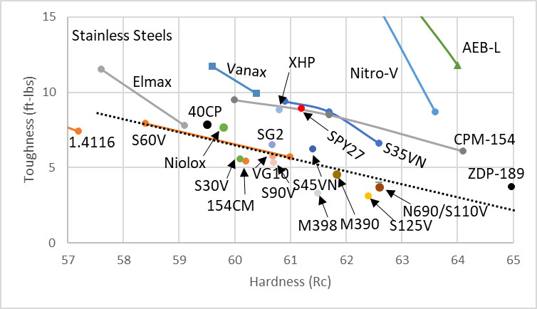

We have tested S90V and S125V toughness with our standard test using 1/4 size unnotched charpy specimens. The specifications of these samples can be viewed here. S90V has similar toughness to other PM stainless steels like S60V, S30V, and M390. Despite Crucible finding that S90V toughness was superior to S60V I found them to be very close. I have also shown a dotted line to indicate the approximate effect of hardness on toughness to more easily compare between steels. S125V is another notch below those other steels because of its greater volume of carbide. The overall difference in terms of ft-lbs is relatively small, but differences are more significant at low values. In other words, 5 vs 2.5 ft-lbs is roughly as significant as 10 vs 5 ft-lbs. None of these powder metallurgy stainless steels is particularly tough but there are clear tiers, with S125V and M398 at the bottom, then the steels along the line with S90V and S60V, then steels like S35VN, CPM-154, XHP, and Vanax. However, non-stainless steels alloyed with high vanadium contents like 10V and Vanadis 8 have toughness similar or greater than S35VN while also having edge retention similar to S90V.
The edge retention of S90V and S125V are the highest of any stainless knife steels that we have tested with CATRA so far. The high vanadium and 14% chromium results in very high wear resistance which in turn leads to excellent performance in edge wear tests. This chart also has dotted lines which indicate the approximate effect of hardness for comparing between different steels.
Toughness and edge retention are two major properties that conflict with each other in knife steel. Increasing one tends to decrease the other. So I like to plot the two properties against each other to get an idea of the performance category where a steel sits. For this chart I have adjusted the CATRA value based same hardness as the toughness coupon for each steel, as predicting the effect of hardness on edge retention is easier than with toughness. You can see that S90V has a very good toughness-edge retention balance compared to other stainless steels at a similar edge retention range. It has both higher edge retention and toughness than M390, ZDP-189, and S110V, for example. This is expected based on our discussion above where S90V had similar toughness to many steels with lower edge retention. The higher proportion of vanadium carbide gives S90V a better property balance. S125V has higher edge retention and lower toughness, of course.

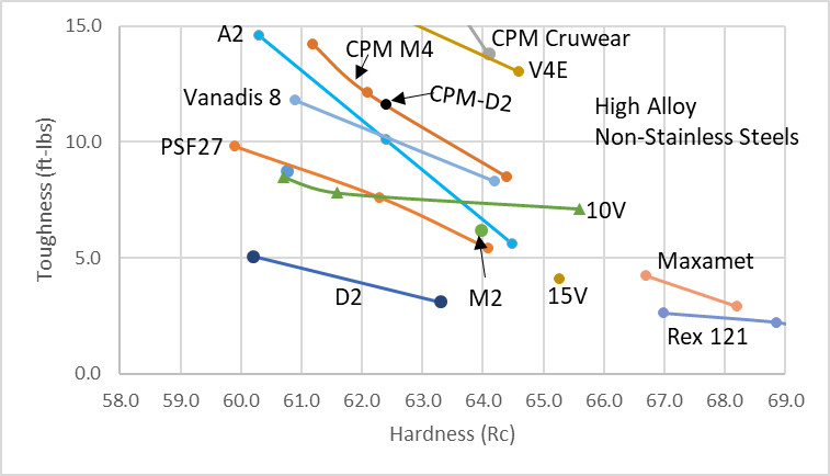

You can see these against the superior properties of the non-stainless vanadium-alloyed PM steels in the following chart:

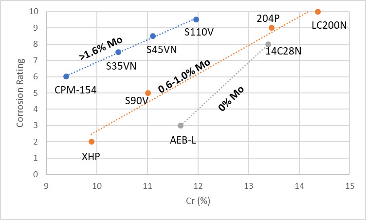

I previously tested the corrosion resistance of S90V and it was basically middle of the road. I have not tested S125V; it has about 10.3% Cr in solution along with 1.6% Mo. So it may have slightly better corrosion resistance than S90V, in a similar range to S30V/S35VN. You can read more about corrosion testing and predicting corrosion resistance based on composition in this article. S90V has lower corrosion resistance than S110V and 204P (M390), though it is adequate for most knives.
