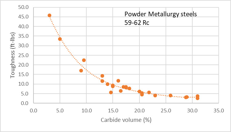

One set of properties which are typically opposed to each other is toughness and wear resistance. Wear resistance is controlled by the hardness of the steel, hardness of carbides in the steel, and how much carbide is present. Higher hardness, higher hardness carbides, and a larger amount of carbide all improves wear resistance. Higher wear resistance means that edge wear occurs more slowly providing better edge retention. Here is a chart summarizing the hardness of different carbide types:
Vanadium carbides are among the hardest of all carbide types which is why high vanadium steels often have the best wear resistance and slicing edge retention. For example, in CATRA edge retention testing of a range of steels, those with chromium carbide had significantly lower edge retention for a given amount of carbide than those with vanadium carbides. A steel with ~17% chromium carbide (blue circles below) resulted in about 500 mm of cardstock cut in the standard CATRA test, while the same amount of vanadium carbide resulted in about 700 mm (orange circles). Read more about edge retention testing in this article.
In terms of toughness, however, more carbide is a bad thing. Carbides are hard and brittle and make cracks initiate more easily. This leads to chipping to occur more easily, broken tips of knives, etc. Larger carbides are also worse than smaller carbides, which is why powder metallurgy steels have greater toughness even with the same composition. Below I have a comparison between different PM steels at different carbide contents. And also a chart comparing standard D2 (very large carbides), PSF-27 (D2 with medium carbides), and CPM-D2 (D2 with relatively fine carbides). Read about these different D2 steels in this article. The two charts use a 1/4 size unnotched charpy specimen, the specifications of which are here.
So we have a fundamental dichotomy between wear resistance and toughness. More carbide means better wear resistance but also lower toughness. However, the hardness of carbide does not generally matter for toughness. Therefore, if we use harder carbides (like vanadium carbide) and keep them small we get more wear resistance for a given amount of carbide, and therefore higher wear resistance for a given level of toughness. So the steels with the best combination of toughness and wear resistance are typically powder metallurgy steels (keep the carbides small) that are alloyed to have primarily vanadium carbides. Steels like CPM-1V, CPM-3V, Vanadis 4 Extra, CPM-4V, CPM-10V, K390, and Vanadis 8. Read about how powder metallurgy works in this article.

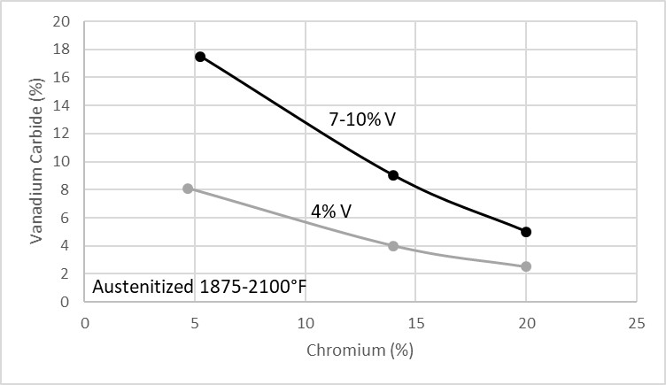

Why Stainless Steels are Worse
So when we add in a bunch of chromium it makes it more difficult to ensure that all of the carbides are vanadium carbides. Learn more about this in an article about carbide types in knife steel. The high Cr leads to the formation of chromium carbides instead, which are softer than vanadium carbide and lead to a poorer combination of toughness and wear resistance. Below shows a chart with the effect of chromium additions on vanadium-alloyed steels. Higher chromium means less vanadium carbide for a given amount of vanadium, and of course higher chromium means more chromium carbide.

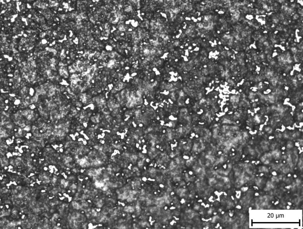

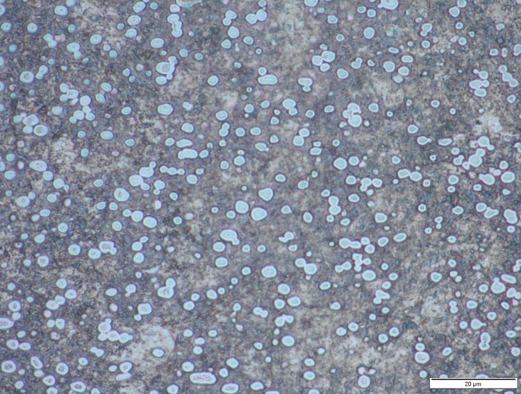

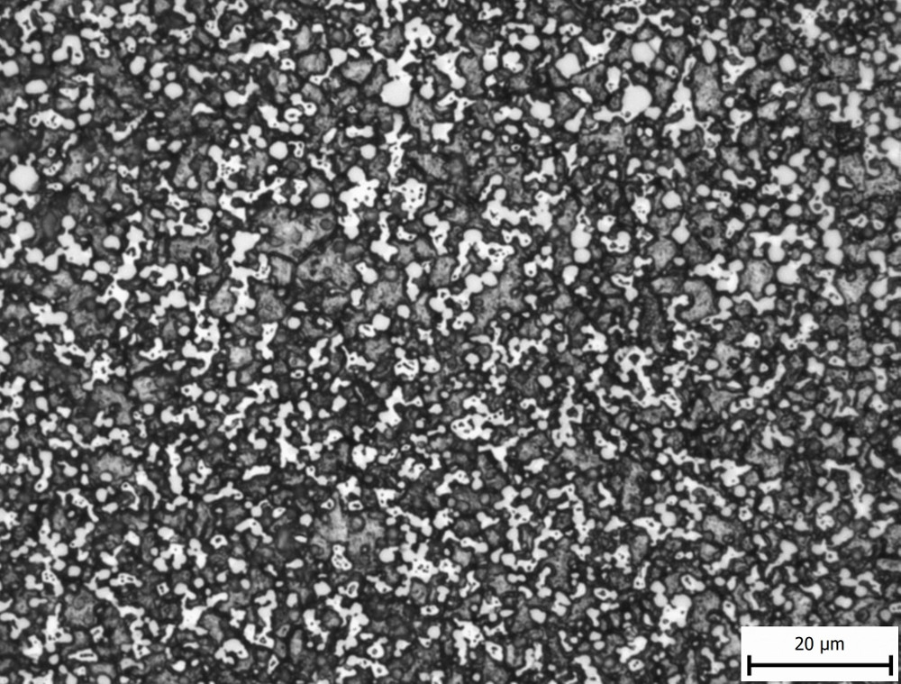

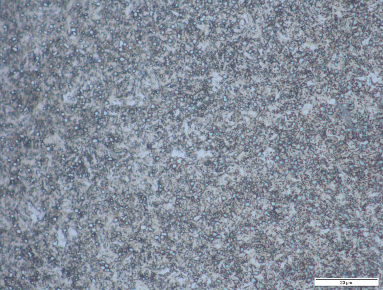

Another issue with chromium carbides is that they are larger in powder metallurgy steels than vanadium carbides. As explained before, larger carbides leads to less toughness. With powder metallurgy, the carbide size starts out very small but they grow through a natural process calls Ostwald ripening. The higher the temperature, the more rapid the growth of the carbides is. During the powder consolidation process (hot isostatic pressing or HIP) and the forging and rolling process, the steel is at high temperature where the carbides slowly grow. Chromium carbides have lower stability than vanadium carbides which leads to more rapid coarsening. This is why CPM-D2 (chromium carbide) has larger carbides than Vanadis 8 (vanadium carbides) even though the two have a similar amount of carbide, as shown below. This is not a difference from “3rd generation powder metallurgy technology” as similar steels produced with older PM facilities have a similar carbide size to Vanadis 8.
CPM-D2
Vanadis 8

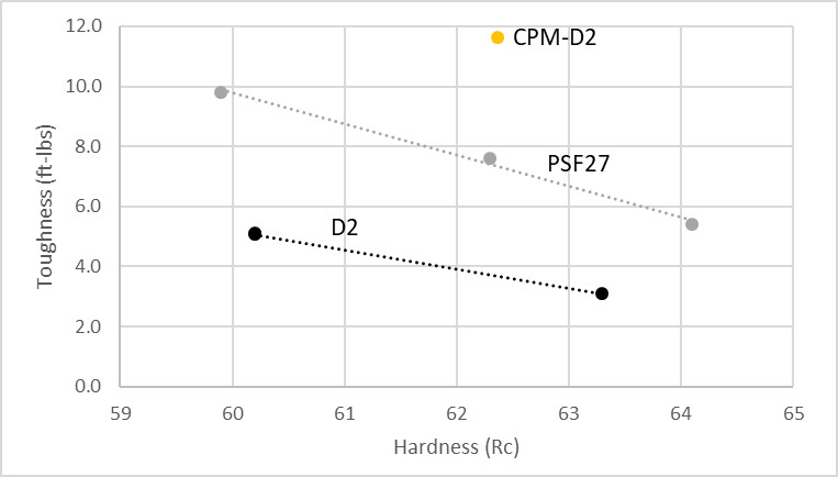

Add more carbon and vanadium to stainless steels (more hard carbides) and you can certainly get more edge retention at the cost of a drop in toughness. Here is a range of different powder metallurgy stainless steels where you can see the dichotomy:
However, the properties of the non-stainless PM steels are significantly better, as can be seen in the following chart. The toughness of the non-stainless PM steels are essentially double for a given level of edge retention. Which means that the edges are less likely to chip, higher hardness levels can be used without reducing toughness, and/or edges can be ground thinner for better cutting performance due to higher toughness and hardness.

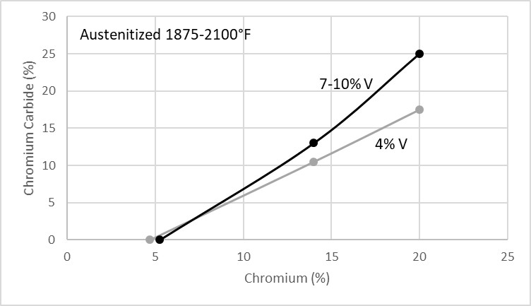

The issue is that all of the PM stainless steels have a significant amount of chromium carbide, at least 9-10%, and at least 15% total carbide. As shown in the previous charts, having 15%+ carbide means toughness will be unlikely to be higher than 10 ft-lbs in the toughness test that I use. The high total carbide content and the presence of chromium carbides which reduce the toughness-edge retention balance relative to all vanadium carbide means that stainless PM steels are not as good as some non-stainless PM steels. Non-stainless PM steels like 3V, CPM-CruWear, Vanadis 4 Extra, and CPM-M4 have a very attractive combination of properties due to their high toughness for a given level of edge retention. If we could have stainless steels with a similar property combination along with also being stainless we would have a true breakthrough in stainless knife steel performance.
What Can be Done?

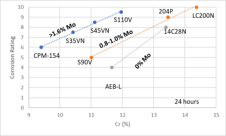

One way to improve properties is to reduce the amount of chromium so that chromium carbide is reduced and vanadium carbide is formed instead. This doesn’t necessarily mean a reduction in the level of corrosion resistance. S110V with 15.25% chromium has a similar level of corrosion resistance to M390 with 20% Cr because the total composition matters, not just Cr. Most knife steels have 10-13.5% Cr “in solution” contributing to corrosion resistance. So M390 with 20% Cr only has around 13% in solution with the rest being tied up in carbides. These facts were used in the design of 14% Cr S90V back in 1995 to improve the properties of vanadium-alloyed powder metallurgy steels when compared with earlier steels with 16-20% Cr. This base 14% Cr content was also used in the design of S30V, S35VN, and S125V. Another aspect that helps is the use of Mo alloying which improves corrosion resistance for a given level of chromium, which is why S30V, S35VN, S125V, S110V, and S45VN have 2% or more Mo. S35VN has superior corrosion resistance to S90V despite both having 14% Cr in part because S35VN has higher Mo.
Chromium and molybdenum in solution vs corrosion testing (higher is better)

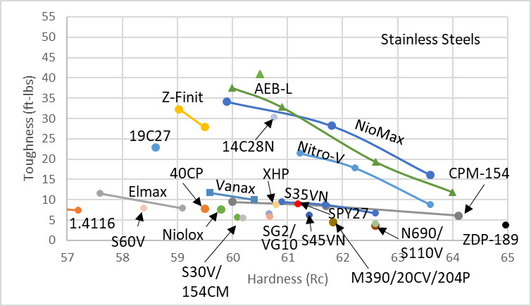

Non-PM Stainless Steel Design

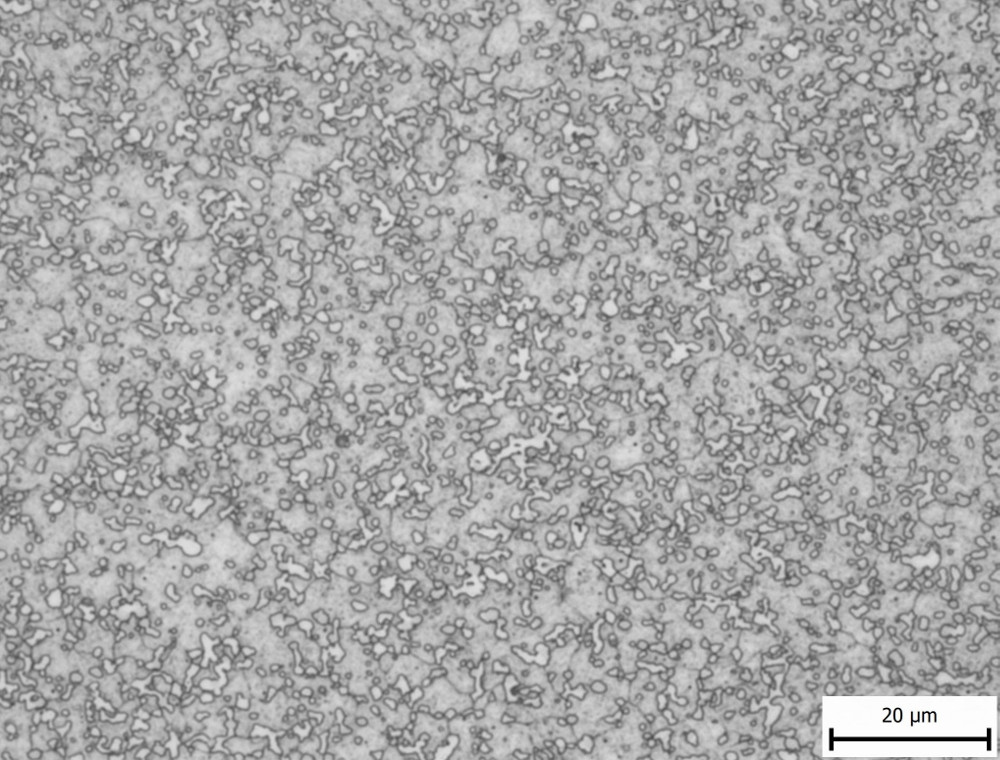

Another way to design stainless steels is to keep the carbide content very low so that the chromium carbides remain small and toughness is high. The best examples of this approach are AEB-L, 12C27, and 14C28N. These steels have lower wear resistance and edge retention than the PM stainless steels but also significantly better toughness and a very fine microstructure. The metallurgists accomplished this by carefully balancing the carbon and chromium content so that high hardness and corrosion resistance could be obtained without forming large amounts of chromium carbide. I wrote about the design of AEB-L in this article. See below for how much finer the microstructure of AEB-L is than even PM stainless steels and how much better its toughness is.
AEB-L
CPM-154
Steels like AEB-L and 14C28N have relatively low edge retention but still better than low alloy steels like 52100 and 1095 because the chromium carbides are harder than the iron carbide (cementite) in the low alloy steels. So in this case the stainless steels actually have a better property balance than the “carbon steel.” Again this is why “stainless vs carbon steel” is an over-simplified debate. It all matters what non-stainless steels and what stainless steels you are referring to and in what property category.

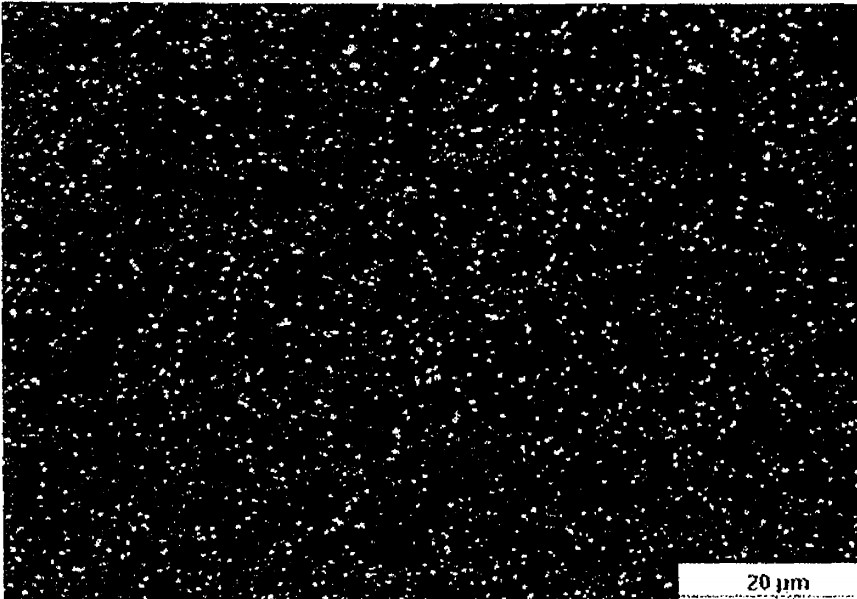

Because niobium carbides are more stable than vanadium carbides, they also coarsen more slowly during HIP and hot rolling, etc. Meaning the niobium carbides are even smaller than vanadium carbides in the final steel. This was seen in the development of a modified version of CPM-3V using primarily niobium alloying rather than vanadium. It was found that the carbide size was reduced and the toughness improved in the niobium version. This modified 3V has never been commercially produced.
3V Mod alloyed with niobium
Standard 3V with vanadium alloying
