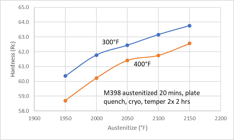

I tested the hardness of M398 by austenitizing for 20 minutes followed by a plate quench, cryo, and temper twice for two hours each time. My hardness values look very close to M390 despite Bohler claiming an increase in hardness. Some knifemakers who have heat treated M398 have achieved about 1-2 Rc higher than me so I’m not sure why my values were lower. Knifemaker Roman Kasé tells me that he was only able to get over 64 Rc when using an oil quench. This would indicate that the “hardenability” of M398 is relatively poor, meaning a plate quench is not enough to achieve maximum hardness. It could also be that my M398 is somewhat low in carbon or has some other small variation in composition.

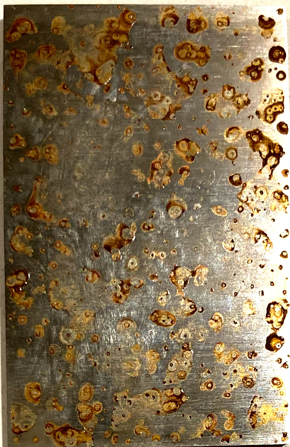

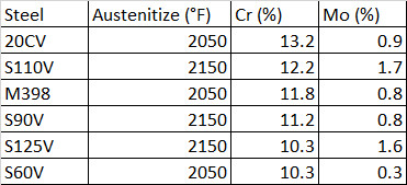

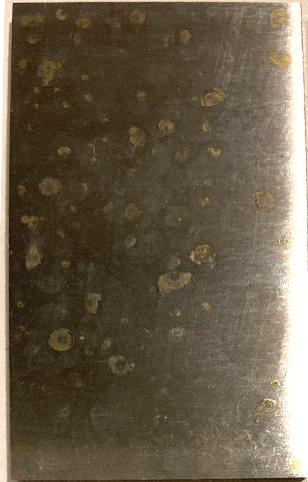

Corrosion resistance was tested on M398 using the test parameters previously described in this article. The steel was heat treated at 2050°F and tempered at 400°F. The 1 x 1.5 inch specimens were finished to 400 grit, sprayed with 1% saltwater every 8 hours, rinsing the specimens with water each time, and I photographed them after 24 hours. I compared with 20CV (same as M390), S60V, ZDP-189, S90V, S125V, and S110V to compare with other stainless steels with high edge retention. ZDP-189 was not tested as I already found it to have very poor corrosion resistance. The table below shows the austenitizing temperature that was used because that controls how much chromium carbide is dissolved, putting chromium into solution to promote corrosion resistance. I then have the Thermo-Calc estimated chromium and molybdenum in solution. Thermo-Calc expects the chromium in solution to be reduced in M398 relative to 20CV and M390. However, 20CV, S110V, and M398 had roughly comparable corrosion resistance in this test. S90V, S125V, and S60V were clearly worse. Both 20CV and S110V have very good corrosion resistance so this tells us that M398 is also very good.
20CV (same as M390)
S110V
M398
S90V
S125V
S60V
