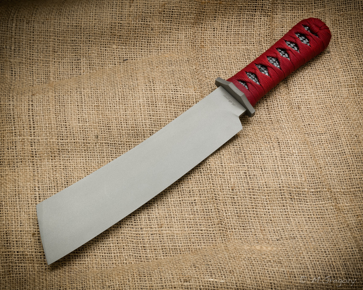

Matthew Gregory chopper in CPM-MagnaCut

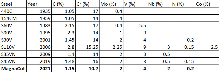

Early powder metallurgy stainless steels used high chromium content (17-20%) for corrosion resistance in combination with vanadium for wear resistance. These included steels like S60V, Elmax, and M390. However, these steels have relatively low toughness from the relatively coarse microstructure that results from a large percentage of chromium carbides. Non-stainless powder metallurgy steels like CPM-4V, CPM-3V, and Vanadis 8 have smaller vanadium carbides only which give them a superior combination of toughness and wear resistance. The small, but very hard, vanadium carbides, offer superior wear resistance for a given amount of carbide. And less carbide means higher toughness. Crucible later developed steels like S90V and S30V which had less chromium (14%) for less chromium carbide which improved properties relative to the higher chromium stainless steels. The corrosion resistance was not necessarily reduced when compared with the higher chromium steels because only so much of the chromium is “in solution” to contribute to corrosion resistance. Somewhere in the range of 10-13% in solution is common, with the rest tied up in carbides. Which means a stainless steel can be developed with only about 10% chromium as long as all of it is in solution after heat treatment. Actually, it could be a little bit less because some of the steel is carbide. If the steel has 10% carbide, that leaves 90% matrix, so the 10% chromium could end up being as high as 11.1% in solution (10 divided by 0.9).

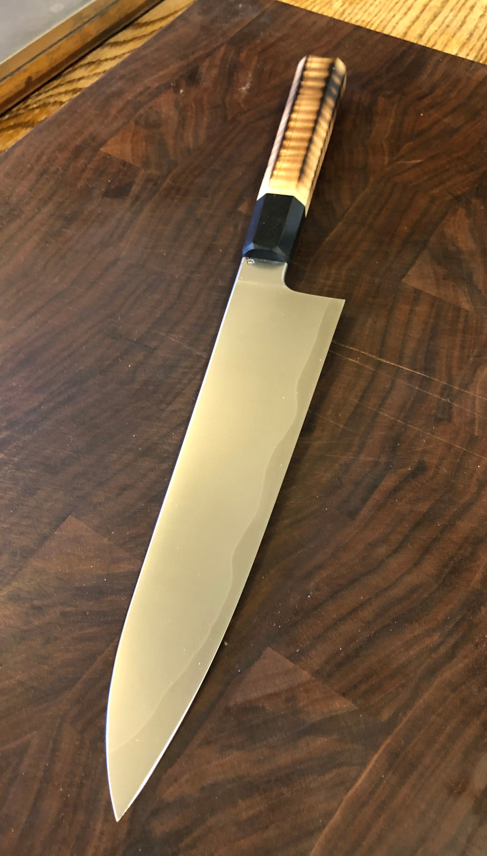

Devin Thomas chef’s knife in stainless san-mai with CPM-MagnaCut core steel. Devin says this is his new favorite kitchen knife steel.
So if the properties were improved by reducing the chromium content down to 14%, why couldn’t they be improved by reducing the chromium content further? Is it possible to balance the composition to ensure that any chromium carbides are dissolved during heat treating so that we get a microstructure of only small hard carbides rather than the larger, softer chromium carbides? Reducing the chromium content of a steel like S30V would result in less chromium in solution and lower corrosion resistance but not much less chromium carbide. The carbon content would also have to be reduced so that chromium carbide would dissolve at a reasonable temperature. But in those cases the steel may not have enough hardness.
I found that if I kept the carbon content into a relatively narrow range, a sweet spot would be found where there would be enough carbon (for hardness) and chromium (for corrosion resistance) in solution while also having a combination of hard vanadium and niobium carbides for the optimal balance of wear resistance and toughness. At least, according to the software. There are never any guarantees that software is going to be right. You can read more about my stainless steel design ideas in this article.

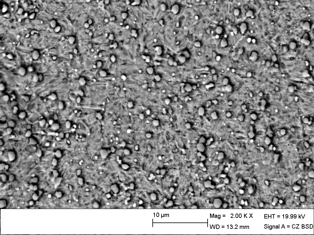

The carbide structure of MagnaCut is much finer than the common powder metallurgy stainless steels such as CPM-154, M390, Elmax, S35VN, etc. The only stainless PM steel I have imaged which is competitive in terms of carbide/nitride size is Vanax. MagnaCut is even somewhat finer than CPM-4V and Vanadis 4 Extra, the non-stainless steels that MagnaCut was modeled after. This is an excellent result and should lead to excellent properties. Compare with more steels with this article on micrographs of knife steels.
MagnaCut
CPM-154
M390
Elmax
S30V
Vanax
CPM-4V
I also imaged the steel with SEM using backscatter imaging to see if I could differentiate between different carbide types. I wasn’t sure if there would be separate vanadium-rich and niobium-rich carbides or if it would all be a complex niobium-vanadium carbide. The backscatter imaging confirms that there are both types. Niobium carbides are white and the vanadium carbides are grey in the image below. The niobium carbides are finer which brings down the average carbide size. Also there is a smaller amount of vanadium carbide when compared with 4V (more vanadium carbide means a larger average size for the vanadium carbides). So the partial replacement of vanadium carbide with niobium carbide leads to a smaller average carbide size vs 4V even though the overall volume of carbide is similar. Nitrogen can also slow down coarsening of carbide in PM steels but I don’t know for sure if the 0.2% is enough to make a measurable difference. Regardless, the carbide structure is excellent.

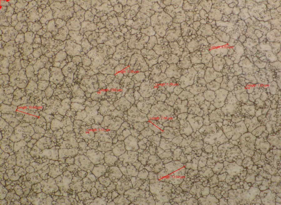

Grain Size
I got some decent images of the grain boundaries of MagnaCut from Bob Skibitski at Crucible. Typically we don’t need to worry too much about the grain size of high alloy steels because they have plenty of carbides that “pin” the grain boundaries, preventing excess grain growth. And revealing grain boundaries with etching can be surprisingly difficult. However, austenitizing up to 2200°F is recommended in the datasheet so I was curious if it was possible for the grains to grow at those temperatures. Metallography after a 2150°F austenitize confirmed the same fine grain size as at lower austenitizing temperatures. The average grain diameter is about 5.5 microns, for an ASTM grain size of about 12 (bigger number is better for ASTM grain size). This is in the “ultra fine” range for grain size. The grain size was not significantly different with a 2050°F austenitize. I also looked at the fracture grain appearance for 2200°F specimens and it had a completely smooth appearance, indicating ASTM 10 or better. This may be helped by the decreasing hold time I recommend at higher temperatures, but either way the grain size is very fine across the recommendations.
Grain boundaries visible in a 2150°F heat treated MagnaCut coupon. A few of the largest grains are measured with red lines. The average grain size is in the “ultra fine” range.

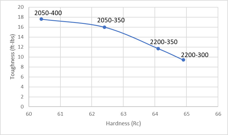

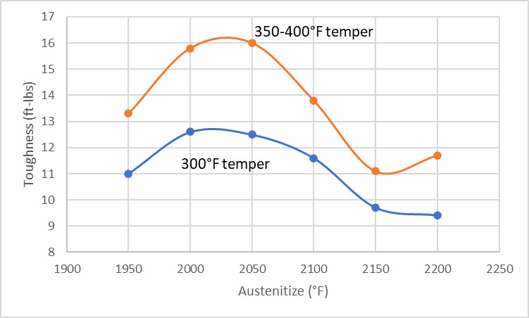

Brad at Peters’ Heat Treating tested a series of coupons using their vacuum furnaces. Larger heat treating operations used by knife companies and some knifemakers, generally use vacuum furnaces. And the heat treatment response is somewhat different than with plate quenching or oil quenching in a home shop. So these hardness values are important to heat treating companies. Peters’ used a 2 bar gas quench with these coupons and performed heat treatments both with and without a cryo heat treatment. The hardness values are also about 0.5-1 Rc lower than the oil or plate quench coupons. One point lower in hardness vs rapidly quenched coupons is promising, demonstrating excellent “hardenability” so that properties are consistent across different heat treating methods, whether industrial vacuum furnaces or plate/oil quenching individual blanks.

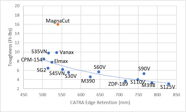

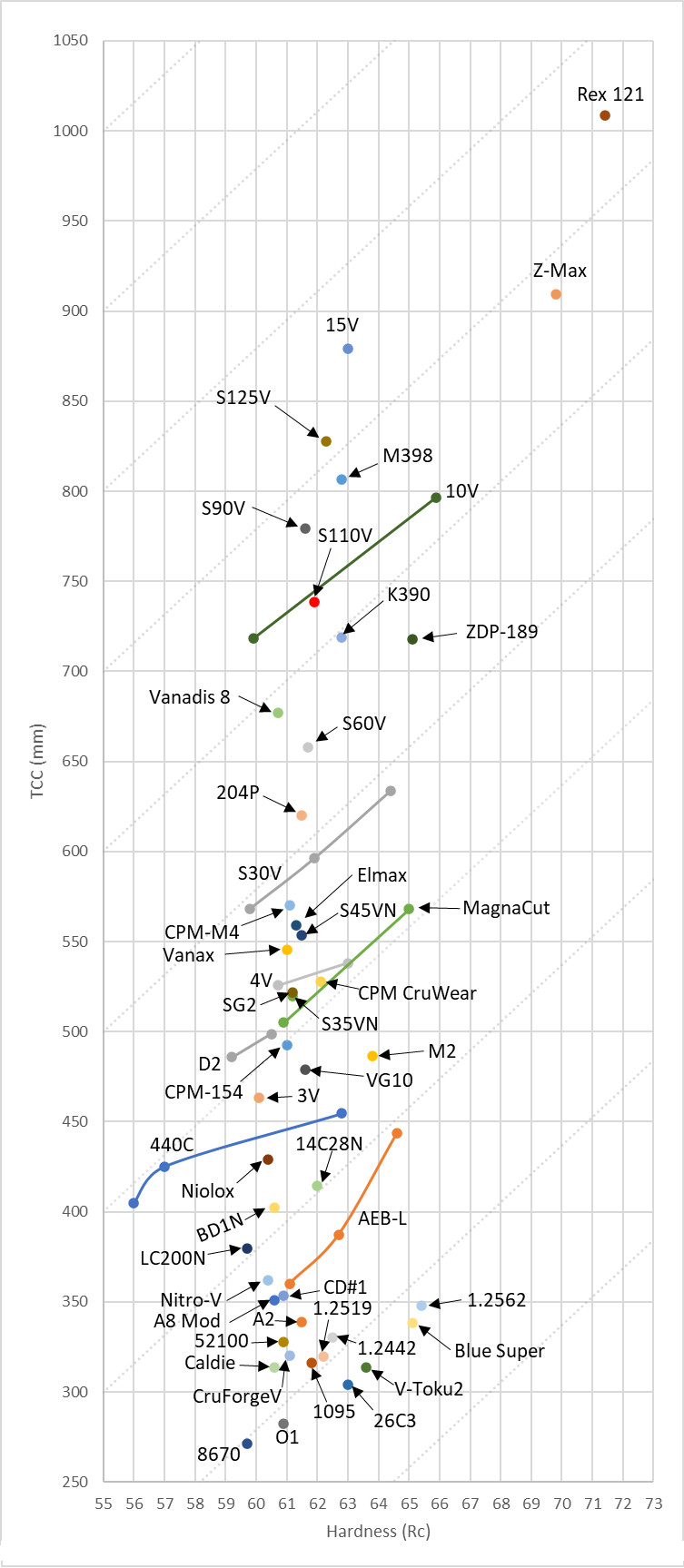

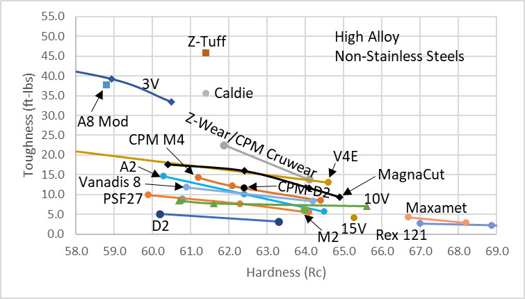

The main goal of this steel design was to have much greater toughness than previous powder metallurgy stainless steels. I also tested a range of heat treatment variables to narrow down the optimal toughness. Peak toughness was found with austenitizing temperatures of 2000-2050°F, though toughness was similar for the two while hardness was higher with 2050°F. Therefore, 2050°F had a superior toughness-hardness balance. So 2050°F is my general recommendation for heat treating in terms of optimal toughness.
The toughness for 350°F tempering was higher than 300°F, though at lower hardness, of course. Toughness at 400°F was very similar to 350°F, occasionally a bit higher but they were close enough that sometimes an individual result for 350°F could be higher here or there. The potential improvement in toughness by tempering higher than 350°F doesn’t seem worth it for the drop in hardness that you get. So a 350°F temper is also my recommendation for best balance of properties.
Plotting out the best hardness-toughness combinations you get the following plot where you can pick your target hardness for strength and edge retention and select the best heat treatment to achieve it. However, using other combinations of austenitizing and tempering will not lead to much worse toughness for a given hardness.
In terms of comparisons with other steels, MagnaCut looks very similar to CPM-4V and Vanadis 4 Extra as was expected (labeled V4E with a tan line on the non-stainless chart). This is even better than non-stainless steels that are well regarded in terms of toughness such as CPM-M4 and A2. And the steel did significantly better than the common powder metallurgy stainless steels such as 20CV, M390, S30V, S35VN, CPM-154, S90V, etc. It is not as tough as a steel like AEB-L at 61 Rc because AEB-L has less carbide and therefore higher toughness and less wear resistance. However, somewhat surprisingly, MagnaCut matches the toughness of AEB-L at high hardness. At maximum hardness (~65 Rc), MagnaCut matches the toughness of the best PM stainless steels when they are at only 60-61 Rc, like S35VN and Vanax. And significantly better toughness than steels like M390 and S30V at their typical hardness levels. This means that intriguing combinations of strength/hardness and toughness are possible vs those stainless PM steels.

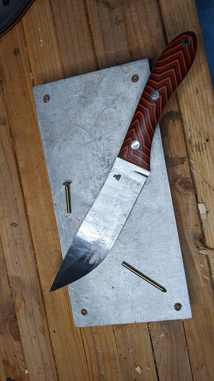

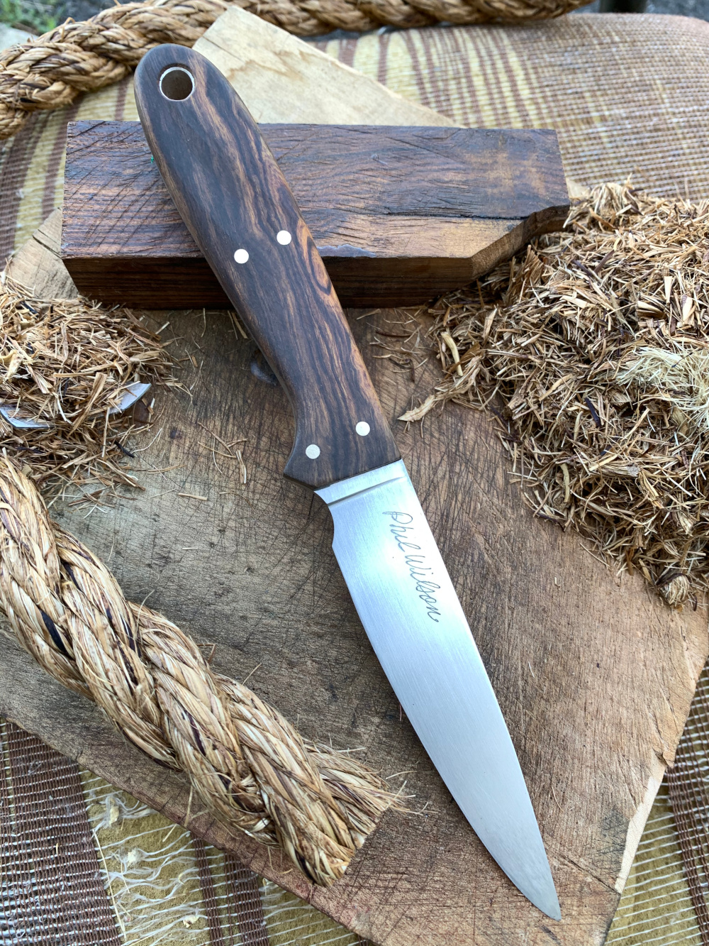

Knifemakers that have used MagnaCut have also reported excellent toughness thus far. Phil Wilson put the steel through his battery of cutting tests designed to put significant force on the edge, cutting through increasingly harder materials, and twisting out of the cuts. The knife made it through seasoned fir and deer antler, though it saw some mild chipping and rolling with bocote, a very hard wood. This behavior was also seen when he tested CPM 4V. You can see an example of the way he tests (with different knives) in the video below. He tests cutting a couple different woods at different points in the video, though the first test with bocote on a CPM-154 knife starts around 10:55.
Big Chris chopped through a 2×4 with a knife with “near chef knife” edge geometry, which was a very tough test when compared with heavier choppers. He chopped through four 2×4’s without any loss of sharpness, as it was still cleanly slicing through newspaper afterward.
Shawn compared a knife head-to-head with an ESEE 6, a knife known for its excellent toughness, made in 1095 steel. In chopping and batoning of wood both knives performed well with no loss in sharpness. The big difference came in the nail chop test where the 1095 had significant deformation; a typical resharpening was unable to take the edge back. Significant edge repair is necessary. However, the MagnaCut knife had only minor edge damage and was back to shaving sharp quickly.

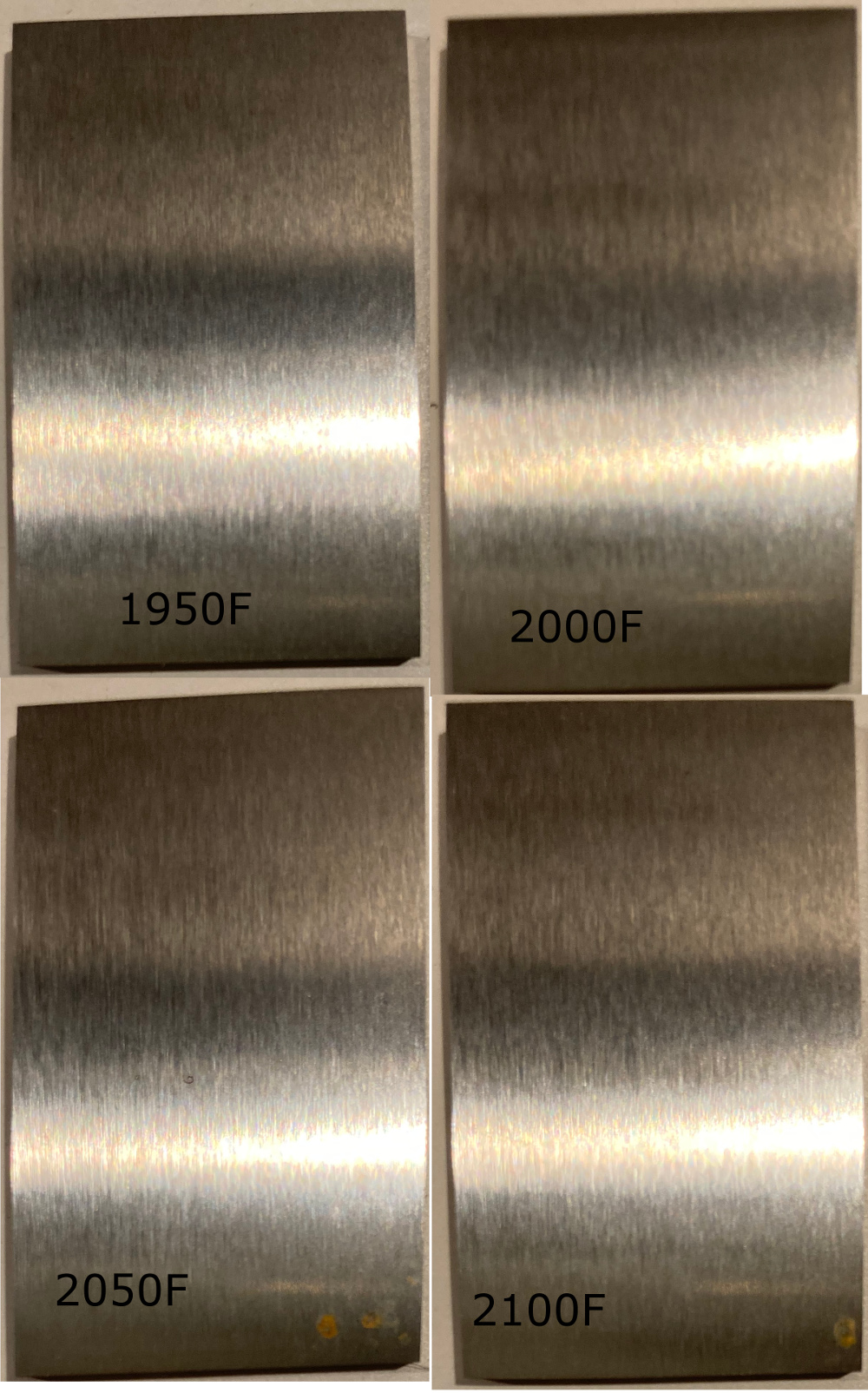

The biggest surprise in testing of MagnaCut was how good its corrosion resistance is. It was expected to have corrosion resistance in between S35VN and S45VN, “good” or even “great” but not spectacular. However, the corrosion resistance ended up being even better than 20CV and just under stellar steels like Vanax or LC200N. With my standard 1% saltwater test, there was no corrosion visible on the steel after 72 hours, while a couple small spots were visible on 20CV and significant rusting on everything else but Vanax. MagnaCut is listed as “new steel” in the image below.
The test above used a 2100°F heat treatment. To see how the steel compared to Vanax and to test the effect of heat treating I also did a range of coupons with austenitizing of 1950, 2000, 2050, and 2100°F. Lower austenitizing temperatures typically lead to slightly reduced corrosion resistance so I wanted to see if there was a big dropoff. In the retest I used 3.5% saltwater for 72 hours, which will rust just about anything outside of Vanax or LC200N. The 1950 and 2000°F samples showed no rust spots, while the 2050 and 2100°F had a couple very small rust spots. This is probably due to inconsistent finishing in the corners (notice the location of the rust spots), or perhaps some minor contamination of iron particles there. There is no reason for those samples to have lower corrosion resistance compared to the 1950 and 2000. So it seems the steel is on the border of being a “saltwater” steel but not quite there I think. It could be used in knives that see occasional saltwater exposure but is not really for diving knives. This is excellent corrosion resistance for general purpose knives.
The surprisingly excellent corrosion resistance of MagnaCut is due to the lack of chromium carbides when compared with other stainless steels. The chromium carbide leads to locally lean regions of chromium surrounding the carbides, as the carbides form by taking chromium out of the surrounding matrix. I first saw this in testing of 420 stainless, which did better than expected for corrosion resistance which is because of the lack of chromium carbides in that steel as well. In low carbon stainless steels they go to great lengths to eliminate chromium carbide to improve corrosion resistance. Typically this isn’t something that stainless tool steel developers talk about because the chromium carbides are generally seen as unavoidable. Removing chromium carbides in MagnaCut led to an improvement in corrosion resistance that makes sense in retrospect but was a surprise when I first tested it.
Shawn Houston told me that MagnaCut had no rust issues when wet grinding, while ZDP-189 and AEB-L have rusted on him if not being very careful. Big Chris also reported in grinding a CPM-4V knife that it was rusting while MagnaCut wasn’t, as expected based on 4V being non-stainless. If I receive any other reports of corrosion testing I will update this article to include them.
Recommended Heat Treatment
From the above experiments the “general recommendation” for heat treatment is 2050°F austenitize, plate/oil quench, and 2×2 hour 350°F temper. The hardness is somewhat higher if a cryo step is added after the quench. A home freezer can also be used for a small improvement in hardness, but only if the steel is placed directly into the freezer after quenching. Don’t temper first. Don’t measure the hardness before going into the freezer; you don’t need to know what the hardness is before and after. The 2050-350 heat treatment results in around 61-62.5 Rc and offers balanced properties including good edge retention, toughness, and corrosion resistance. Higher hardness can be achieved with increased austenitizing temperature and/or decreased tempering temperature. Higher hardness can be used when maximum strength is desired for improved stability and edge retention in fine cutting knives. For example, many Japanese kitchen knives are in the range of 62-64 Rc and MagnaCut would be very well suited to that hardness range for those types of knives.

Yes, you are on the right track but the first step to grain refinement is to revise the industry standard heat treating programs. I’m sorry but there is no nice way to say this: The standard protocol for heat treating is wrong in some areas. The normalizing temps are too low..the hardening temps are too high..and the quenches are WAY too slow. If I had a client that wanted large grain structure, lots of stabilized retained austenite, plate martensite and a brittle blade, I would use the standard heat treating programs.
Normalizing temps are calculated using the Thermo- Calc program to determine when Cementite (iron carbides) is fully dissolved. It looks good on paper but the temps to fully dissolve cementite in the real world are much higher. With low normalizing temps you are not getting the use of all the carbon and some of the alloys that’s available in the steel.
All steel types, regardless of alloy content need to be quenched extremely fast. Before you all gasp in horror and cuss me out, let me explain. One of the biggest myths in the steel industry today is “fast quenches crack steel.” This simply is not true. Too much carbon in solution is what cracks steel as the structure can not accommodate the drastic size change. The reason for the high hardening temps you see in the industry is to allow the slow, sluggish, and the ineffective quenchants used in the industry time to trap enough carbon before it all diffuses out of solution. The problem is these high hardening temperatures produce large grain size, retained austenite and plate martensite.
Carbon moves extremely fast at high temperatures and from the instant the blade is removed from the heat source, carbon continues to diffuse out until it reaches the martensite start point. High speed quenchants shorten the time to the MS point and trap more carbon… which in turn enables the use of lower hardening temps. Lower hardening temps coupled with fast quenches are advantageous in every way as they practically eliminate retained austenite, large grain size, plate martensite and auto-tempering.
The high hardening temps seen in the industry are actually closer to normalizing temps and should only be used as such. It’s obvious that if you oil quench from normalizing temps you will probably crack your blade and if you brine quench from these high hardening temps the industry suggests, you will most likely crack the blade.
A good example to illustrate this is a heavy chopper in CPM M4 I recently built. I did not do any fancy grain refining cycles, I simply hardened at 1800f (which is way too low by industry standards) and used an extremely fast brine quench. As such I was able to trap enough carbon for good hardness and keep the grain size very small. I tested it with some hard chopping and the edge rippled slightly so I threw it in the tempering oven at 200f for 4 hours. This produced enough more hardness that it stabilized the edge and the extremely small hardening carbides increased the toughness even more. The steel was .156 and ground fairly thin at 15 degrees per side sharpening angle and about 10 thousands behind the edge. No additional tempering was used. I chopped hard enough to actually feel it flex in my hand and was amazed at how tough it was. Keep in mind that I only used one cycle and did not use any advanced grain refining techniques. I simply revised the industry standard heat treating program for that steel and heat treated it right. I am a strong believer in grain refining techniques but if your last cycle is based on the industry standard, you may end up undoing all that you worked so hard to accomplish.

A heat treating company heat treated MagnaCut with half the holding time.
salt quenching 2050°F 10min
salt quenching 1000°F then air cooled
Temper: 2×2 hour 350°F
Hardness is only 57.5 Rc.
It has no corrosion resistance and will rust even in the air.
Because the holding time was short, the chromium carbide did not dissolve, and there was not enough carbon to carbonize the vanadium and niobium, so it did not have hardness, and because there was little uncarburized chromium, I think it rusted easily.
Is reheat treatment possible?
