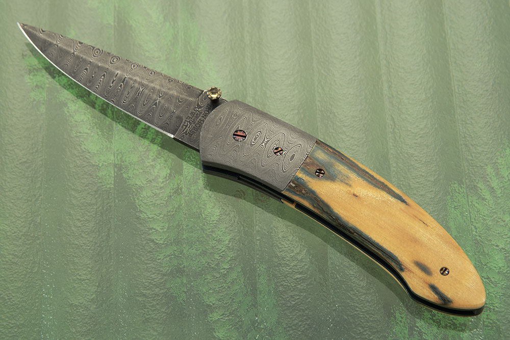

Popularization of 1084 and 15N20
The steel combination of 1084 and 15N20 has become ubiquitous, though it did not become popular until the mid-to-late 1990s. For example, the Jim Hrisoulas book The Pattern Welded Blade from 1994 does not even mention 15N20, and he mostly wrote in that book about combining high carbon and low carbon steels. The 1084/15N20 combination was popularized in part by the “Montana Mafia,” made up of Damascus smiths such as Rick Dunkerley and Shane Taylor. Dunkerley reported that he began using this mix in 1995 from a suggestion from Devin Thomas [3]. I asked my father Devin why he suggested these steels and he said that a lot of bladesmiths would ask him for help with forge welding and etching issues but a lot of people were using difficult steel combinations. He felt that 1084 and 15N20 were easy to forge weld and would give a good contrast.
15N20 has 0.75% carbon along with 2% nickel, so like other nickel alloyed steels it can act as the “bright” layer in Damascus. 1084 has only slightly higher carbon at 0.84% and has elevated manganese when compared with 1095 (0.75 vs 0.4% Mn). 1075 has the same 0.75% carbon of 15N20 so I also asked my father why it was 1084 and not 1075. He said that 1075 was typically available as wide sheet which would require shearing down to narrow pieces for the billet. 1084 was available as narrower “bar” which could be bandsaw cut for the stack with 15N20. For some knifemakers it was appealing that 1084 had more carbon than 1075. Regardless, 1075, 1080, and 1084 are roughly equivalent.
Rick Dunkerley folder in 1084 and 15N20

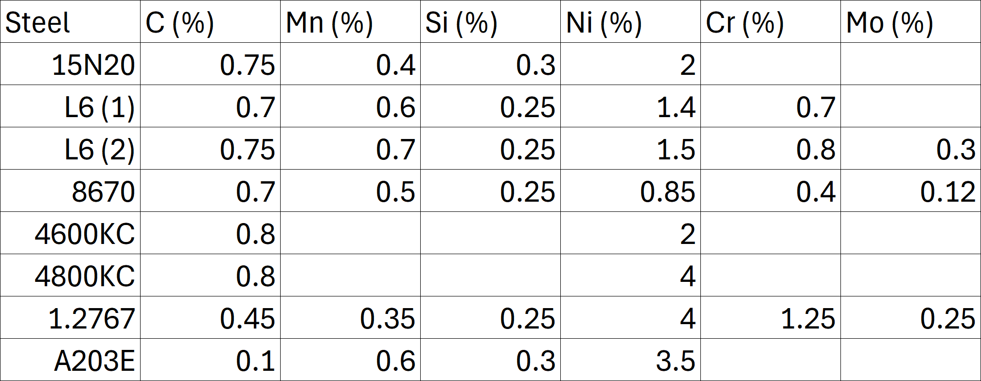

Nickel
It has long been understood that the nickel content in steels like 15N20 allows them to resist etching and thus provide the “bright” layer in Damascus. However, when you etch 15N20 on its own it etches dark just fine so I think it may be some kind of anode/cathode effect at work where the 1084 is etched preferentially rather than the 15N20 resisting etching on its own. Higher nickel seems to lead to greater contrast than lower nickel, so 15N20 with its 2% nickel does pretty well. There are some rarer steels with 4% nickel, such as 4800 steel powder or Bohler K600 (1.2767). L6 has somewhat lower nickel at 1.5% and 8670 even lower with ~0.9%. Unfortunately there aren’t any low alloy nickel steels with significant vanadium or tungsten additions so wear resistance typically needs to come from the other steel used in the combination.
Nickel knife steels. Note: I found conflicting information on 4600 and 4800 compositions so I left the Mn blank. Some list there being 0.5% Mo. The most common versions have little or no carbon, and the “KC” versions have carbon added to them, usually graphite. I have also heard that some distributors take 1080 powder and add nickel powder.

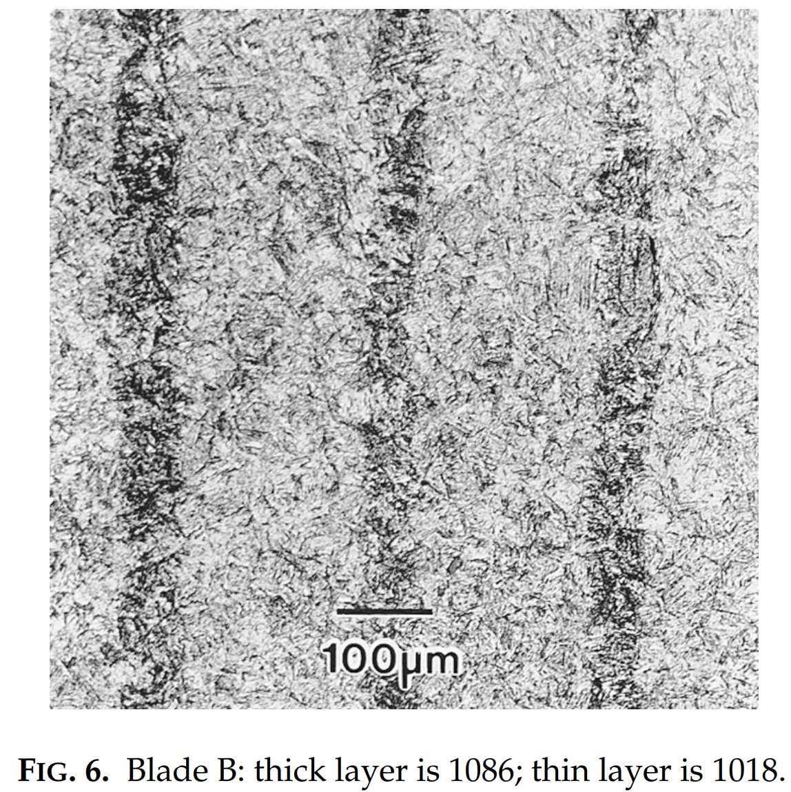

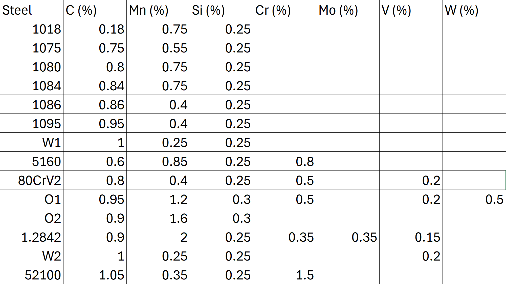

Manganese (and Carbon)
Higher manganese leads to darker etching. For example, in the Verhoeven/Clark study they found that with 1018 (0.75% Mn) and 1086 steel (0.4% Mn) the 1018 was the “dark” layer despite its lower carbon content. This demonstrates that the old view that carbon differences led to etching contrast was incorrect.
Image from [1]. Notice the higher carbon steel is the “light” layer.
The higher Mn in 1084 relative to 1095 and 1075 leads to it being somewhat darker when in combination with 15N20. Some steels with even higher Mn etch even darker such as O1 (1.2%) and O2 (1.6%). The European version of O2 called 1.2842 has 2% Mn and etches darker than perhaps any other common steel.

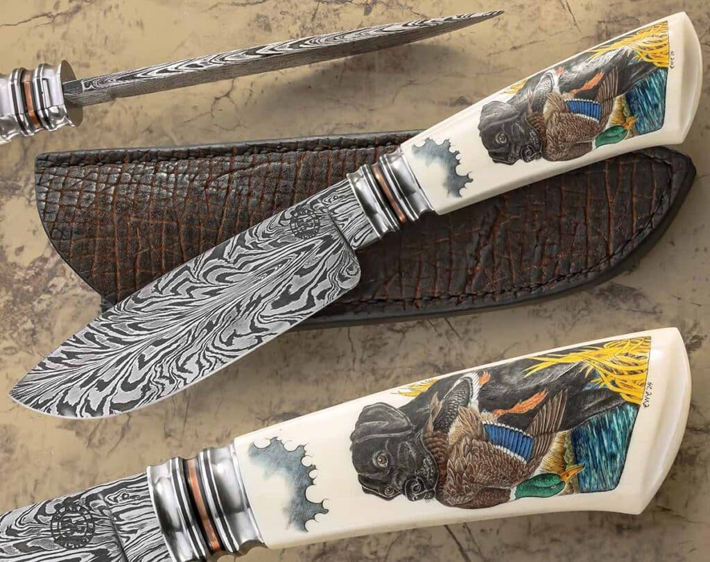

Chromium

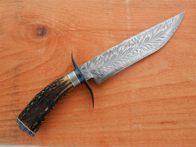

Chromium is a bit more mysterious as to its effects. In the Verhoeven/Clark study they found that 52100/L6 had poor contrast. 52100 has high chromium (1.5%) but also low manganese (0.35%). I have seen knives here or there with 52100 and 15N20 and the contrast can be “ok” in some of them, such as this feather pattern bowie by Aaron Wilburn:
Aaron Wilburn feather Damascus in 52100 and 15N20
1095 steel has similar carbon content to 52100 and slightly more Mn (0.45%) but without chromium. It typically etches darker than 52100 when in combination with 15N20, as seen in this knife:
Blake Nichols knife with Greg Shahan Damascus in 1095 and 15N20
O1 still etches quite dark despite having 0.5% Cr and so does 1.2842 despite having 0.35% Cr. 80CrV2 is also generally considered sufficiently dark in combination with 15N20 even though it has 0.5% Cr and only 0.4% Mn. 5160 has relatively high Mn (~0.85%) and Cr (0.8%) and it can also etch relatively dark despite the Cr addition.
So I think overall it appears that low amounts of Cr do not have a large effect on etching response, but higher amounts like the 1.5% in 52100 may affect how dark steel etches.

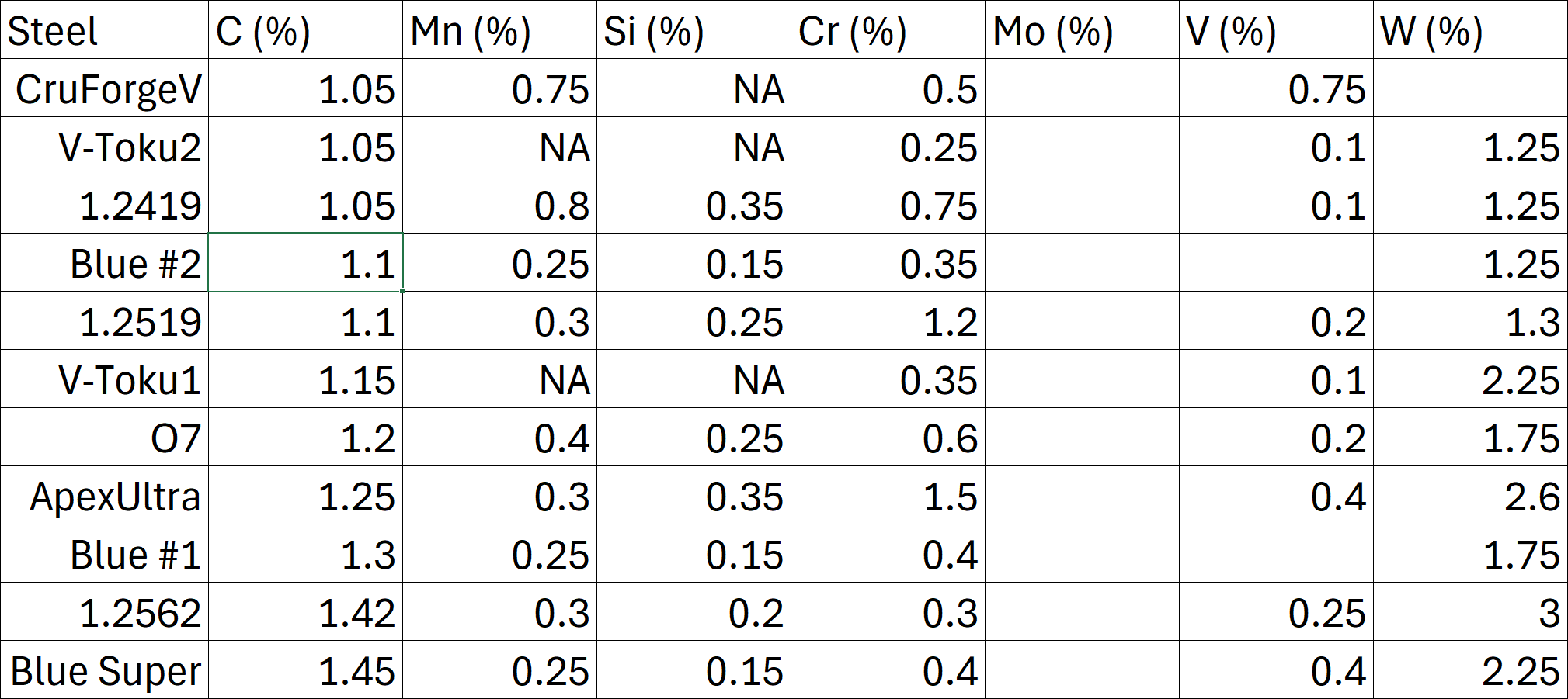

As far as I can tell these elements do not effect etching. However, high vanadium and/or tungsten additions are good for higher wear resistance and edge retention in Damascus so I have included the composition of several of them below:

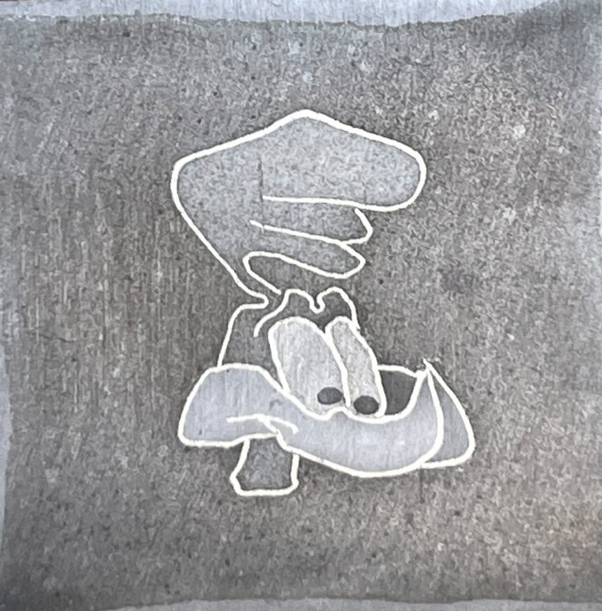

Sometimes an intermediate shade steel can be found between 15N20 and a dark etching steel. One example I found was 1.2842/80CrV2/15N20 Damascus [4]. There can also be some contrast between 2% Ni 4600 and 4% Ni 4800 as seen comparing the eyes (4800) and beak (4600) in the roadrunner by Cliff Parker below:
Cliff Parker Damascus roadrunner. Bright lines are nickel sheet, eyes are 4800, beak is 4600, and the rest is 1084/1018 mixed.

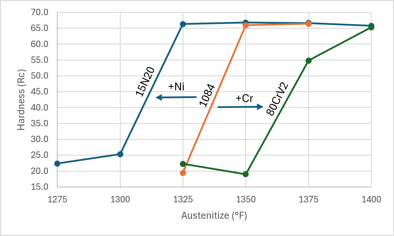

Austenitizing
Semi-frequently I get questions from knife enthusiasts (and even some Damascus smiths) about combining non-typical steels together. Sometimes bizarre combinations like MagnaCut and 15N20. Often times the reason these steels are not compatible is because of the austenitizing (hardening) temperature range. 15N20 is optimally austenitized from about 1400-1475°F (760-800°C), while MagnaCut is austenitized from 1950-2200°F (1065-1205°C). As you can see, these two ranges do not overlap. If the MagnaCut was austenitized from 1475°F it would be very soft (and corrosion resistance would be lower than 1950+ as well). If the 15N20 was austenitized at 1950°F or higher it would have very poor toughness from grain growth. Some steels can be pushed a bit higher or lower than typically recommended in a datasheet but this is obviously not an example of where that can happen.

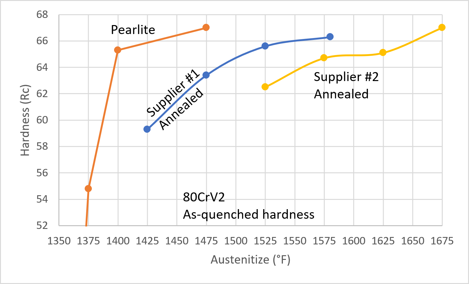

MagnaCut and 15N20 is of course an extreme example but austenitizing ranges can also be relevant even with low alloy non-stainless steels. For example, Mn and Ni push down the temperature at which steel transforms to austenite, and Cr increases the temperature where steel transforms to austenite. You can see this in the chart below where I austenitized steel in 25°F increments and quenched in oil (from a normalized microstructure).

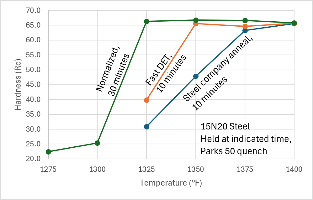

You can see that 15N20 with the 2% Ni addition is fully austenitized (from a normalized, pearlite microstructure) from 1325°F (720°C) while 1084 was still dead soft after quenching from that temperature. The 1084 instead showed full hardness at 1350°F (732°C), only 25°F hotter. 80CrV2 has 0.5% Cr, however, which increases the temperature at which carbide dissolves, and full as-quenched hardness was not achieved until about 1400°F (760°C). This is from a normalized microstructure, not an annealed microstructure. The annealing procedure can have a large effect on heat treating behavior. Below is a chart of 80CrV2 after austenitizing from different temperatures:
As you can see, there is a significant difference between a pearlitic starting microstructure (normalized) and annealed. And in this case even a sizeable difference in the annealed microstructure of the two different suppliers. The Cr addition makes the starting microstructure have a particularly large effect on the heat treating response. This is why Cr alloyed steels often have a somewhat higher recommended austenitizing temperature than Cr-free steels such as 1500-1550°F (815-845°C).
15N20, only alloyed with Mn and Ni, shows a much smaller effect of starting microstructure on heat treating response:
The “Fast DET” anneal was my own annealing procedure with a faster cooling rate. The “Steel company anneal” is the steel as it was received from the manufacturer. You can see that with the steel as-received the peak hardness is not achieved until about 1400°F which is ~75°F higher than a normalized microstructure. But 1400°F is a much lower temperature than was necessary for factory annealed 80CrV2. This helps explain why Cr-free steels are usually austenitized from a somewhat lower temperature such as 1475°F (800°C).

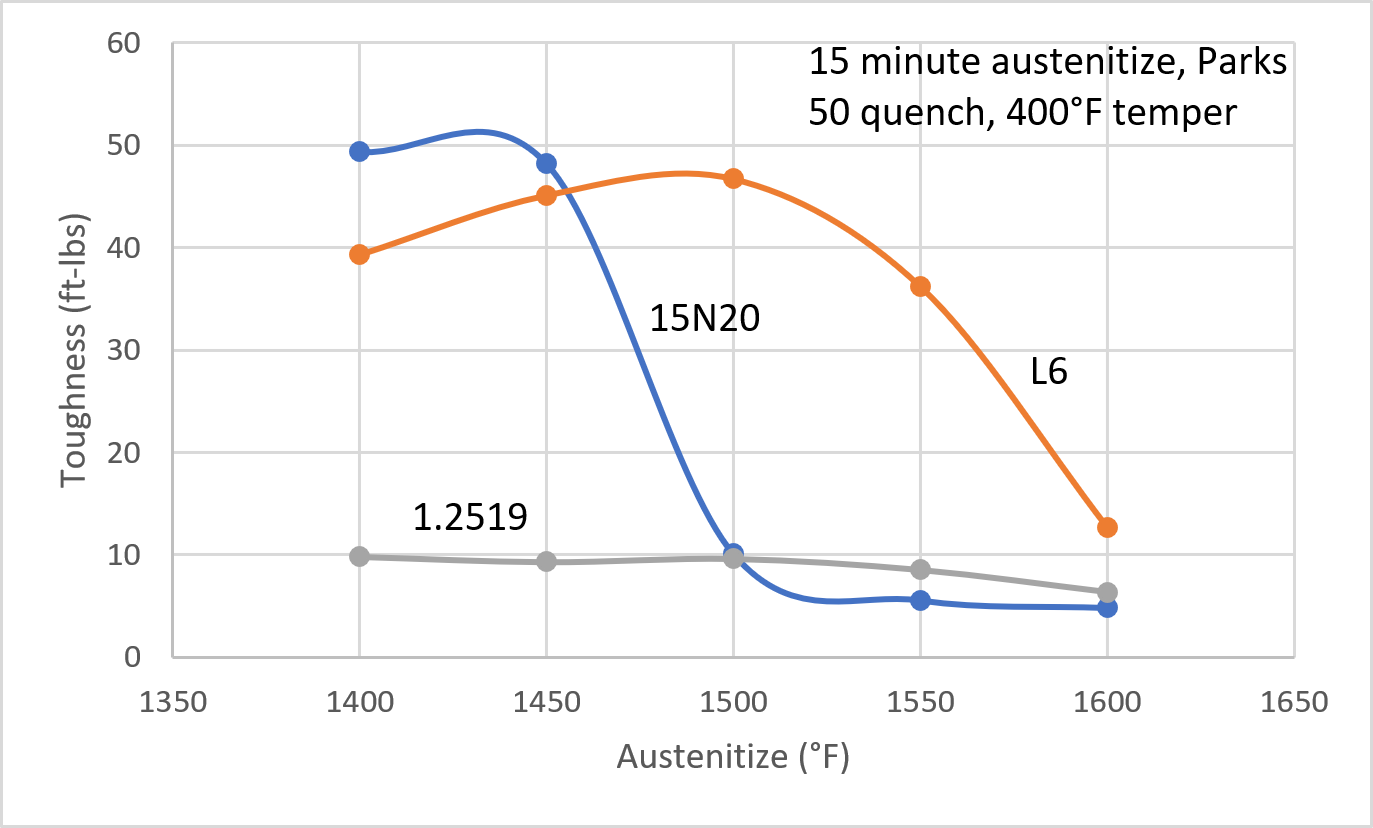

Toughness – Grain Growth
However, there is also an upper end of acceptable temperature, which is where grain growth occurs. For chromium-alloyed steel, toughness typically peaks around 1500-1550°F (815-845°C) and drops from there. This was found with 5160, 52100, and 8670, for example. Carbides can “pin” grain boundaries and prevent grain growth. Because chromium stabilizes the carbides to higher temperatures, grain growth does not occur until somewhat higher temperatures than steels alloyed only with Mn and Ni. Vanadium can extend this temperature range further, as the vanadium carbides do not dissolve until higher temperatures. This is why small vanadium additions (~0.2%) are made to certain steels like W2 and 80CrV2. In my tests of 80CrV2, toughness had not dropped even with an austenitizing temperature of 1580°F (860°C), though I did not try any higher. But 15N20 does not have any chromium or vanadium so we did a new series of tests with 15N20. We also added two other steels, L6, a 1.5% Ni steel with a chromium addition; and 1.2519, a steel with chromium, tungsten, and vanadium (all three of those elements can help prevent grain growth). Each of them were heat treated from the annealed condition as-received from the steel manufacturer.

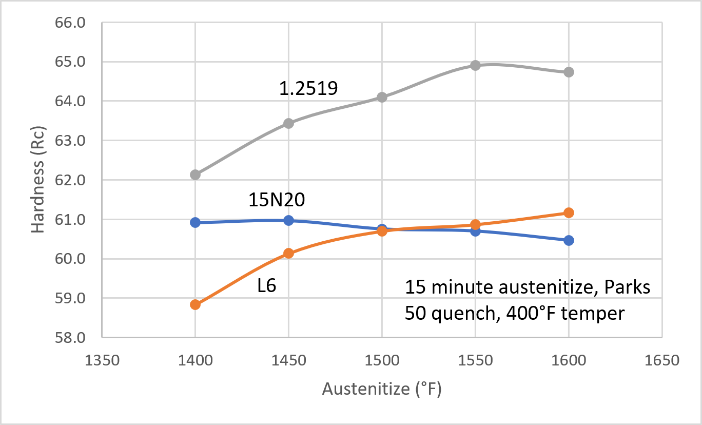

In terms of hardness, the steels behave in ways I have been describing. The L6 and 1.2519 increased in hardness with higher austenitizing temperature. This is because the steels were alloyed with chromium, delaying the dissolution of carbides. 15N20, lacking chromium, was flat in hardness between 1400 and 1600°F.
The L6 peaked in toughness at 1500°F which is similar to other chromium-alloyed steels. The toughness actually increased between 1400 (760°C) and 1500°F (815°C), which is because we are dissolving some carbide (carbides are brittle),  but not getting too much carbon in solution or grain growth. So the optimal austenitizing temperature for L6 would be around 1500°F, as that gives us a good combination of hardness and toughness. 1.2519 had flat toughness between 1400 and 1500°F though hardness also increased significantly over that range. Therefore, the hardness-toughness balance peaked at 1500°F even though the toughness did not change between 1400 and 1500°F. Toughness dropped slightly at 1550-1600°F (845-870°C), which is either due to grain growth or perhaps too much carbon in solution (I will explain that next).
With 15N20, the toughness dropped significantly even with 1500°F. In an earlier test with 15N20 I also found good toughness from 1475°F (800°C). So grain growth and a drop in toughness was found even with 1500°F, the same temperature that gave the peak properties for L6! I was surprised that toughness dropped off so rapidly for 15N20 at 1500°F, which I did not think sufficiently high to cause significant problems, even in a steel with little carbide like 15N20. This may have affected the toughness results of two 15N20 combinations I tested in my prior study, one with 1.2419 and the other with CruForgeV. 1084 is also very sensitive to overheating, grain growth, and a reduction in toughness. So despite how easy it is for 1084 and 15N20 to be hardened, I recommend using a furnace to avoid grain growth and a toughness drop.
80CrV2 and 15N20
So 15N20 needs to be austenitized at 1475°F (800°C) or below to avoid poor toughness, but 80CrV2 is more optimal from 1500-1525°F (815-830°C). Perhaps L6 is the more optimal steel to combine with 80CrV2, and 15N20 is more optimal to be used with 1084. However, the 80CrV2 can be processed to be more compatible with the 15N20. If starting from a normalized microstructure, the steel can be austenitized from a lower temperature to match the 15N20. Normalized steel is somewhat harder, and therefore more difficult to drill and bandsaw cut. With normalized 80CrV2 I found it to be about 25 Rc. This value can vary some based on the cooling rate (greatly affected by the size of the piece). If another grain refining step was added by heating to 1400°F (760°C) and air cooling, the hardness is dropped to about 19 Rc without significantly affecting the hardening response. Generally I prefer to use a “Fast DET” anneal before austenitizing instead, but this is one of the exceptions to that general recommendation.

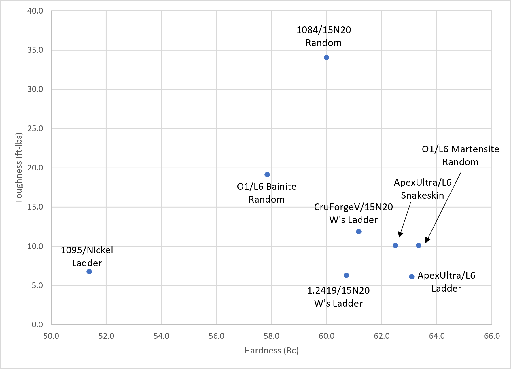

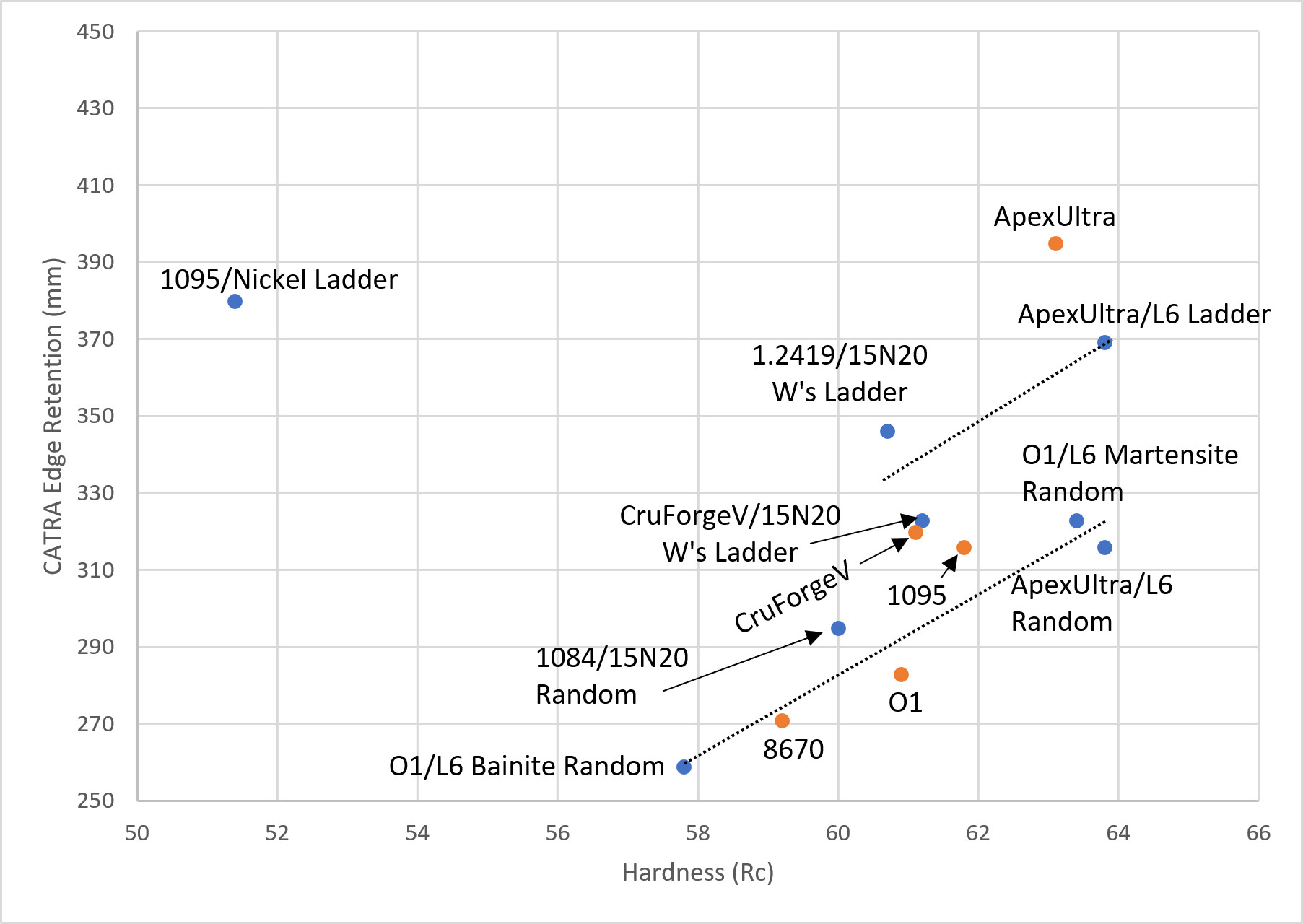

I already have a whole article on the testing of toughness and edge retention of pattern-welded Damascus so I won’t rehash all of that here. But there are a few key points to mention here when it comes to compatibility:
  1. Combining a low toughness and high toughness steel generally seems to lead to toughness similar to the low toughness steel. It fractures at the “weakest link” and there isn’t much benefit to adding a high toughness steel in terms of overall toughness.
  2. High wear resistance steels with high slicing edge retention generally still cut very well even when combined with a steel with lower wear resistance. So combining CruForgeV and 15N20 or ApexUltra and L6 led to edge retention similar to CruForgeV or ApexUltra. However, this was due in part to the improvement in edge retention seen in ladder patterning.
  3. While ladder patterning benefited edge retention it also slightly reduced toughness.
  4. A “Damascus Cutting Effect” was seen in a 1095/Nickel Damascus. Most steel combinations do not have hard and soft layers but using nickel does provide this potential benefit.
When not attempting to have the “Damascus Cutting Effect” it can be beneficial to have two steels with good wear resistance. For low alloy non-stainless steels it makes sense to look at steels with significant vanadium and/or tungsten additions like ApexUltra, CruForgeV, 1.2519, 1.2419, 1.2562, Blue Super, V-Toku1, etc. However, for low alloy steels the main choices for a “bright” layer are 15N20 and L6 and neither has much wear resistance.
If making a Damascus combination for high toughness there must be two high toughness steels. 1084 and 15N20 are a decent combination for this. 1084 is somewhat lower in toughness but the two together still tested at ~34 ft-lbs in a random pattern (as opposed to 45-50 ft-lbs for 15N20).
