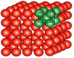

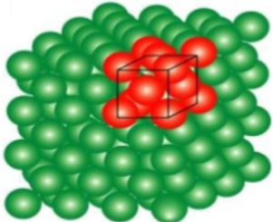

The “unit cell” of body centered cubic ferrite. A unit cell is the smallest possible representation of the crystal structure
What the unit cell looks like within a larger view of the body centered structure of ferrite
Face centered cubic unit cell of austenite
Larger view of face centered cubic austenite
The exact crystal structure of the ferrite and austenite doesn’t matter as much as the properties. Austenite is easily differentiated from ferrite and martensite because it is nonmagnetic. Many knifemakers use a magnet when heat treating to know when the steel has transformed to austenite. However, austenitic stainless steels are designed to be austenite at room temperature so as a result they are also nonmagnetic at room temperature. The way they stabilize the austenite down to room temperature is by adding various alloying elements so that martensite does not form during quenching. Normally with knife steel it is heated to high temperature to form austenite and then quenched to form hard martensite. However, different alloying elements lower the temperature at which martensite forms, and can be reduced to below room temperature:

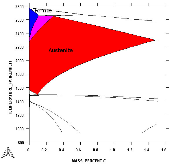

8%Cr Iron-Carbon phase diagram showing delta ferrite (blue), austenite (red), and ferrite+austenite (purple)
Above is for an 8% chromium steel. The delta ferrite phase is over a relatively narrow range of very high temperature for low carbon steel (~2350-2750°F). The austenite phase field, in contrast, covers a wide range of temperature and carbon contents. The purple field is a combination of both ferrite and austenite. Adding more chromium, however, because it is a ferrite stabilizer, expands the delta ferrite phase field.

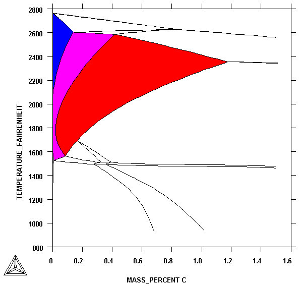

12% Cr Iron-Carbon phase diagram
With 12% chromium the delta ferrite phase field has greatly expanded and the ferrite+austenite field has reached a size where for very low carbon steels the full austenite red phase field cannot be reached at any temperature. With yet more chromium the austenite phase field is very small:

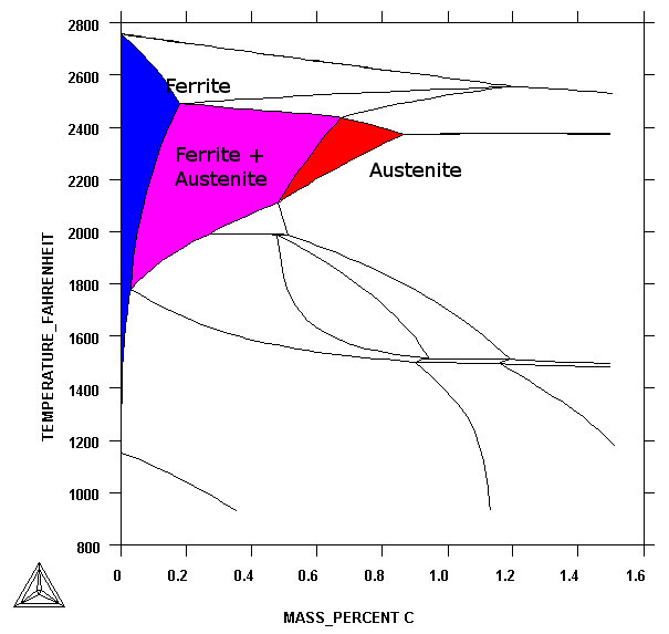

18% Cr Iron-Carbon Phase Diagram
With 18% Cr, the austenite phase is never seen with very low carbon steel, and even steels up to about 0.5% carbon can only partially transform to austenite.

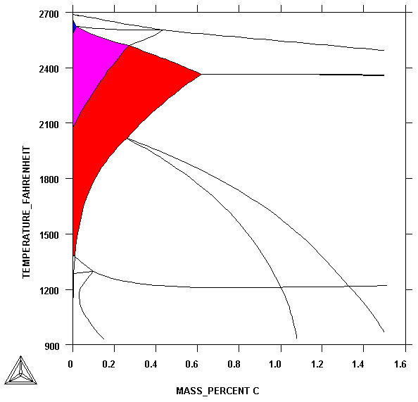

18%Cr-8%Ni Iron-Carbon Phase Diagram
After the 8% Ni addition to the 18% Cr steel, the delta ferrite phase field is now extremely small, and the austenite phase field is much larger and shifted to lower carbon contents. Therefore the steel can be heated to austenite prior to rapid cooling to retain austenite at room temperature.

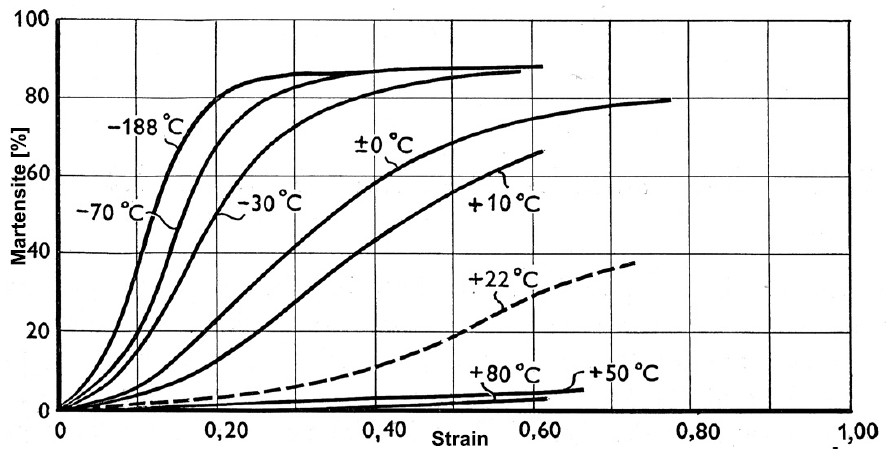

Lower temperature promotes the formation of martensite during deformation while higher temperatures delays martensite formation. The austenite is more stable at higher temperature. The figure below shows the amount of martensite formed vs the amount of strain at different temperatures. At 50-80°C (125-175°F) almost no martensite formed even with 60% strain for this particular steel.
Image from [4]

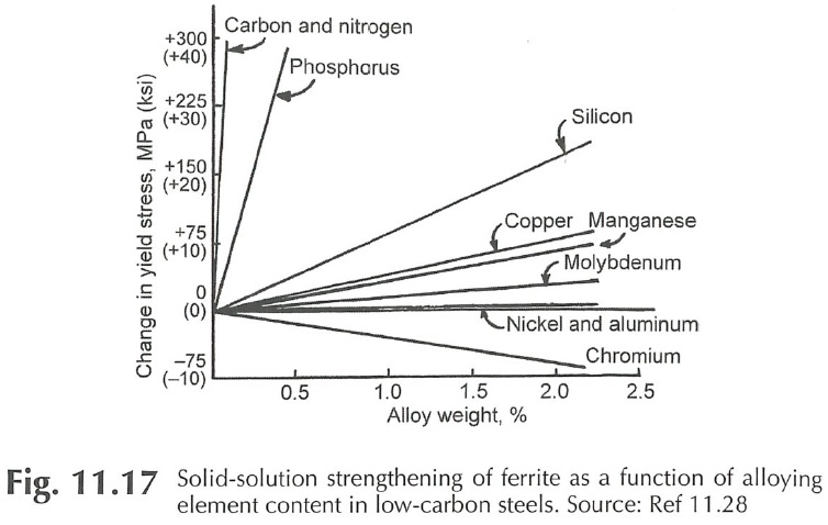

302B steel has a large Si addition to help with “scaling resistance” meaning it is less prone to forming scale at high temperature during forging or other operations. The Si in H1 may very well be added for the same reason, but the addition is even bigger, probably more so than necessary for scale resistance. H1 is also designed to reach high hardness after cold rolling. Silicon is one of the best “solid solution strengtheners” so I think it may be added for increasing hardness.
Image from [6]
Molybdenum also increases strength, however it is probably added for enhanced corrosion resistance, in particular pitting resistance. There is a common equation for predicting pitting resistance where Mo has a stronger effect than chromium. So Mo is very good for improving corrosion resistance in chloride solutions like salt water. Nitrogen also improves corrosion resistance but H1 has a very small amount of it. I wouldn’t call H1 a “nitrogen steel” because many knife steels have a similar amount of nitrogen. Many austenitic stainless steel specifications have a nitrogen maximum of 0.1% just like H1, so H1 is not uncommon among its steel class to have a similar nitrogen max.

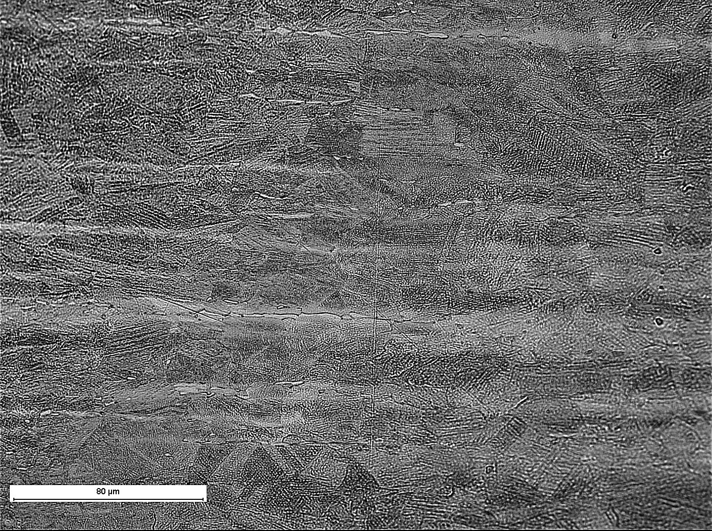

Microstructure of H1
Sandvik also sent me micrographs of their Spyderco Salt in H1, and the steel has an interesting microstructure. They took images in the center of the blade as well as the edge.
The majority of the microstructure looks like martensite, having a rough and lath-like or plate-like appearance, such as pointed out at higher magnification below. There are also some white-etching elongated constituents that look like delta-ferrite to me:
Delta ferrite is sometimes present in austenitic stainless steels because during the slow solidification of molten steel segregation occurs. Alloying elements will diffuse to each other forming localized areas with more or less of a given element. When chromium and other ferrite stabilizers segregate into certain regions, the ferrite is stabilized and is retained at lower temperatures. Silicon is also a ferrite stabilizer, so the high Si in H1 probably also makes it more difficult to avoid delta ferrite. Ferrite is not particularly desirable in a knife because of its low hardness; ferrite can reduce the strength of the edge.
With relatively low hardness, lack of carbides, and delta ferrite, the wear resistance of H1 is much lower than many other knife steels. This would be expected to lead to poor slicing edge retention, and that is confirmed by reports by Spyderco of CATRA edge retention [12]. It has also been reported that H1 has stellar edge retention with serrated edges, even better than other knife steels. I’m sure that the edge retention is greatly improved relative to plain edges. However, I don’t know what about H1 would lead it to have better edge retention than other steels with a serrated edge. Proposals of work hardening effects don’t make sense to me. However, the statements I have seen are somewhat unclear as to what is meant but good serrated edge retention, whether that refers to the level of increase between plain and serrated edges, or comparing serrated edge retention of H1 vs plain edge retention of other steels [12].
The above effects that lead to poor edge retention likely means that toughness is good for H1. The steel has relatively low hardness, has soft and ductile ferrite in it, and is free of brittle carbides. Therefore I would expect the toughness of H1 to be high.
