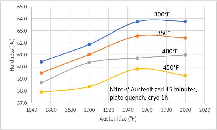

Hardness of Nitro-V
Like other stainless steels Nitro-V has high hardenability so it can be cooled in air or plate quenched for hardness. Oil quenching is also possible though plate quenching is good for helping to maintain flatness. I recommend cryogenic processing for maximizing strength when heat treating. You can read more about cryo here: Part 1, Part 2, and Part 3. For heat treatment experiments on Nitro-V I austenitized for 15 minutes at 1850, 1900, 1950, and 2000°F followed by plate quenching and then immediately going into liquid nitrogen for an hour. The steel was then tempered at 300, 350, 400, or 450°F. Peak hardness was achieved at 1950°F, and remained flat to 2000°F. Therefore I recommend austenitizing no higher than 1950°F. The higher 2000°F has the same hardness despite the increase in hardness of the martensite because of an increase in retained austenite. That means that the 2000°F austenitize likely leads to a decrease in strength and toughness. Heat treating without cryo would mean a reduction in hardness and a reduction in the peak austenitizing temperature. I recommend at least going into a household freezer directly after quenching to reduce the retained austenite as much as possible. To check your heat treatment against mine, it is best to perform heat treatments from a range of austenitizing temperatures and going straight into the cold treatment used, whether freezer, dry ice, or liquid nitrogen. Check hardness and austenitize no higher than the peak hardness.
When using a freezer instead of liquid nitrogen, the peak austenitizing temperature is usually reduced relative to liquid nitrogen treatments because the freezer is not as effective at reducing retained austenite. Knifemaker Mike Pierce reported to me that he achieved peak hardness of 60.5 Rc from 1900°F without a cold treatment, which was increased to 63 Rc when going directly into the freezer after the quench.

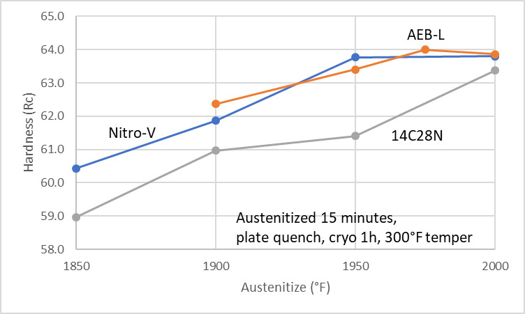

The peak hardness of Nitro-V is relatively similar to AEB-L and 14C28N. Both AEB-L and Nitro-V reach about 64 Rc, while 14C28N reached 63.5 Rc, though I didn’t austenitize high enough with 14C28N to see where the hardness begins to decline. The peak austenitizing temperature of Nitro-V is a bit reduced relative to AEB-L.

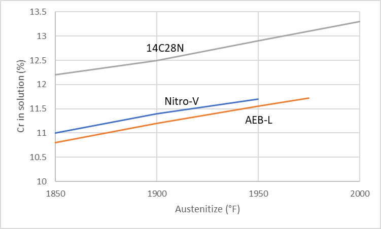

Chromium and Corrosion Resistance
In stainless steels, the amount of retained austenite for a given amount of carbon in solution (hardness) is how much chromium is in solution (corrosion resistance). The similar peak hardness of Nitro-V and AEB-L may therefore indicate that the amount of chromium in solution is similar. Furhtermore, since AEB-L and Nitro-V have the same bulk Cr, to put more Cr in solution relative to AEB-L it would require a reduction in carbide content which would reduce wear resistance and slicing edge retention.
Calculations of chromium in solution from Thermo-Calc confirms that the two are similar, especially when considering that Nitro-V needs to be austenitized at a somewhat lower temperature. I have cut off the lines where peak hardness was achieved in each. 14C28N, however, has significantly more chromium in solution, which likely gives it better corrosion resistance than Nitro-V and AEB-L.

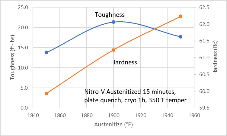

Toughness Optimization
For toughness testing I austenitized Nitro-V at 1850, 1900, and 1950°F for 15 minutes, followed by plate quenching and cryo, and then tempered twice at 350°F for two hours each time. The toughness is tested by averaging three specimens which are unnotched subsize charpy specimens. You can read more about the charpy specimens we use here. I heat treated the specimens and Mike Pierce kindly machined them for me.
The 1850°F austenitized led to reduced toughness relative to the 1900 and 1950°F conditions. This could be due to insufficient dissolution of carbide (carbides are bad for toughness), or possibly because increased austenitizing temperatures led to more retained austenite despite the use of cryogenic processing. Retained austenite in the right amounts can sometimes improve toughness. Therefore the optimal austenitizing range for Nitro-V is 1900-1950°F because 1850°F leads to a reduction in both hardness and toughness and 2000°F led to excessive amounts of retained austenite.

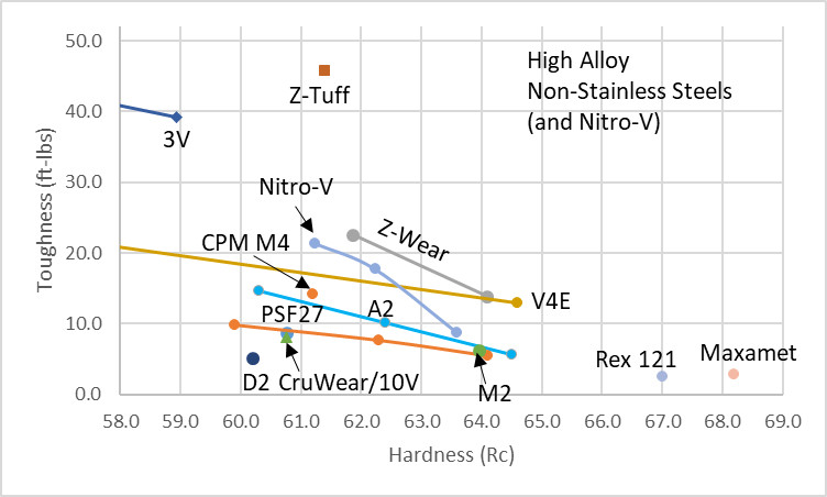

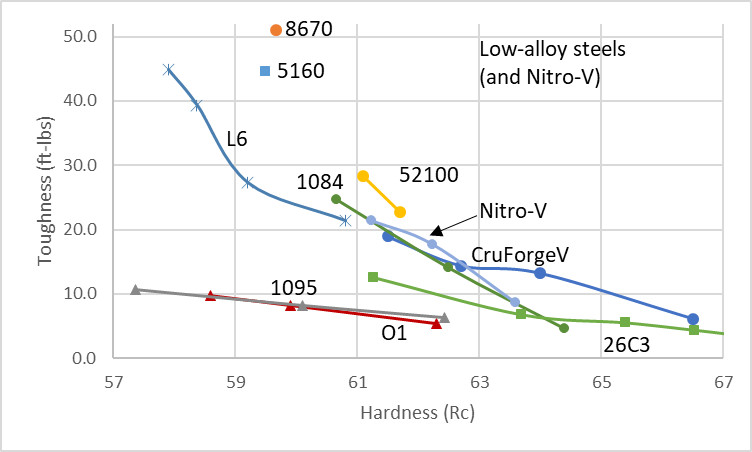

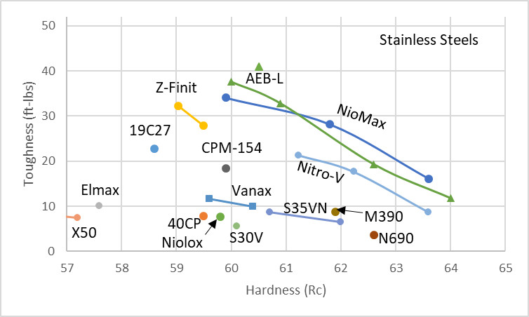

Toughness Comparisons

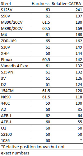

Nitro-V has very good toughness compared with other steels. It has slightly lower toughness than AEB-L for unknown reasons. It is significantly tougher than the powder metallurgy stainless steels like M390, Elmax, and S35VN. Therefore Nitro-V would be well suited to knives requiring good toughness.
Nitro-V is expected to have very similar wear resistance and edge retention to AEB-L, but there has not been any testing to confirm that. The compositions of the two are similar and the micrographs also look very similar in terms of carbide content. AEB-L has edge retention similar to 52100, which is significantly lower than higher carbide content stainless steels like 440C, CPM-154, S30V, etc. The tradeoff is that those steels have much lower toughness than AEB-L and Nitro-V, of course. Here is a chart showing the relative position of AEB-L to get an idea of where Nitro-V likely sits:

  3. Nice work. It would be helpful to see 14C28N in your toughness comparison graphs and in the Edge Retention table, since 14C28N is arguably its closest competitor among affordable high-N steels. How does 14C28N compare in toughness and edge retention?

    I also see that on the CATRA tests AEB-L ic in about the same range as O1. I guess I need to do more studying, but I would have thought it would come out higher?

      AEB-L was definitely higher than O1 in the test, at about 80 mm more cardstock at similar hardness. Roughly the same as the difference between 440C and S35VN, and plenty of people think those are very different.
