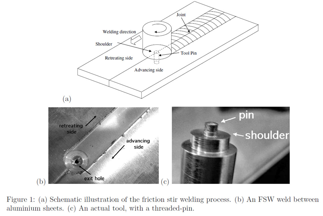

Friction stir processing was developed out of “Friction Stir Welding.” A rotating piece joins two pieces together by generating heat through friction and intermixing the two materials together. The process is designed to work without melting of the materials. A schematic and video of the process can be viewed below:
In studies of this welding process it was discovered that the weld zone had a refined grain structure and improved ductility in aluminum, which led to friction stir processing. Friction stir processing is used to improve properties in a processed zone without welding anything.
When friction stir processing steel, the high heat that is generated in combination with rapid cooling leads to a process similar to hardening steel: the steel is “austenitized” and quenched to form hard martensite. The applied deformation makes some improvements to the microstructure as well as explained below.

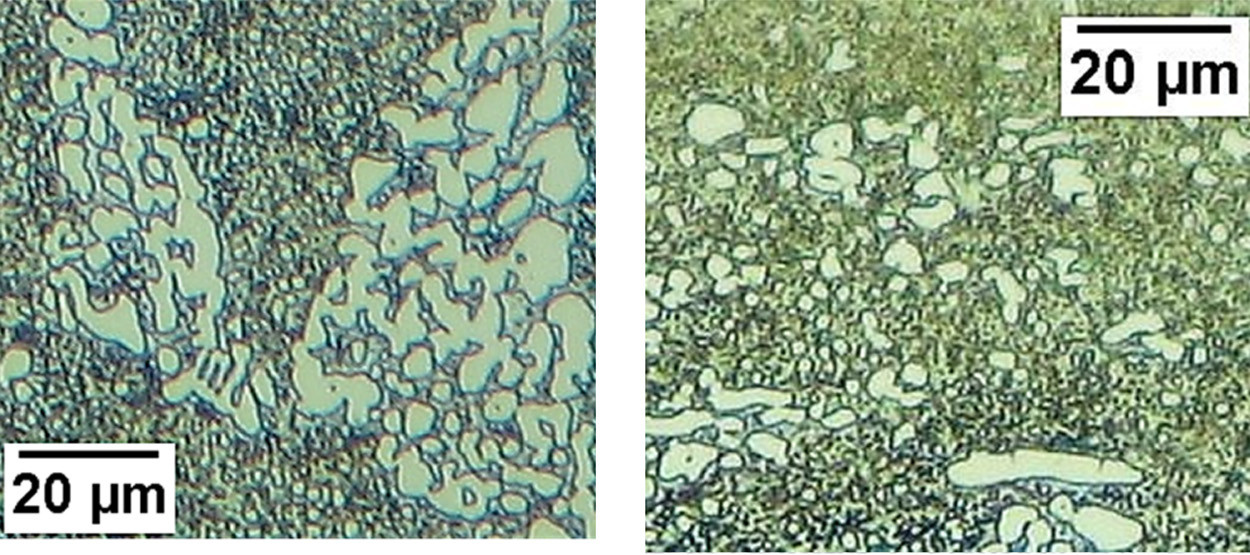

Carbide Structure
The carbides in tool steels and stainless steels have been reported to be refined somewhat by the high temperature deformation during friction stir processing. This does not change the steel from coarse carbides to super fine powder metallurgy-like structure but there is some refinement reported. Below shows conventional D2 (left) and friction stir process (right).
Image from [7]

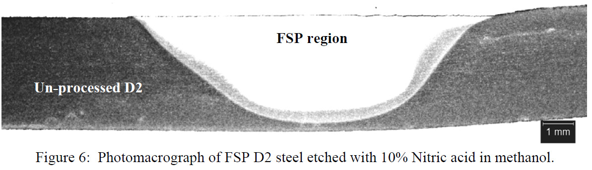

Friction Stir Processing of Knives

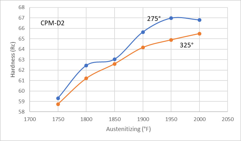

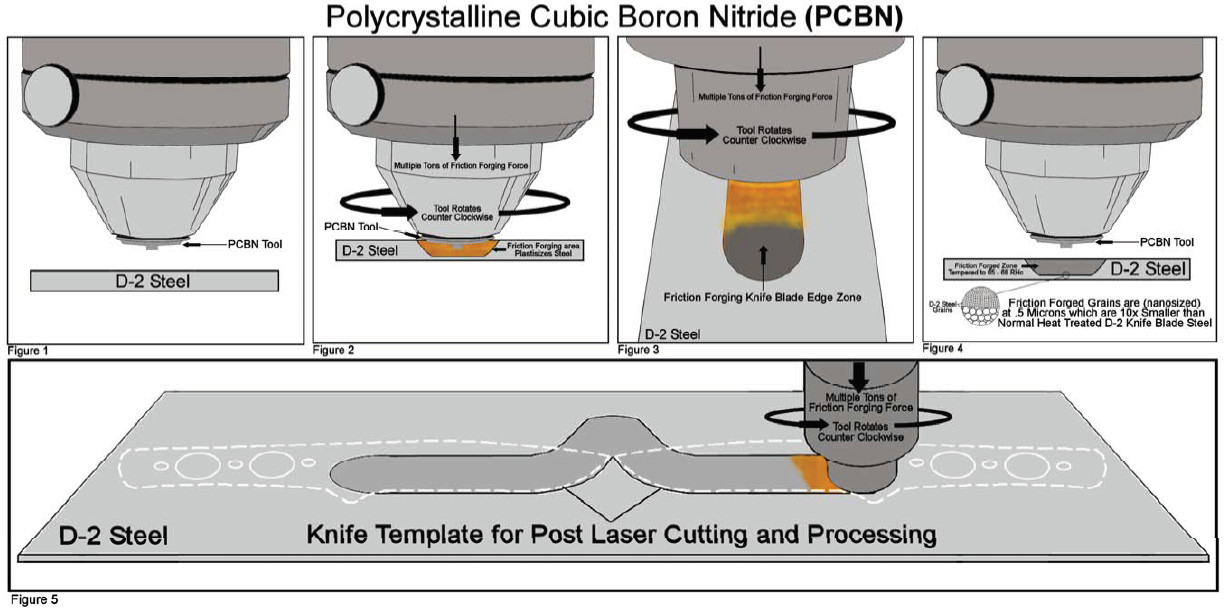

Diamondblade Knives are produced with D2 steel. They start by heat treating the overall blade to 38-42 Rc, and then friction stir process the edge. I don’t know if they perform any tempering of the steel afterward. You can learn about the process of making them in the following video and schematic:
The resulting hardness at the edge is reported to be 65-69 Rc, though that range varies somewhat. In their FAQ they have 65-69 Rc listed but in another part they listed 65-71 Rc. Phil Wilson said he was told 66-68 Rc [13] which was shortly after the knives were released. So there has been some inconsistency and perhaps some climbing of the hardness values. Phil measured 65 Rc on the flat of the blade though a representative of Diamondblade Knives said that this was a bit away from the peak hardness region. I got 65-67 Rc with heat treatments of D2 that utilized cryo, and Diamondblade Knives is claiming a similar or even higher hardness value without using cryo. So it appears that the grain refinement from friction stir processing is leading to a hardness increase.
Carbide Structure

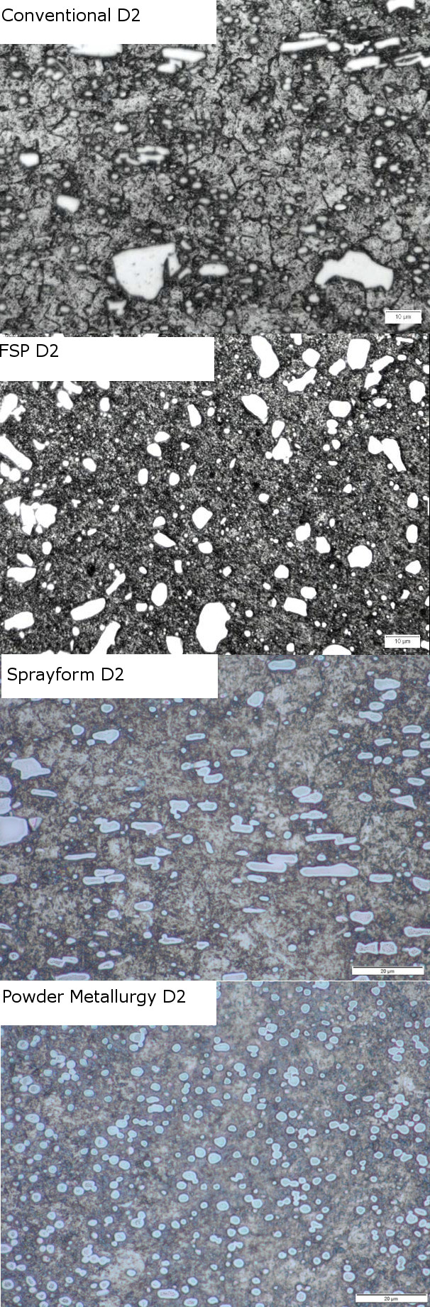

Diamondblade Knives has reported somewhat of a carbide refinement from FSP. I have resized micrographs of sprayform and powder metallurgy D2 as a comparison between FSP and those steelmaking technologies. Sprayform and especially powder metallurgy leads to a finer carbide structure:
Top two images are from [14]

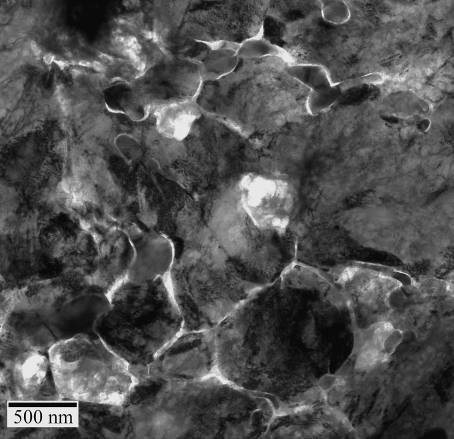

Grain Size
Diamondblade Knives claims a grain size of 0.5 micron [14]. This is a very fine grain structure. They reportedly measured the grain size using transmission electron microscopy. They shared a micrograph of the TEM imaging but it is very high magnification so it is hard to tell what the average grain size would be. They also reported that the grain size of powder metallurgy S30V steel is 2-5 microns. A study cited in the previous grain size section found 2.3 micron grain size for FSP D2 which sounds more reasonable so I wonder if they are indeed able to get the grain size down to 0.5 microns.
Image from [14]

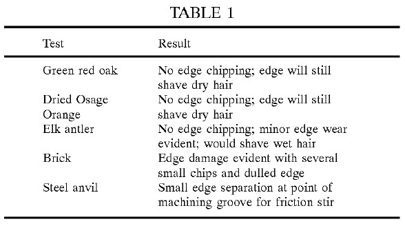

The toughness of Friction Forged D2 is reported to be good, though the experimental evidence of this is somewhat limited. In the patent [15] they report tests with a “Brown Bear Cleaver” blade comparing conventional and FSP D2 blades. The patent is unclear as to how the conventional D2 blade performed in comparison. I believe they are stating that the chipping behavior was similar between the two blades. Here is a table of results from the patent after chopping different materials:
Phil Wilson reported cutting into redwood at right angles and twisting out of the cuts. He tested with a hunting knife that has a behind the edge thickness of 0.015-0.017 inches. After 10 cuts into the redwood he did not detect any chipping. Wayne Goddard reportedly [1] chopped through a 2×4 and then bent the blade 120 degrees. The bending is possible due to the relatively soft spine. This is perhaps one of the more interesting elements of the friction stir processed knives is that a differential heat treatment is possible. Differential heat treatments (soft spine, hard edge) are difficult to achieve with conventional methods on high alloy steels like D2.
It is difficult to evaluate toughness based on these types of tests. Even very brittle steel can perform relatively impressive feats if given sufficient geometry. Without quantitative toughness tests using comparisons with conventional steel and alternative steels it is very hard to say if the toughness is bad, good, or excellent. At such high hardness the toughness of D2 is not expected to be very high, and I wouldn’t think that grain refinement would significantly change that. The carbide structure and high hardness would lead to “good” at best toughness.

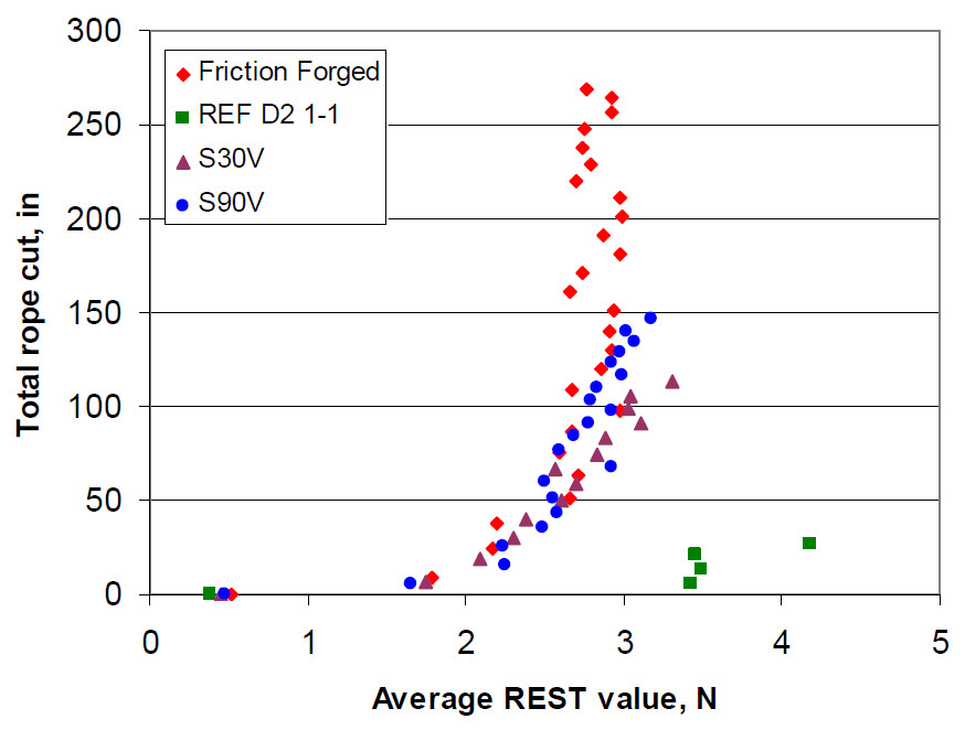

Edge Retention by Diamondblade Knives

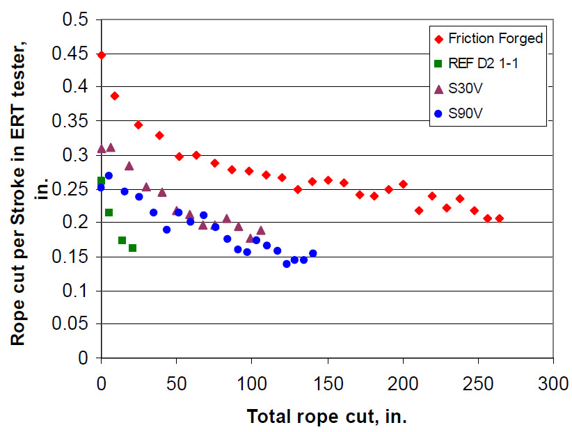

Edge retention was tested by Diamondblade Knives using a CATRA tester modified to use rope rather than the standard silica-impregnated paper. I have never seen anyone use rope instead of cardstock and its use raises some questions. Perhaps the FSP D2 did no better with the cardstock leading to them looking for an alternative. It is hard to say. They claimed that, “Rope was used instead of CATRA test media because the CATRA test media was too aggressive, and not indicative of the typical use of outdoor knives.” Here are the reported results of their CATRA testing:
The amount of rope cut in the first cycle was significantly more with the FSP processed D2. They claim this is due to “higher initial sharpness.” However, if the initial sharpness was different between the blades that would mean they did not sharpen the knives correctly. There is no inherent advantage to FSP in terms of initial sharpness. There are a few primary possibilities for why the initial cutting was better for the “friction forged” blade:
1. The sharpness was indeed better. Fortunately, they used a separate sharpness test to determine if the sharpness was different. Sharpness was nearly equal between the four knives according to the test (higher force in N means lower sharpness). In fact the friction forged blade appears to be slightly worse. So the claim of improved sharpness doesn’t make sense according to their own data:
2. Higher wear resistance of FSP D2. I reported in this article on CATRA testing that higher wear resistance steels can cut more cardstock in cut number one. The reason is because each “cut” is both a forward and backward stroke, so the first half-cut wears the edge which leads to less cutting in the second half. However, they used rope instead of cardstock which is less abrasive, which would lead to less difference resulting from this effect. And the “Friction Forged” knife is much higher than the others, so I don’t think superior wear resistance explains the difference.
3. Different edge angle. A more acute edge would lead to much better cutting behavior. The article claims that “all blades had identical edge geometry.” However, based on the resulting edge retention test this doesn’t seem likely. The higher initial cutting ability of the FSP D2 knife is suspect.

So yes I know this is a six year old thread. Simple way to solve this debate of FSP steel. Buy a diamond 💎 friction forged knife and test it against other steels.
Until I see someone do that Like Larrin. Or another independent tester. I will take this article as well as Diamond friction forged knives claims with a lot of skepticism and half baked claims.
Cedric should do a rope cutting test. But alas. No one outside of Diamond Blade knives has supposedly tested this friction forged steel.
