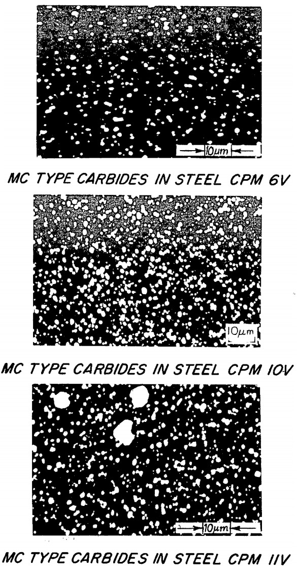

Walter Haswell and August Kasak of Crucible patented CPM-10V using this technology in 1978. 10V was developed to have a very high vanadium content for high wear resistance, higher vanadium (~10%) than was possible with conventional processing. Walter Haswell had previously worked at Latrobe (like David Giles who developed A7) and had been involved with the development of high vanadium and high wear resistance steels [1]. That previous knowledge from high wear resistance Latrobe steels likely helped with the development of 10V. 10V looks quite similar to Latrobe A7 except with an increased vanadium content.
Development of 10V

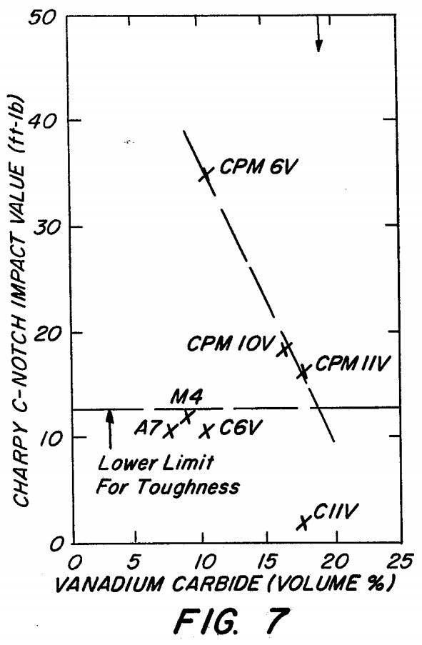

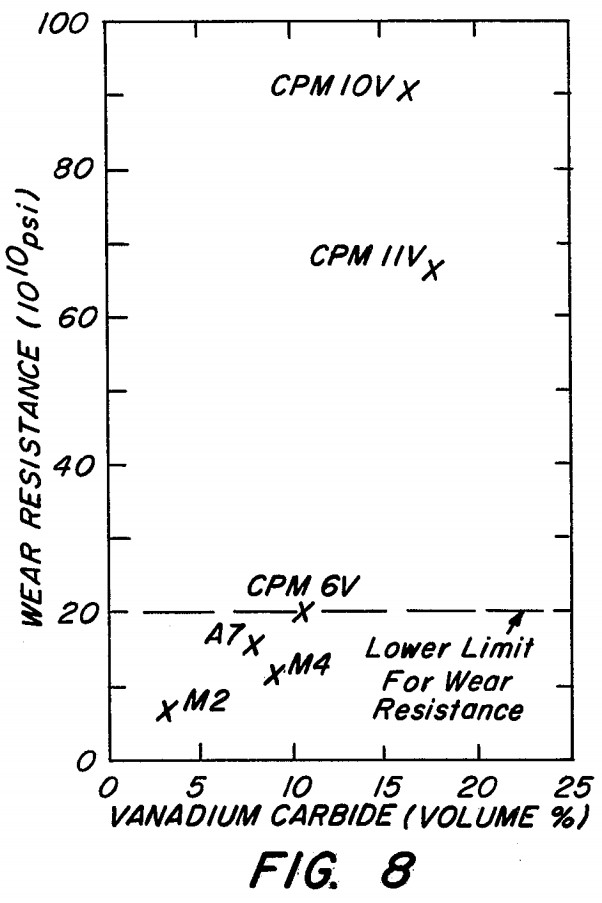

The patent [2] lays out the process of developing 10V relatively well. The goal was to maximize vanadium carbide content for high wear resistance without having so much carbide that toughness is low. The harder the carbides, the higher the level of wear resistance for a given amount of carbide. So a steel with hard 15% vanadium carbide has higher wear resistance than a steel with softer 15% chromium carbides. However, the toughness of those steels would be relatively similar assuming the carbide size is also similar. 10V was one of the first steels to be designed to avoid all other carbide types and to be made up of vanadium carbide only. This means that 10V could have a balance of toughness and wear resistance exceeding previously available steels due to the powder metallurgy technology which maintains a small carbide size with high vanadium additions, and a design that leads to only vanadium carbides in the heat treated steel.
They looked at a range of different vanadium contents and found that above around 10% vanadium, the carbide size would be increased, reducing grindability and toughness. With not much more than 10%, the toughness would be reduced to the same level or lower as conventional (non-PM) 4-5% vanadium steels like M4 and A7 which would make 10V less desirable.
They also found that 11V would have reduced wear resistance relative to 10V because of larger carbides in certain tests. This was as measured in a “crossed-cylinder wear test,” a type of adhesive wear test not particularly relevant to knives, but this was further confirmation to the Crucible metallurgists that 10% vanadium was the reasonable limit (higher is better in the chart below).

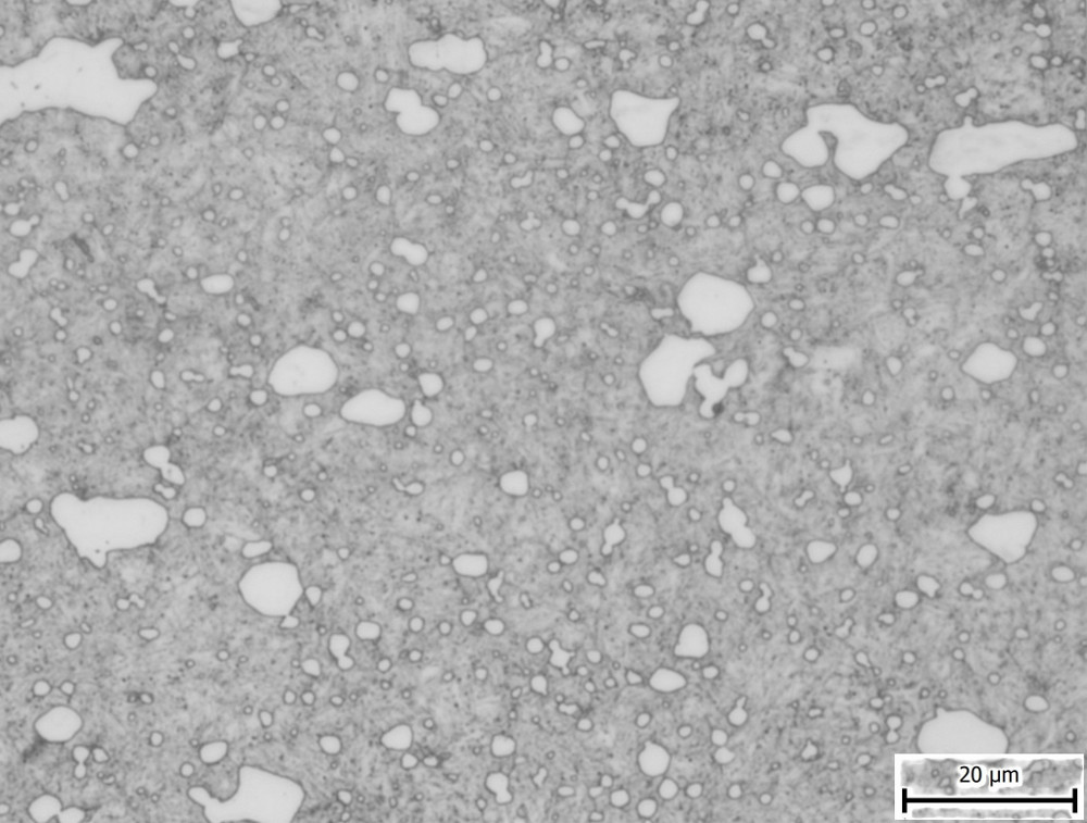

Why do we have 15V now?
Based on the above you may wonder why Crucible now makes CPM-15V as that material would be expected to have large carbides and poor properties. Crucible metallurgists later developed modified processing parameters [3] during powder metallurgy production, primarily a higher melting temperature. The higher melting temperature means that the vanadium carbides do not form in the melt, maintaining a small size during the atomization process. This allowed a further increase in vanadium beyond 10%.

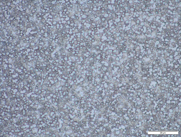

10V has about 16-18% vanadium carbide in its heat treated state. This is a similar volume of carbide to many popular stainless knife steels. Vanadium carbides are typically smaller than chromium carbides in powder metallurgy steels. For example, I have micrographs below for both 10V (16% vanadium carbide) and CPM-154 (16% chromium carbide). Of course the carbide size of either is significantly smaller than conventional steels like 154CM. A steel with less vanadium like CPM-4V has less carbide volume (~8%) and somewhat smaller carbides. CPM-15V has more carbide volume (~23%) and somewhat larger carbides. Compare with more steels in this collection of micrographs.
10V = 16% vanadium carbide
CPM-154 = 16% chromium carbide
154CM = 16% chromium carbide
CPM-4V – 8% vanadium carbide
15V – 23% vanadium carbide

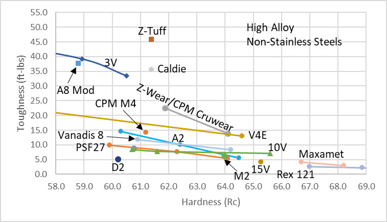

Toughness values come from our own tests using subsize unnotched chapy specimens. 10V has a similar carbide volume to popular stainless steels like CPM-154 and S30V. However, having vanadium carbides, the structure is a bit finer than stainless steels as shown in the micrographs above. This gives 10V similar toughness to stainless steels S35VN and CPM-154 but with significantly higher edge retention. And it has better toughness than steels like M390 and S110V. 10V also maintains its toughness relatively well at high hardness; the behavior is relatively flat in the chart below (green triangles).

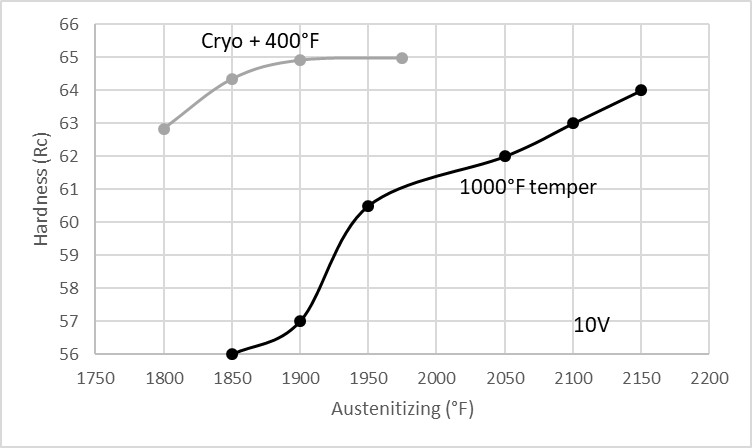

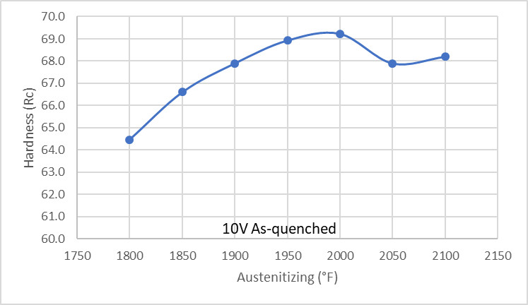

10V can be heat treated to very high hardness levels “as-quenched,” and hardness is likely roughly the same with a 300°F temper. This provides the steel some flexibility as it can be heat treated to a bit lower hardness for higher toughness or high hardness for extreme cutting knives. The values below used a 30 minute austenitize, plate quench, and cryo treatment in liquid nitrogen.
The relatively low molybdenum content in 10V means that hardness values are significantly lower when using high temperature tempering (~1000-1050°) when compared with low temperature tempering (300-500°F). Read this article for more on tempering. High temperature tempering is often preferred in datasheets because retained austenite is greatly reduced without using cryo, and because it gives the steel better tempering resistance during machining and other operations. However, with 10V the low temper allows a reduced austenitizing temperature where there is less grain growth and lower carbon in solution for better toughness, see this article on austenitizing for more information. When using low temperature tempering, austenitizing temperature should be restricted to no higher than 1950°F, and somewhat lower without cryo.
Cryo+400 hardness as measured by me, 1000°F temper from the 10V datasheet
We tested a series of unnotched subsize charpy specimens using steel donated by Alpha Knife Supply and Niagara Specialty Metals. The specimens were heat treated by myself and Warren Krywko. And machined by myself and Matt Gregory. These specimens were austenitized for 30 minutes, plate quenched, given a cryo treatment in liquid nitrogen, and then tempered twice.
Using 1775-1850°F austenitizing along with a 500°F temper, 60-62 Rc was achieved along with good toughness of about 8 ft-lbs. This was the heat treatment used in the 60 Rc condition in the large CATRA study. Using 1975 and 400°F delivers 65+ Rc while providing an increase in strength and edge retention, with only a small decrease in toughness. This heat treatment was also tested in the CATRA study and had very good edge retention. The two 1000°F tempered conditions tested, however, had reduced toughness. This is a similar finding to testing with CPM-CruWear.
