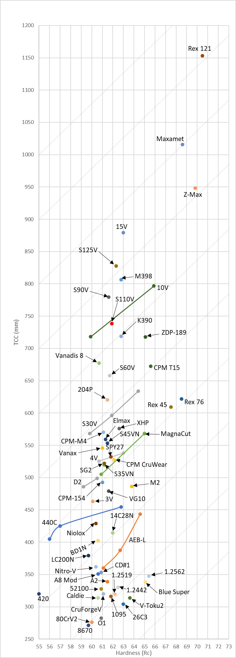

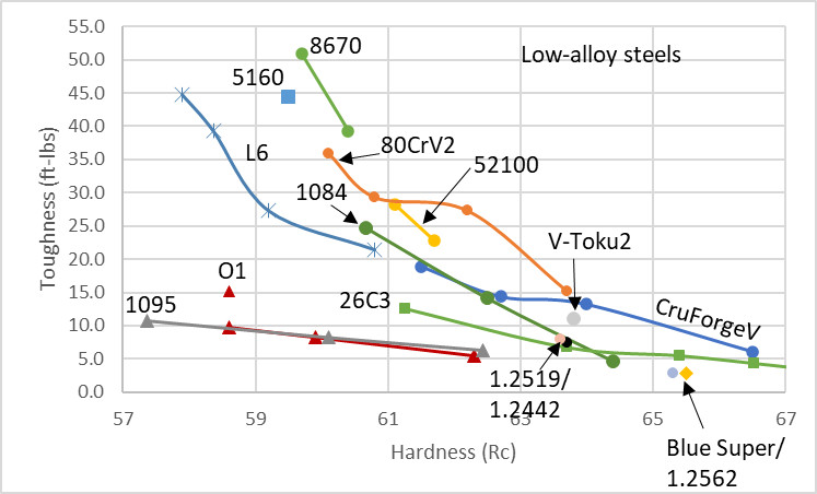

80CrV2 has quite good toughness; I have found slightly better toughness than 1084, in fact. That may be explained by the slightly lower carbon, the chromium addition further reducing carbon in solution (less plate martensite), and the vanadium addition to keep the grain size small. The only low alloy steels with better toughness are those with lower carbon such as 8670 and 5160.
Wear Resistance
Given that 80CrV2 has almost no carbide in it after heat treatment, the wear resistance of 80CrV2 is controlled almost exclusively by its hardness. This means that its wear resistance as measured by a CATRA edge retention test is very low on the chart. Steels with more carbide can do much better when it comes to edge retention from abrasion. Read more about CATRA testing in this article.

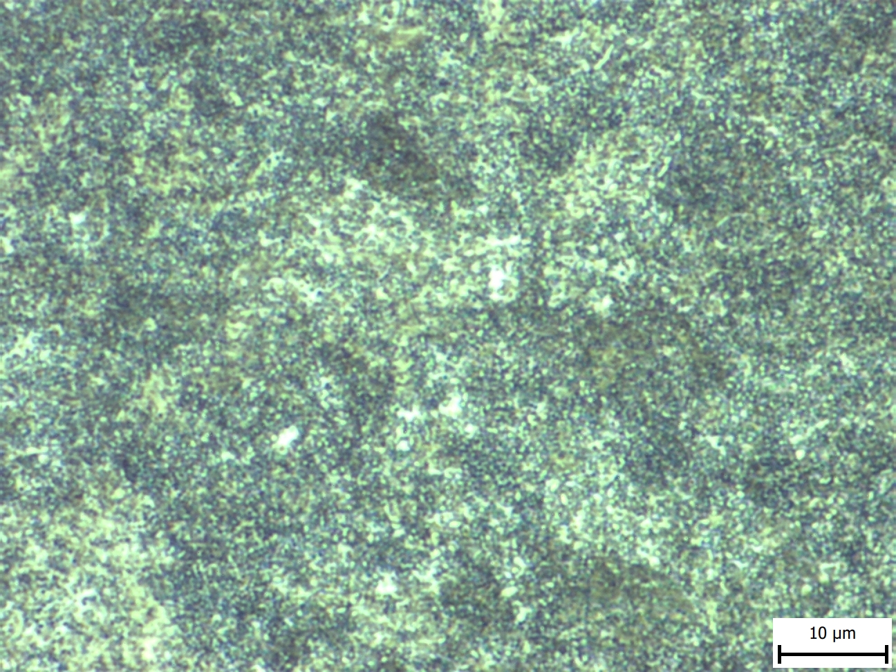

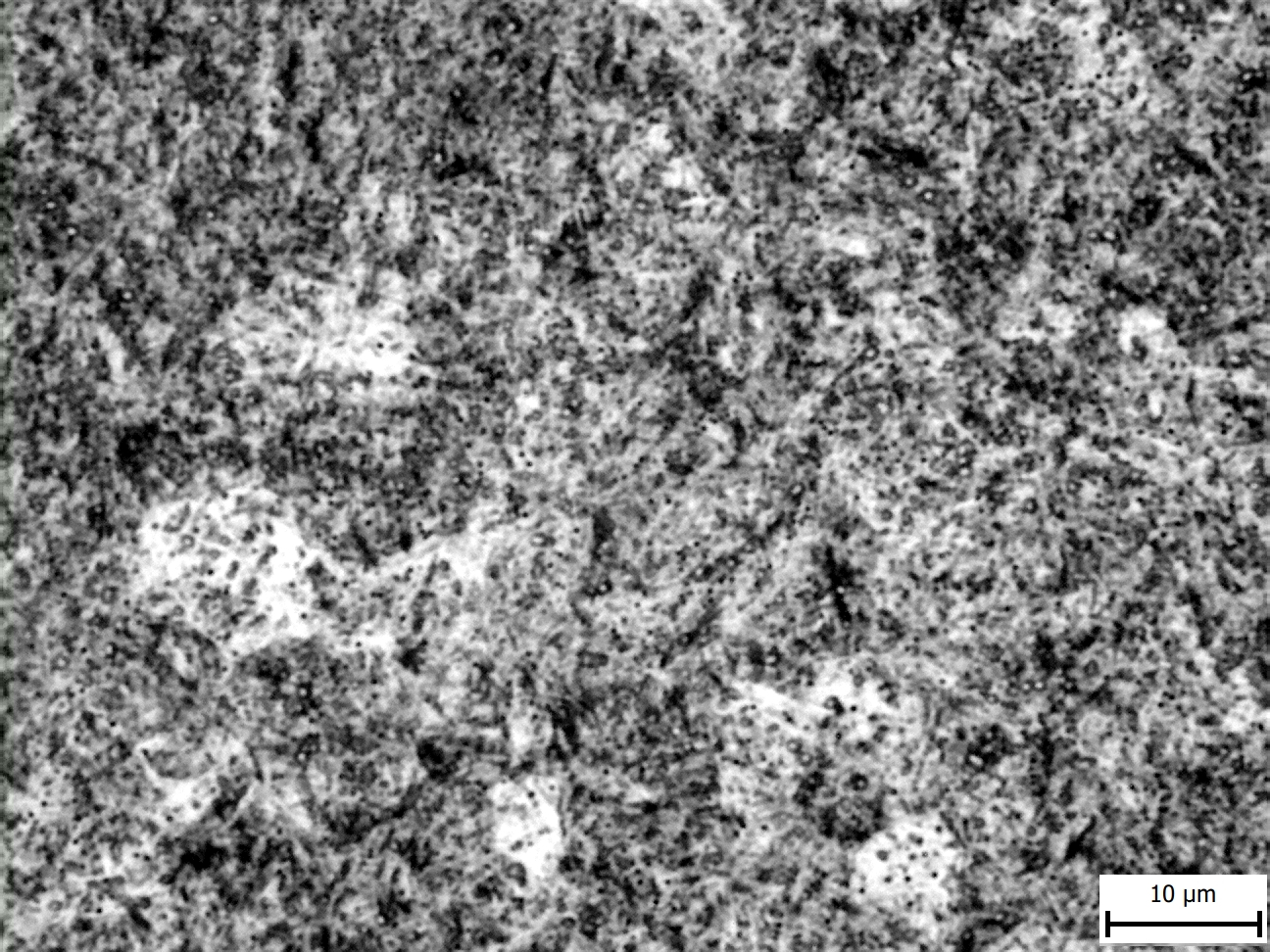

Below shows the resulting hardness of the 80CrV2 either as-supplied from the manufacturer or after the “thermal cycling” process described above:
The NJSB material is the highest in hardness because it wasn’t annealed. It is primarily a pearlite microstructure with some spheroidized carbides. The AKS and Jantz material has roughly the same hardness and a similar annealed microstructure. Another surprise is that the KSN-recommended thermal cycling led to somewhat lower hardness than AKS/Jantz even though the KSN processing led to the finest carbides. The Buderus material had the lowest hardness and the coarsest carbides. The microstructures below are very fine so it can be difficult to see everything going on even at this 1000x magnification. But you should be able to see the trend between the finest and coarsest microstructures.

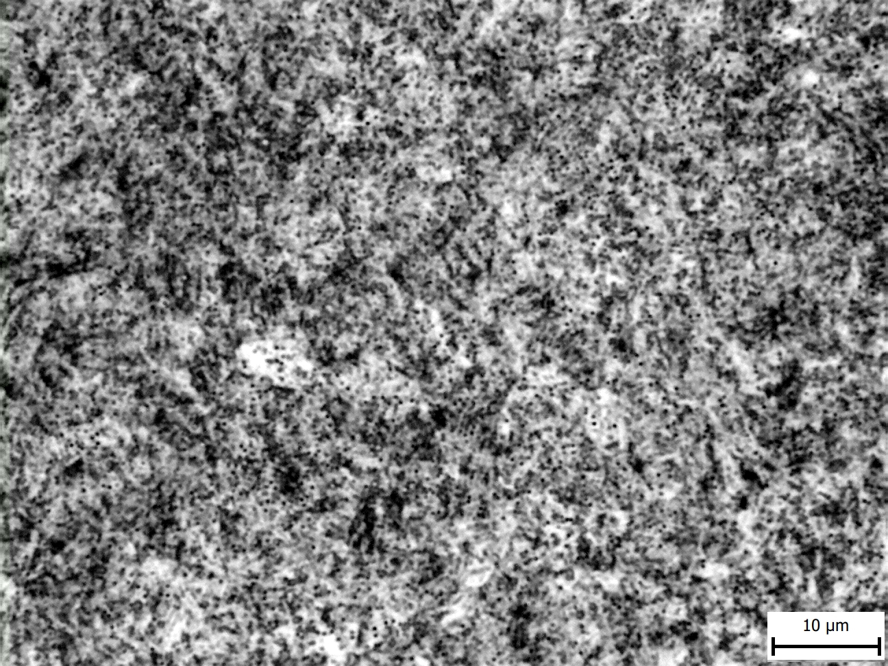

“NJSB-cycling” – mostly pearlite with some spheroidized carbides
“KSN-cycling” – fine spheroidized microstructure
Jantz-supplied material – medium carbide size spheroidized microstructure
AKS-supplied material – medium carbide size spheroidized microstructure
Buderus-supplied material – coarse spheroidized carbides

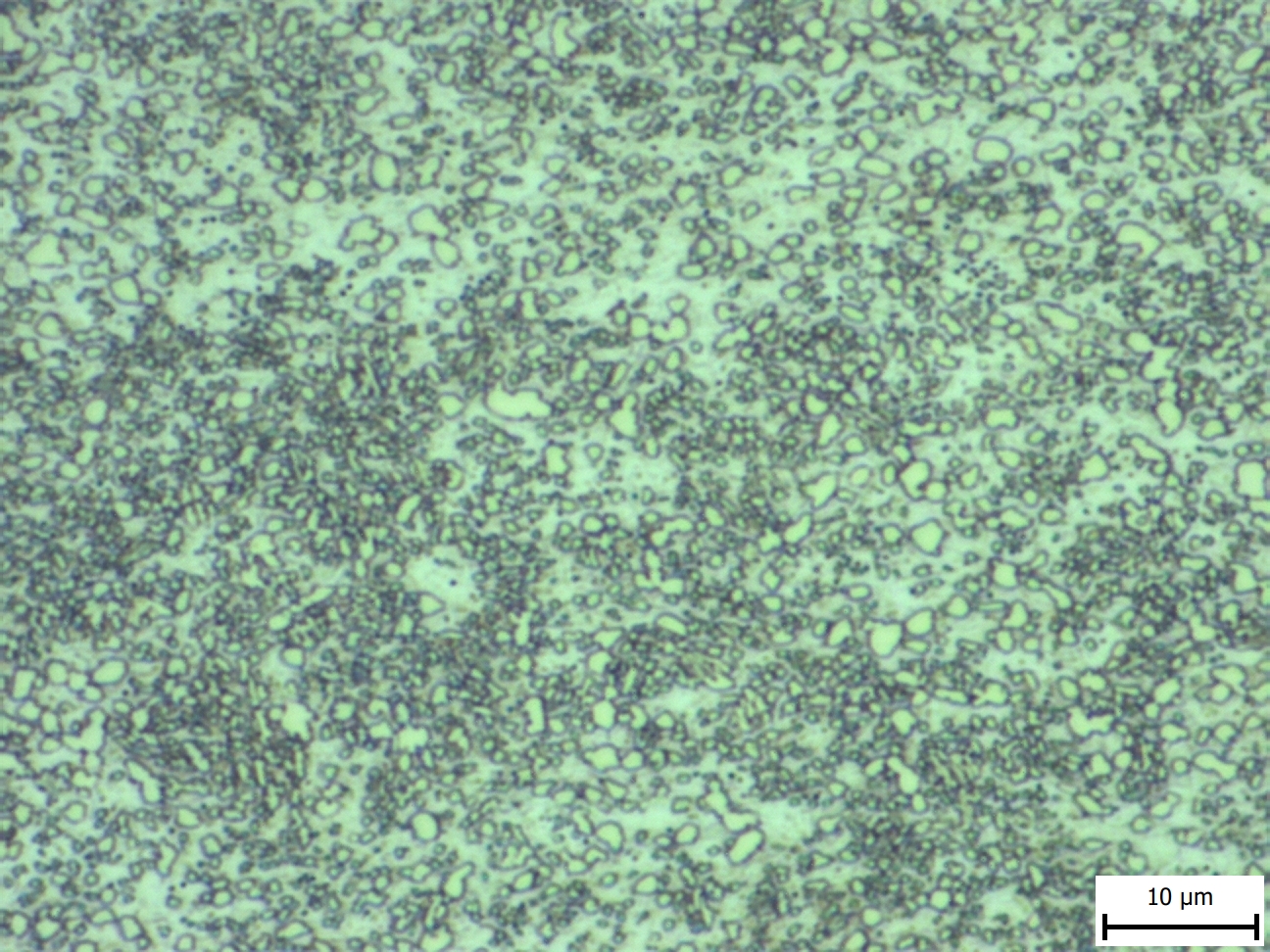

This prior microstructure is important to heat treating response. The larger the carbide structure, the greater the distance carbon and other elements have to dissolve, the longer it takes for austenitizing. You can visualize this by seeing the difference between a coarse spheroidized structure and a pearlite structure in the following schematic diagram. Notice how much further the carbon has to travel from the black carbide in the coarse spheroidized condition:
Spheroidized Carbide
Pearlite
With a pearlite structure you don’t have much control over the final hardness because the carbide dissolves so easily. I prefer the fine spheroidized carbide structure because you have more control over the austenitizing step and can avoid “over-austenitizing” with too much carbon in solution, especially with steels that have more carbon than 80CrV2. For example, see the hardness of 52100 with different austenitizing temperatures from either a pearlite or spheroidized microstructure. The pearlite starting structure has the same hardness regardless of the temperature chosen, while the spheroidized structure led to a range of hardness values. You have control over carbon in solution, final hardness, and final toughness with the spheroidized carbide structure but with pearlite it all has high carbon in solution and high hardness.

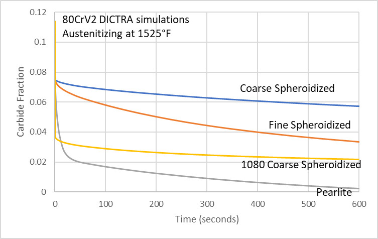

Austenitizing

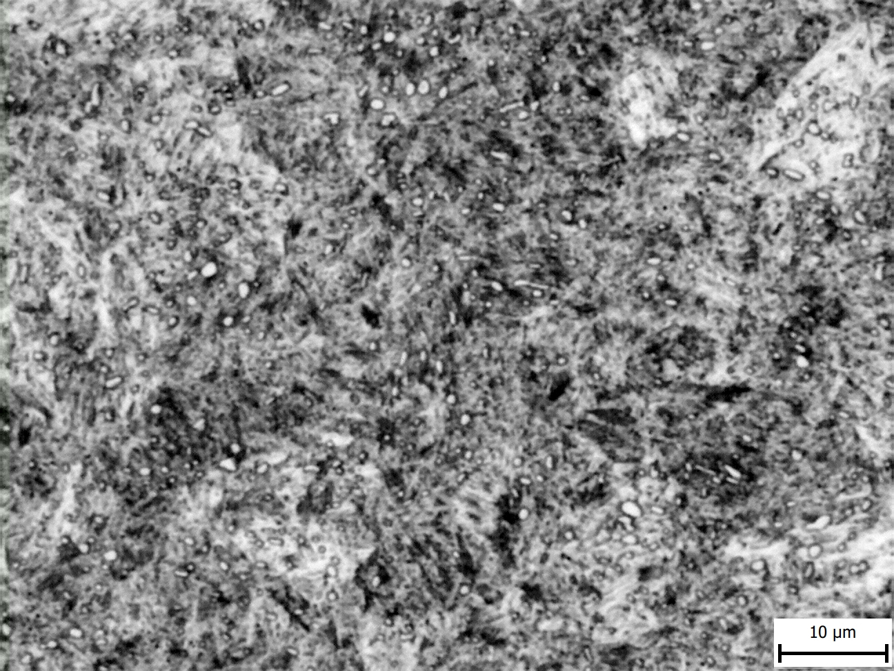

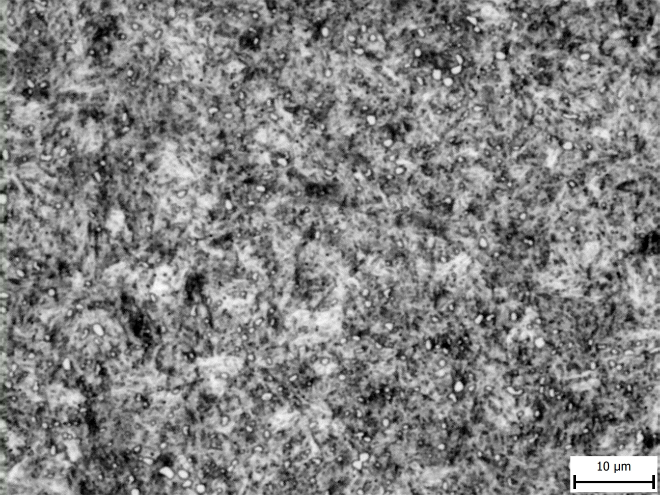

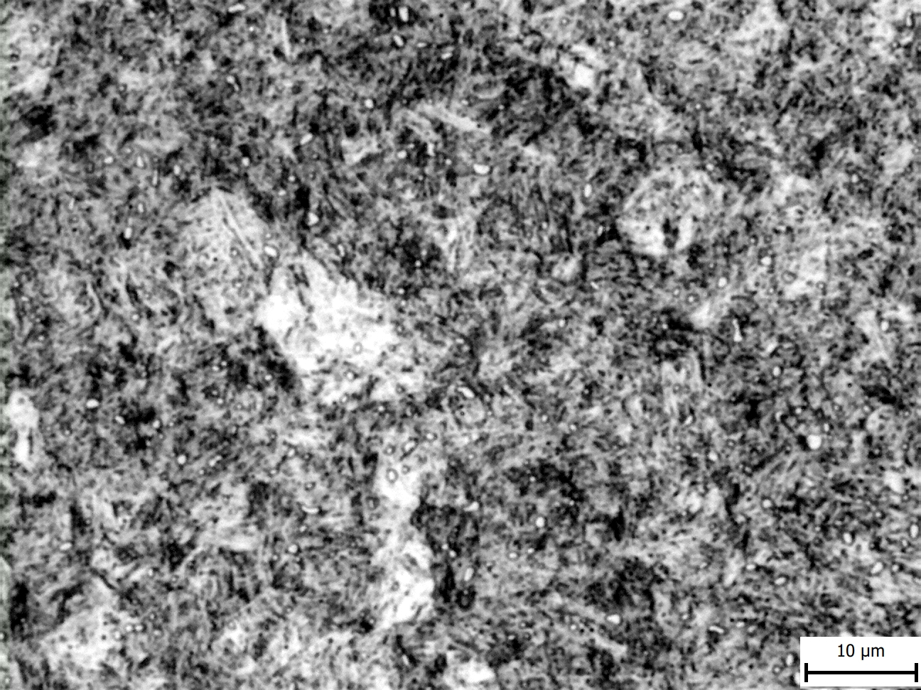

The coarser the carbides the lower the hardness of the steel when austenitizing at the same temperature. The NJSB-cycled material with a largely pearlite structure had very high hardness from only 1475°F. Jantz material, AKS material, and KSN-cycled material all had a similar response to hardening. The Buderus material had the lowest hardness. To make sure this difference was from microstructure I also did the same “KSN cycling” with the Buderus material. In case there were also composition differences or other effects that might have led to the difference. The experiment with “KSN cycling” and a 1525°F austenitize below was performed with both the Jantz and Buderus material and I got 66.1 Rc both times. It was mostly chance that the hardness ended up being identical but even if they had been 0.5 Rc different than each other the point would still stand.
For testing toughness I austenitized the NJSB-cycled material from 1475°F (to match the NJSB datasheet); the KSN-cycled, AKS-supplied, and Buderus-supplied material from 1525°F; and the Jantz-supplied material from 1580°F. That 1580°F temperature was selected to test the higher recommended austenitize from the Bestar datasheet which gave the range of 1545-1615°F (1580 is in the middle of that range).
The AKS-supplied, Jantz-supplied, NJSB-cycled, and KSN-cycled material are surprisingly similar. I’m not sure there is a significant difference between any of them. This is despite the fact that the Jantz material was austenitized at 1580°F and the NSJB-cycled material had a mostly-pearlite starting microstructure. This indicates two things: 1) The vanadium addition is effectively suppressing grain growth up to at least 1580°F. In 5160 a drop in toughness was observed when austenitizing as low as 1550°F as a comparison. 2) The 0.80% carbon content of 80CrV2 is keeping the amount of plate martensite low enough that a drop in toughness is not being seen in the Jantz material austenitzed from 1580°F or the NJSB-cycled material which starts out at a higher as-quenched hardness (more carbon in solution).
Heat treating from the condition supplied by Buderus led to about 3 Rc lower hardness which corresponds with the lower as-quenched hardness. Micrographs of the heat treated toughness coupons are shown below. The amount of carbide remaining in the microstructure after heat treating correlated with how coarse the carbides were prior to austenitizing as seen in the micrographs below. The NJSB-cycled material with a pearlite starting microstructure has virtually no carbide. The somewhat greater amount of carbide found in the others would provide a small benefit for wear resistance and edge retention. The micrographs below are in order from the most carbide (Buderus) to the least (NJSB-cycled).
Buderus 80CrV2 – 1525°F austenitize, 400°F temper
AKS 80CrV2 – 1525°F austenitize, 400°F temper
Jantz 80CrV2 – 1580°F austenitize, 400°F temper
KSN-cycled 80CrV2 – 1525°F austenitize, 400°F temper
NJSB-cycled 80CrV2 – 1475°F austenitize, 400°F temper

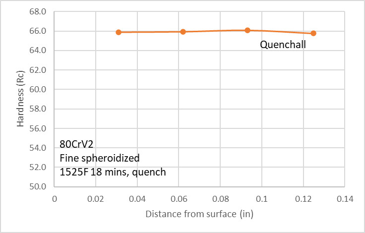

Quenching
The above toughness experiments were done with quenching in two different oils. The AKS-supplied material heat treated by Warren was quenched in Duratherm 48, an oil with speed equivalent to Parks 50. In other words, they are “fast” oils. The rest were quenched in the medium-fast oil AAA. The NJSB datasheet warns against quenching in fast oil and says that reduced toughness may occur. No difference in toughness was observed in these experiments with fast oil. I haven’t seen a reduction in toughness from quenching in fast oil even with very high hardenability steels like 8670. Slower oils can be used to help reduce the chance of warping, however.
I previously did a large study on different quenching oils and different steels which you can read here. One surprise from that study was that 1084 had significantly lower hardenability than 80CrV2. This was surprising because the published hardenability tests of the two steels don’t show much difference, and hardenability measurements with Mn and Cr show that the 0.75Mn in 1084 should be roughly equivalent to 0.5Cr-0.4Mn.
You can also see that the as-quenched 1084 was 66-67 Rc if fully hardened while the 80CrV2 was only 62 Rc. This is because the steels were supplied from Buderus with the coarse spheroidized structure. 1084 with its lack of chromium can still austenitize very rapidly and achieve full hardness even with the coarse structure. However, the chromium addition in 80CrV2 means that chromium must diffuse for carbides to dissolve rather than only carbon. Chromium is a much larger element and diffuses much more slowly. However, if the carbide structure is fine, the 80CrV2 can austenitize more easily such as can be seen in the diffusion simulations below showing the dissolution of carbide with time at austenitizing temperature. 1080 steel with a coarse spheroidized structure has the majority of its carbide dissolved in seconds, while 80CrV2 from the same condition after 10 minutes is nowhere close to the 1080 steel. Fine spheroidized carbides dissolve more readily but that condition is still much slower than 1080 steel. However, a pearlite structure of 80CrV2 austenitizes much more rapidly, even faster than the 1080 coarse spheroidized steel.

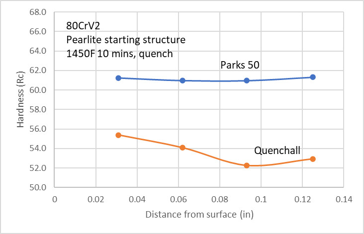

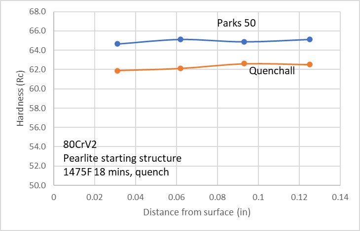

One common question I got after the oil quenching study is what the difference in hardenability would be for each steel if it had a finer starting microstructure rather than the coarse structure found in the as-supplied Buderus material. Typically, a coarse structure leads to higher hardenability than a fine structure, but the fine structure means higher initial hardness so how all that balances out can vary. In this case, using a fine spheroidized structure from KSN-cycling led to 66 Rc with consistent hardness throughout even a 1/4″ piece of steel. The Quenchall oil I used is relatively slow, so this shows that the hardenability of the 80CrV2 is pretty good.
However, when I austenitized and quenched from a pearlite starting structure such as is found in the NJSB-cycled material there was a reduction in hardness with slower oil from the finer structure. In that case I measured a difference between the slow Quenchall and the fast Parks 50.
I also measured the difference in behavior from “under-austentizing” such as sometimes can happen with uncontrolled heat treating in a forge. This led to a further reduction in hardness and hardenability.
So 80CrV2 has reasonably good hardenability. With a fine carbide structure it will fully harden even with 1/4″ stock quenched in slow oil. With a pearlite starting structure the hardenability becomes somewhat more of a concern, at least with 1/4″ stock and a 1475°F austenitizing temperature. Reduced stock thickness or partial bevels would alleviate that.

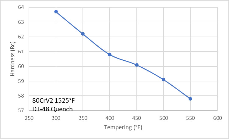

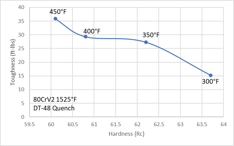

The AKS-supplied material heat treated by Warren was also tempered to different hardness levels and tested for toughness. Below I have the results:
The hardness was reduced with higher tempering temperatures as expected, with about 63.5 Rc from a 300°F temper down to 58 Rc with a 550°F temper. Toughness was also increased with higher tempering up to a peak at 450°F followed by a decrease at 500 and 550°F. This reduction in toughness with higher tempering temperatures comes from a phenomena called “tempered martensite embrittlement” which I have written about here. So I would not recommend tempering 80CrV2 above 450°F. Below I have plotted the hardness-toughness balance after removing the 500 and 550°F tempering temperatures:
There wasn’t much drop in toughness by tempering at 350 rather than 400°F but you get a significant hardness bump by using the somewhat lower temperature. And while there was a significant drop in toughness by using the low tempering temperature of 300°F, the resulting toughness around 15 ft-lbs is still quite high when compared with many other knife steels. So for most knives I would probably recommend tempering in the 350-400°F range, but the 300°F temper looks attractive for thin knives with high cutting performance.

You have a mislabeling on one of the figures.
The hardness vs tempering temp figure is labeled “toughness”.
Fixed
Typo note: under tempering both graphs have y axis label ‘toughness’ one should be hardness.

top of two graphs has y-axis mislabeled as “Toughness (ft-lbs)” rather than “Hardness”
Fixed
