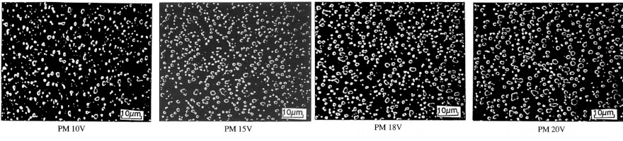

CPM-15V and the Lost CPM-20V – How Much Vanadium Can you Add?
Thanks to Tim Marais, Daniel DeRosia, Jess Hoffman, David Rogers, Mo, John Macklis, and R. Thomas Buffenbarger for becoming Knife Steel Nerds Patreon supporters!
History of CPM-15V
CPM-15V is essentially a higher vanadium extension of CPM-10V developed by Crucible steel in the late 1970s. I wrote about the history of CPM-10V in this article so I won’t copy-paste all of that here. Prior to powder metallurgy technology it was known that adding higher vanadium would lead to greater wear resistance due to the very high hardness of vanadium carbide. However, once the vanadium content exceeded 4-5% the carbides would be large enough that the steel would fail in forging, and toughness would also be reduced. So the highest wear resistance steel for many years was T15 high speed steel with ~5% vanadium. With CPM-10V they saw what the limit was for vanadium additions and found that once they reached about 11% vanadium the carbide size would be increased because the vanadium carbides would form in the liquid steel before the steel could be gas atomized into powder. Read about the powder metallurgy process in this article. The more vanadium that is added the higher the temperature where the vanadium carbides form. When the formation temperature is higher than the temperature of the liquid steel then they form prior to atomization giving the large carbides in the 11% vanadium PM steel below (labeled CPM 11V):

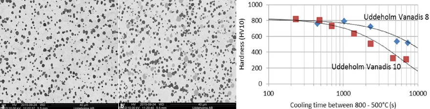

Vanadis 8 – Better than CPM-10V
Thanks to Will and Justin Mann for becoming Knife Steel Nerds Patreon supporters!
My book Knife Engineering is available for Christmas and Hanukkah presents.
History of Vanadis 8
The history of Vanadis 8 goes back a lot further than just the steel itself, really we have to know the history of 10V to know all of the background that is relevant. You can read about CPM-10V in this article. CPM-10V is important because Vanadis 8 is intended as a replacement for CPM-10V, or at least for similar applications. CPM-10V was developed by Crucible in the late 70s, as the first powder metallurgy steel to utilize a microstructure made up of only vanadium carbide, as opposed to chromium and molybdenum/tungsten carbides. This gave 10V a combination of good toughness along with very high wear resistance from the ~10% vanadium and therefore ~17% vanadium carbide.

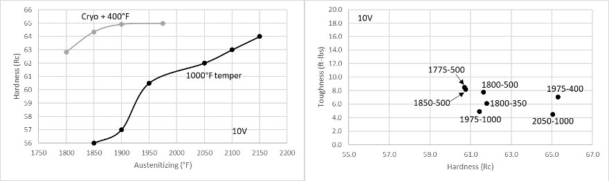

CPM 10V Steel – History, Properties, and How to Heat Treat
My new book, Knife Engineering: Steel, Heat Treating, and Geometry was released last week. The reviews have been coming in and the feedback is very positive so far. Go get one! And make sure you leave a review on Amazon. Also, Australian readers are now telling me it is possible to buy the book now from Amazon USA. So if you had issues ordering in the past give it another try. But do not order from Amazon Australia, see my article to learn why.
