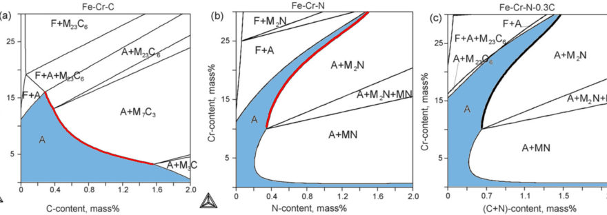

In previous posts I have written about the process by which steel is hardened. The steel is heated to a high temperature phase called austenite, where carbides are dissolved and carbon goes into solution in the austenite. During rapid quenching the carbon is trapped between the iron atoms and a phase called martensite is formed. Martensite gains its high hardness from the distortions to the atomic structure that come from carbon in between the atoms.
