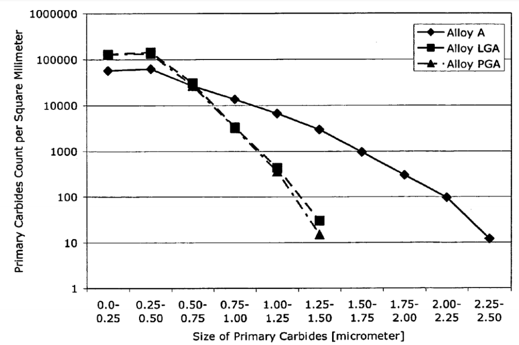

3v Modified – The Lost Crucible Steel
I enjoy reading patents from steel companies, it reveals information about new products and research often not available otherwise. One thing I’m surprised there isn’t more talk about is a steel Crucible patented but never sold – an improved 3V: https://www.google.com/patents/US7615123
