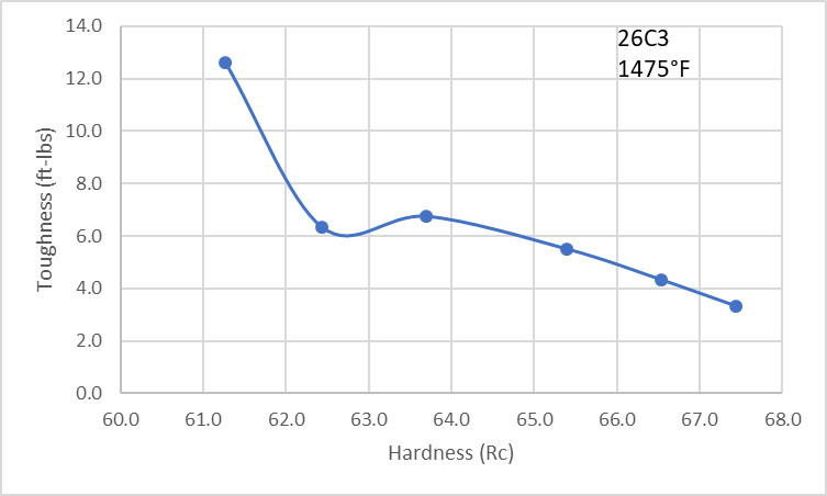

There is a pretty linear increase in toughness between 200 and 350°F. There is a small drop from 350 to 400°F, again I’m not sure if that is real or due to experimental variation. The 450°F temper showed a surprising increase in toughness, and then there was a drop in toughness with a 500°F temper. That drop in toughness at 500°F is due to “tempered martensite embrittlement” which is described in this article. A drop in toughness consistent with TME was seen with 5160 and 52100 at 450°F, for example, so it was somewhat surprising to see such a jump at 450°F with 26C3. Embrittlement was not seen with a 450°F temper of O1 or 1095 so perhaps those are better comparisons with 26C3, though neither of those saw a big jump like with 26C3. Perhaps the jump in toughness looks bigger than it is due to the noted lower than expected toughness at 400°F, perhaps further pointing at those values as being lower than they would be with more tested specimens.

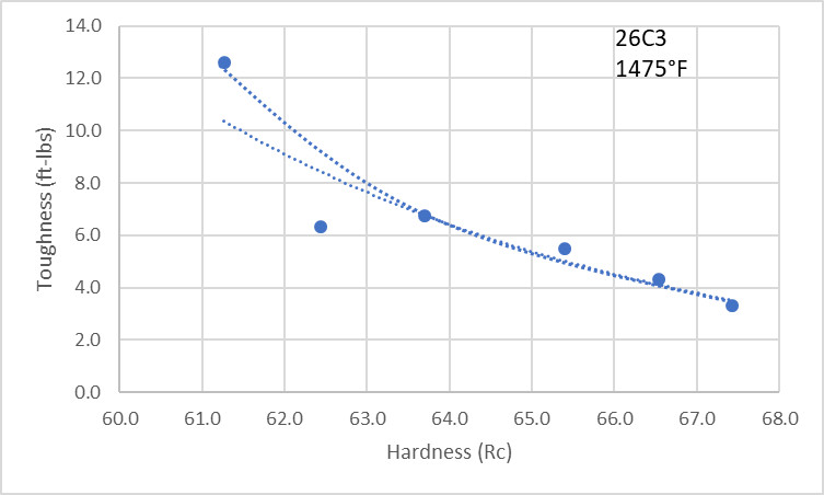

I took out the 500°F embrittled specimen and plotted the rest comparing toughness vs hardness:
If I am right that the 400°F value would be higher with more tested specimens, the “true” behavior may be something like one of the following two fit lines:
Because there is no steep drop in toughness with decreasing tempering temperature, there is no clear minimum tempering temperature recommendation. I usually don’t recommend tempering below 300°F to ensure sufficient tempering for good toughness and to ensure that the “yield strength” is high which doesn’t always correlate with hardness. A 300°F temper led to over 65 Rc and also provided decent toughness. Increasing to 350°F provided 63.7 Rc along with an improvement in toughness. An increase in tempering to 450°F did provide the apparent jump in toughness along with just over 61 Rc for perhaps a bit more balanced properties. However, the real advantage of 26C3 is with fine cutting edges that benefit from high hardness so it seems a bit of a waste to temper that high. Using 52100 at 61 Rc instead would provide more toughness for general knives. So my general recommendation would probably be to temper 26C3 at 300-350°F. Temper at 200-250°F for even higher hardness for extreme knives and at 450°F for pushing 26C3 into more general knives. The 1475°F austenitizing temperature chosen by AKS is a good starting point. These high carbon steels are sensitive to austenitizing temperature in terms of toughness because they can easily have high carbon in solution for brittle plate martensite. So it is possible that even lower austenitizing could lead to better toughness. However, these low hardenability steels usually need some temperature to ensure sufficient hardenability. So I would probably stick with 1475°F without tests showing that another target is superior. The Parks 50 oil used is a good choice considering the level of hardenability of 26C3 though other fast oils could also work.

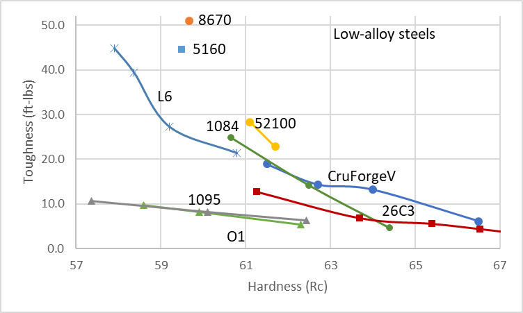

26C3 Toughness Compared with Other Low Alloy Steels
26C3 looks pretty good when compared with other low alloy steels. It has similar or better toughness to 1095 and O1 in our testing despite its higher carbon content. Perhaps that is due to the superior cleanliness and processing of Uddeholmstrip.

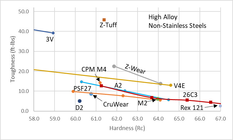

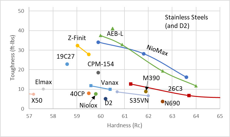

Compared with stainless steels and high-alloy non-stainless, 26C3 also compared pretty favorably, having similar toughness to PM stainless steels, M2, A2, and PSF27:
Uddeholm 26C3 is a good steel for fine cutting knives and razors due to its fine microstructure, low impurities, and high potential hardness. It also offers surprisingly good toughness compared to other steels considering its very high carbon content. Based on our toughness testing a heat treatment is recommended using 1475°F for 10 minutes followed by quenching in fast oil. The recommended tempering range is 300-350°F though both higher and lower is possible for certain knives. It is not recommended to temper above 450°F (tempered martensite embrittlement) or below 200°F (not tested).
