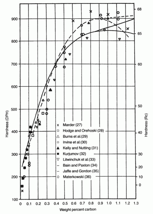

Plate Martensite
One effect of carbon on toughness is the type of martensite that forms when quenching for high hardness. With low and medium carbon steels there is the formation of “lath” martensite which has relatively high toughness. When steels have about 1% carbon or more they form a different type of martensite called “plate” martensite which has lower toughness and sometimes there are “microcracks” that form during the transformation to plate martensite:
Image adapted from [1]

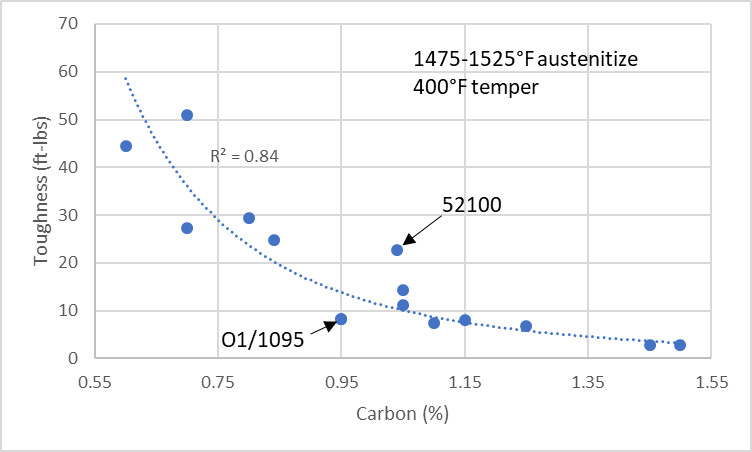

However, in the region between 0.6 and 1.0% carbon there is an increasing amount of plate martensite leading to progressively reduced toughness. And hardness increases by only small amounts above about 0.6% carbon so in general we want to limit carbon “in solution” to be less than 0.6%:
Image from [3]

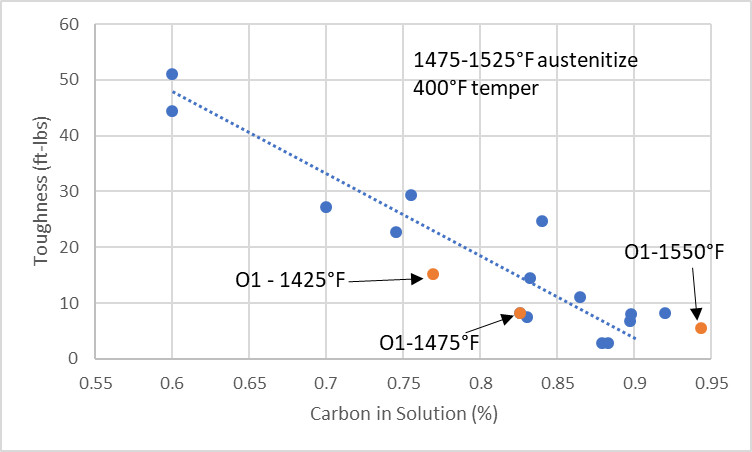

When austenitizing steel, the process where the steel is heated to high temperature prior to quenching, there can be some carbide left undissolved so that not all of the carbon is put “in solution.” So a 1% carbon steel does not have to have 1% carbon “in solution” but could have less, with some carbide left in the steel for contributing to wear resistance. The amount of carbon in solution is controlled by the austenitizing temperature and the time at that temperature. Below I have shown the toughness of the low alloy steels vs a Thermo-Calc calculated carbon “in solution” at 1475°F. The real value would be somewhat lower as this calculation assumes an infinite hold time. 52100 has about 0.5% carbon in solution at 1500°F, for example. But the predicted value is likely to be strongly correlated with the “real” value despite some offset.
You can see that 52100, 1095, and O1 now appear more in line with expectations if we look at carbon “in solution” perhaps indicating that it is the amount of plate martensite which is partially controlling the toughness of the steels. Our two steels with 0.6% carbon in solution have by far the highest toughness. You may wonder what controls the amount of carbon in solution. After all, 52100 has slightly more carbon than 1095, but has much lower carbon “in solution.” Most alloying elements reduce carbon in solution for a given hardening temperature, though Mn is an important exception which can instead increase it. 52100 has 1.5% chromium which reduces the carbon in solution. You can read more about how this works in this article about 52100.
To test this plate martensite hypothesis further I performed another heat treatment on O1 using a lower than normal austenitizing temperature of 1425°F. This lower austenitizing temperature reduces the carbon in solution. I also included in the chart a heat treatment that was previously performed by Warren using 1550°F where carbon in solution is increased. Plotting those out show decent agreement with the earlier trend line. The 1425°F and 1475°F points are still a bit below the trendline but not incredibly so:

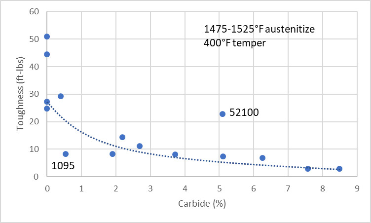

Another factor that affects toughness is carbides within the steel. Higher carbon generally means greater amounts of carbide. Carbides are hard, brittle particles that contribute to wear resistance but are detrimental to toughness. Because of the complications with plate martensite the trends with carbide are not as “clean.” I drew in an approximate trendline, but the steels with lower carbon in solution (52100, 5160, 8670) have significantly higher toughness. And 1095 with its high carbon in solution has relatively poor toughness despite only a small amount of carbide.

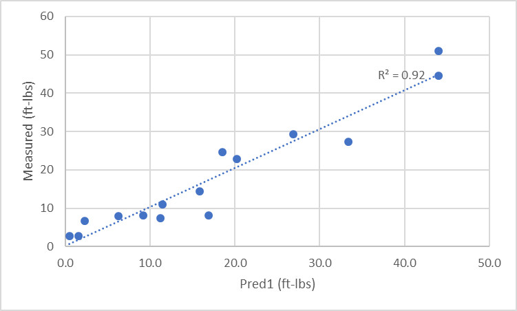

If we generate a regression to predict toughness of low alloy steels, including the contribution of carbide does generate a better prediction, with an R2 value of 0.92 rather than 0.87 (1.0 is a perfect correlation).
Toughness (ft-lbs) = 107.5 – 105.9*C(in solution %) – 1.638*carbide(%)
The steels 1084 and 80CrV2 had very good toughness even relative to their carbon in solution, which is likely due to the fact that they have little or no carbide retained after heat treatment. I do not have micrographs for those two steels but I do for many of the others so that the carbide structure can be observed. The carbides are the white particles visible in the images. 5160, L6, 1095, and 8670 have very little carbide. The relatively high carbon in 1095 along with very little carbide after heat treatment is a good indication that most of the carbon is in solution which aligns well with our earlier predictions.

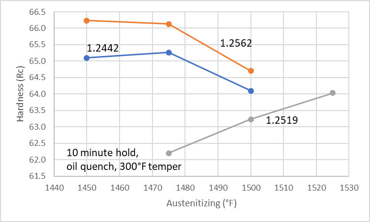

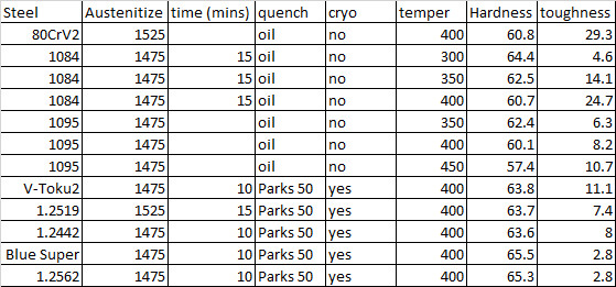

Austenitizing Temperature
As one good example with balancing carbide, carbon in solution, and grain growth you could look at our study with 5160 toughness testing. Hardness increased by using 1500°F instead of 1475°F but was flat with higher temperature. Presumably more carbide was dissolved by increasing to 1500°F but because of the relatively low carbon content there isn’t a danger of plate martensite. Toughness was flat using 1475-1525°F but higher temperatures led to a significant reduction in toughness, presumably due to grain growth. Therefore the balance leads us to an optimum of 1500-1525°F.
Another steel that acts somewhat similarly is 52100 due to its relatively low carbon in solution. Higher austenitizing temperature led to increased hardness and toughness due to dissolving more carbide. At some temperature plate martensite starts to drop toughness. This led to an optimal austenitizing temperature of 1500-1525°F just like with 5160.
As described earlier in this article about O1, for steels with significant amounts of plate martensite it can often help to decrease the austenitizing temperature despite the higher carbide fraction. Reducing the austenitizing temperature means less carbon in solution, less plate martensite, and often an improvement in toughness. Below shows a summary of O1 heat treatments which indicates the austenitizing temperature (1425, 1475, or 1550°F) and tempering temperature (350, 400, or 450°F). The 1550°F austenitize included a cryo treatment but the others heat treatments did not. You can see that even when tempered to a similar hardness the lower austenitizing temperatures led to improved toughness:

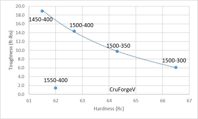

With CruForgeV toughness had a consistent hardness-toughness balance when austenitizing between 1450 and 1500°F, but using 1550°F led to a dramatic reduction in toughness, probably due to plate martensite though maybe grain growth also contributed.

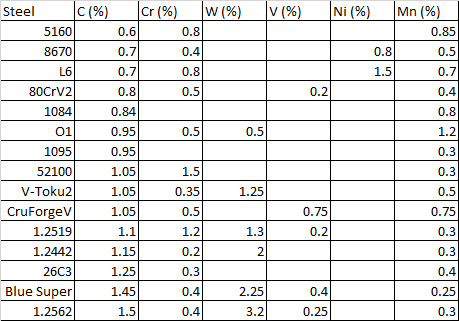

To provide a very loose recommendation, steels with higher than 0.85% carbon and less than 0.75% chromium benefit from 1475°F or below. This has to be balanced against ensuring the steel has been fully austenitized (no remaining ferrite) and that the steel has sufficient hardenability to fully harden during quenching. Perhaps 1400 or 1425°F would be a reasonable lower bound but that would require experimentation with the chosen steel.
Steels with less than 0.85% carbon or more than 0.75% chromium can often benefit from austenitizing a bit higher, such as 1500-1525°F.

1.2519 is an example of a steel with a significant chromium content like 52100 where the hardness did not drop from excess retained austenite even at 1525°F. Similar behavior was seen previously in the hardness vs austenitizing chart for 52100. 1.2442 has only a small chromium addition so it reached its peak hardness at 1475°F but the hardness difference was small between 1450 and 1475; therefore the steel shouldn’t be austenitized higher than 1475°F and perhaps should be austenitized lower such as 1425 or 1450°F. 1.2562 with its very high carbon showed a drop in hardness even when increasing the austenitizing temperature from 1450 to 1475°F. So for this steel the max austenitizing temperature is instead 1450°F and maybe even lower. A lower carbon steel like 1084 or the previously shown 5160 instead reach a hardness plateau at some austenitizing temperature because the carbon in solution maxes out at a point where large amounts of austenite are not retained (though that does not mean zero retained austenite). With those steels it is probably best to austenitize at the temperature where the plateau begins and not higher where grain growth may occur.
The prior structure of the steel being heat treated, the time at austenitizing temperature, the speed of the quench, and the composition of steel (it varies even within a single grade) will all affect where the peak hardness is found. The prior structure of the steel matters, because when buying steel from different manufacturers their annealing process may be different. And if you forge some blades and use stock removal on others the heat treatment response is likely to be different as your annealing process is not going to be the same as the steel mill. And obviously if you change to a different annealing procedure the heat treatment response will be different. Keep austenitizing time consistent when developing hardness curves so that that factor does not change, though using different thicknesses of steel can confuse that a bit. Speed of the quench matters as slower oil quenches typically shift peak hardness to higher austenitizing temperatures. And different heats of steel will also show some variation as it may be on the high or low end for carbon content, chromium, manganese, etc.

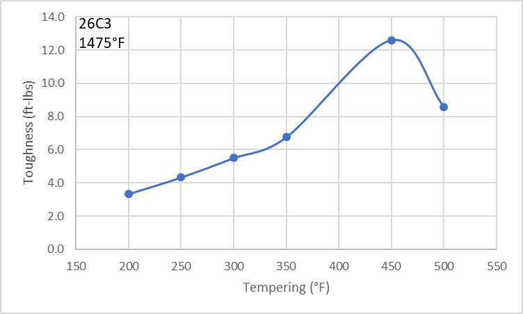

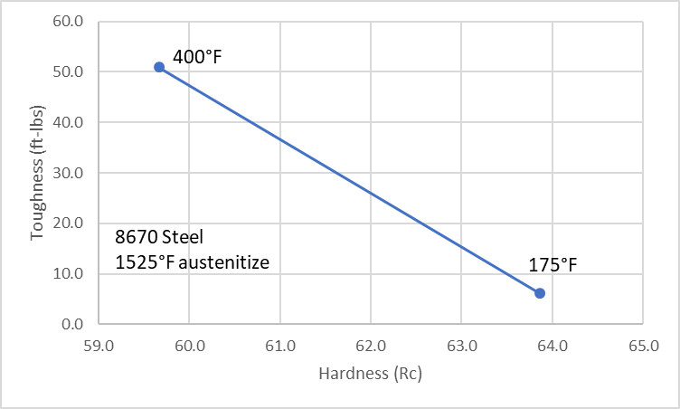

If the steel is not tempered at sufficiently high temperature the toughness is much lower. This seems to be more of a problem with high toughness steels like 5160 and 8670. For example, tempering 5160 at 350°F led to significantly reduced toughness relative to 375°F even though the hardness was only marginally higher.
A similar result was seen with 8670 with tempering at 175°F led to relatively high hardness but quite low toughness, lower than many of the high carbon steels when tempered to the same hardness. Some knifemakers make a mistake in assuming that a “tough” steel will do well at high hardness, when it is often better to switch to a higher carbon steel that is better designed for achieving that greater strength. We will look at more tempering temperatures with 8670 in the future to find the point at which the balance is off. So I typically recommend tempering steels no lower than 300°F though as can be seen with 5160 sometimes this minimum tempering temperature can be higher.
Tempering too high can also pose a danger, such as the 5160 tempering chart shown previously where a 450°F temper had somewhat less toughness than 400°F. While this drop in toughness may appear relatively small, there was also a drop in hardness, so the hardness-toughness balance has been reduced by using 450°F. A 400°F temper instead leads to both higher toughness and hardness for better properties overall. This effect is called “tempered martensite embrittlement” which you can read more about here. Larger cementite plates form when tempering at those higher temperatures which embrittle the steel. Here is another example, 52100:

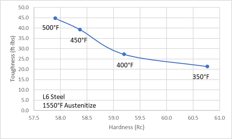

Tempered martensite embrittlement (TME) starts around 450 or 500°F in low alloy steels (depending on the steel and austenitizing temperature) and you don’t know at which tempering temperature TME will start without quantitative toughness testing. So I typically recommend tempering no higher than 400-425°F without toughness data. 400°F tempering, in general, is a good starting point for most steels as it is unlikely to lead to either undertempering or tempered martensite embrittlement. 26C3 still showed an increase in toughness by using 450°F tempering. A 500°F temper with 26C3 did show a reduction in toughness, however:
L6 steel still showed good toughness with a 500°F temper. Perhaps its many alloy additions suppressed the formation of the cementite plates to even higher temperatures. Higher austenitizing temperatures can also shift TME to higher tempering temperatures so maybe the 1550°F austenitize used also contributed to the suppression of TME.

Here is a table summarizing the heat treatments used in toughness testing of the other low-alloy steels that have not previously been written about. All of these steels were heat treated from the condition supplied by the steel manufacturer. See the individual articles about other specific steels because some of those explored other prior conditions.
