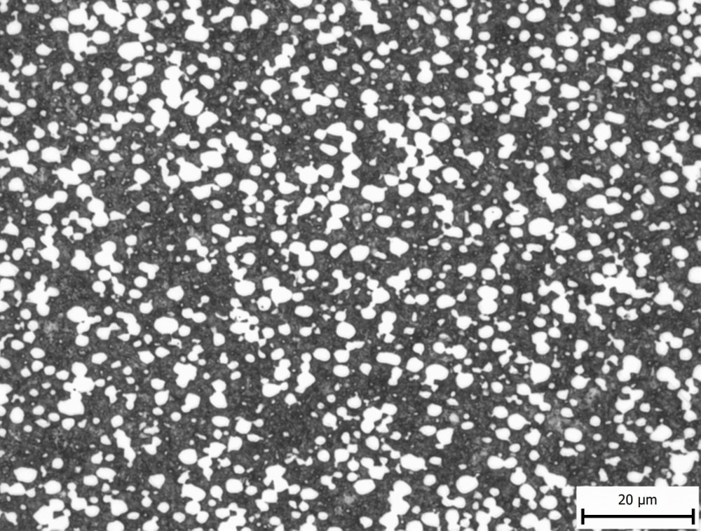

10V (1800°F) = 16% carbide volume

You can see that with increasing carbide content the carbides become larger and increasingly “clumpy” meaning they are touching each other. This increasing carbide content means that toughness is reduced but wear resistance is increased. Rex 121 has extremely high wear resistance while Z-Tuff has relatively low wear resistance. I don’t know where to insert Maxamet in this article so here it is:

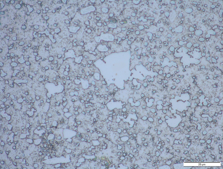

Conventional D2 (1900°F)
PSF27 (1925°F) – Sprayform D2

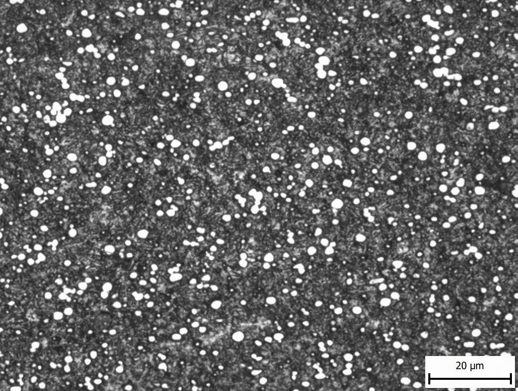

CPM D2 (1900°F) – Powder Metallurgy D2 – 13% carbide volume

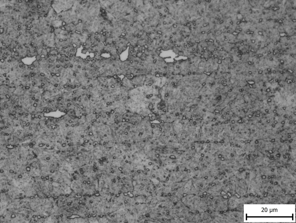

Not all conventionally produced steels have the same looking microstructures. It is highly dependent on the amount of carbide and the carbide type. M2 high speed steel has a finer and better distributed microstructure than the previously shown D2 or CruWear:

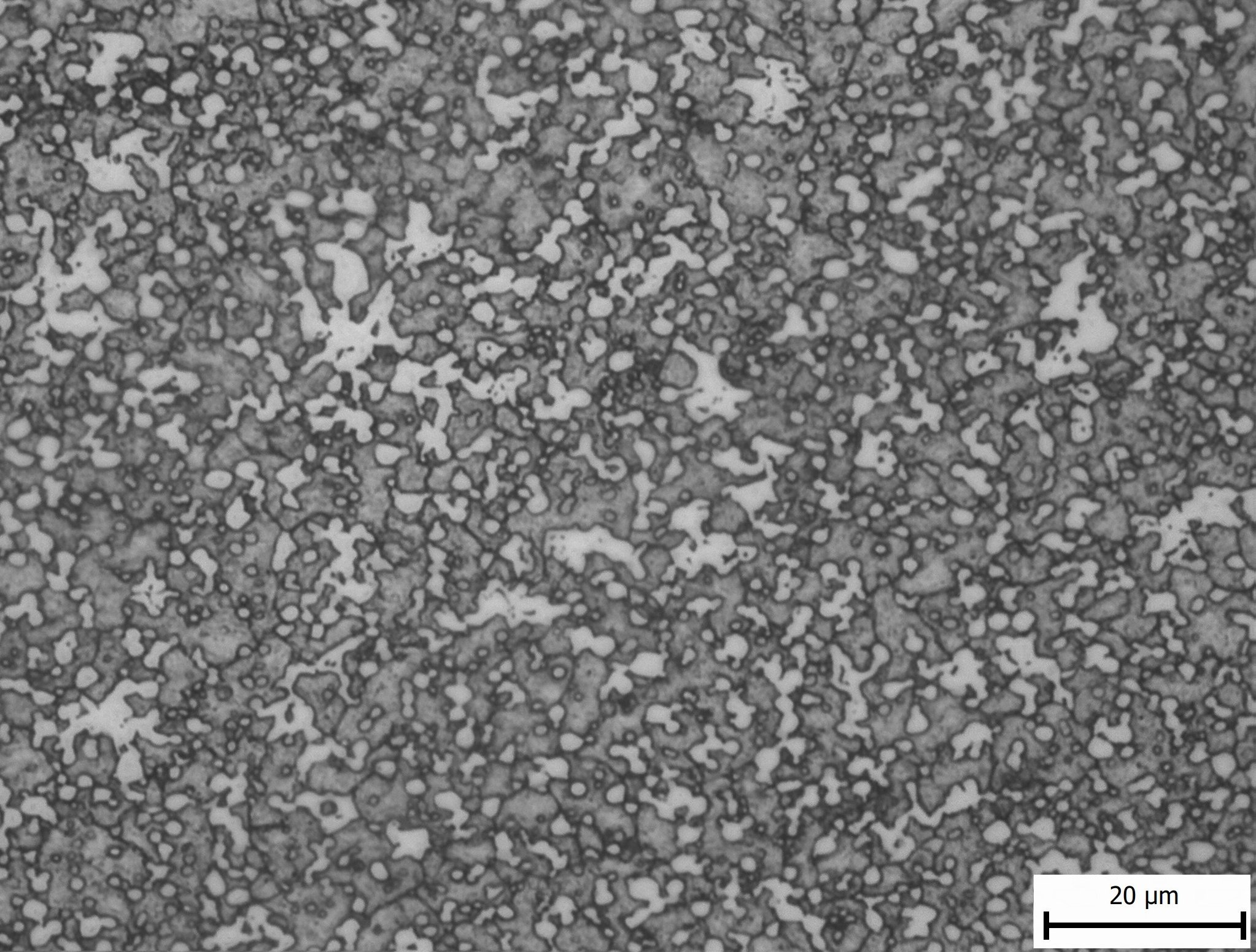

Conventionally produced M2 (2100°F)

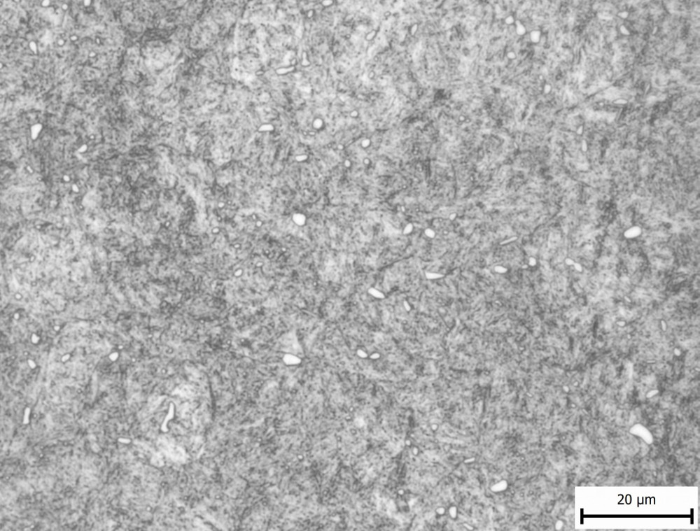

AEB-L (1975°F)
LC200N/Cronidur 30/Z-Finit (1905°F)
Nitro-V (1950°F)

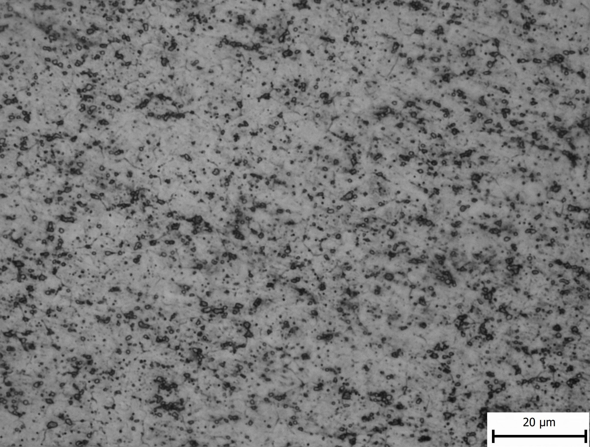

14C28N (1950°F)

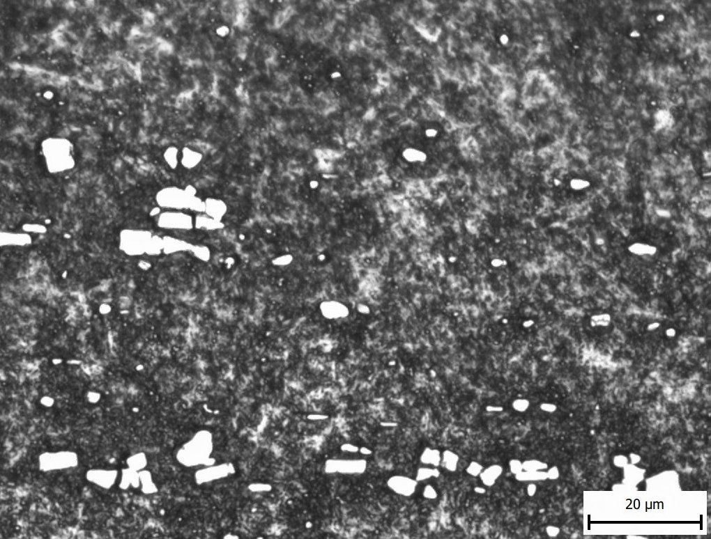

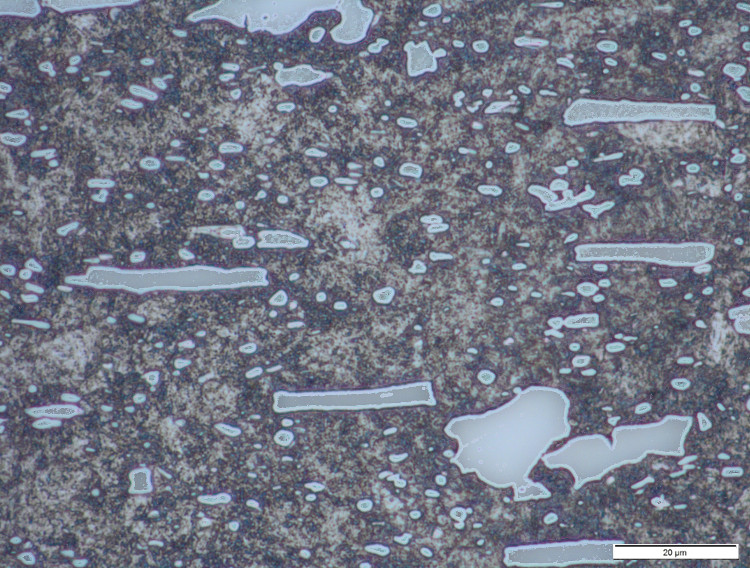

There are not many stainless steels with intermediate carbide contents. X50Cr15MoV (1.4116) has a usually fine microstructure but there are occasional large carbides which may be detrimental to toughness. The top image shows a region with fine carbides, and the second image shows a segregated region with a large carbide:
X50Cr15MoV/1.4116 (1925°F) – area 1
X50Cr15MoV/1.4116 (1925°F) – area 2

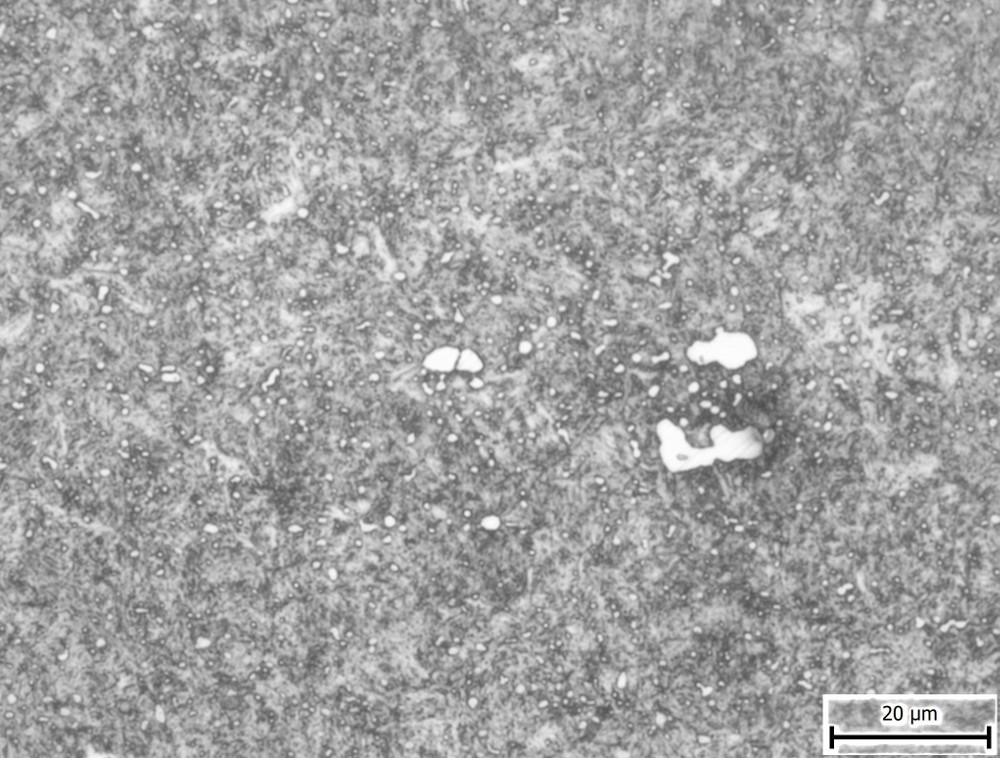

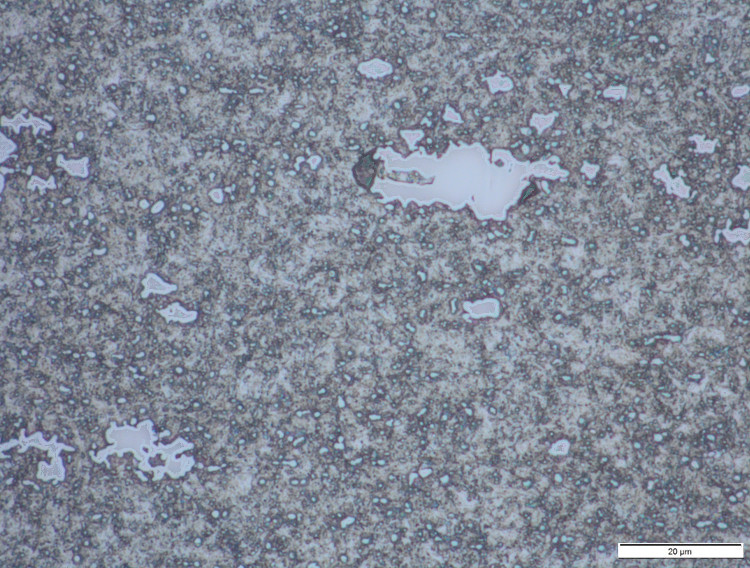

Niolox is another example of a steel with inconsistent carbide structure. Some areas are relatively fine with occasional larger carbides that are several microns across. However, there are relatively large segregated regions with large chromium carbides:
Niolox (1975°F) – area 1
Niolox (1975°F) – area 2

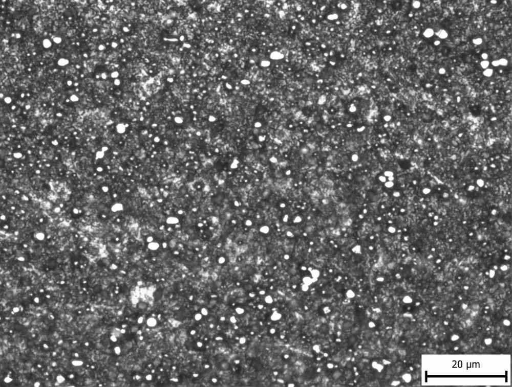

The powder metallurgy stainless steels all have relatively high carbide volumes, I have ordered them by carbide volume. I am not aware of any PM stainless steels with less than about 13% carbide volume. This is why there aren’t any high toughness Z-Tuff, 3V, 4V, or CPM CruWear type stainless PM steels, because the carbide volume is not low enough.
S35VN (1975°F) – 15% carbide volume
CPM-154 (1950°F) – 16.5% carbide volume

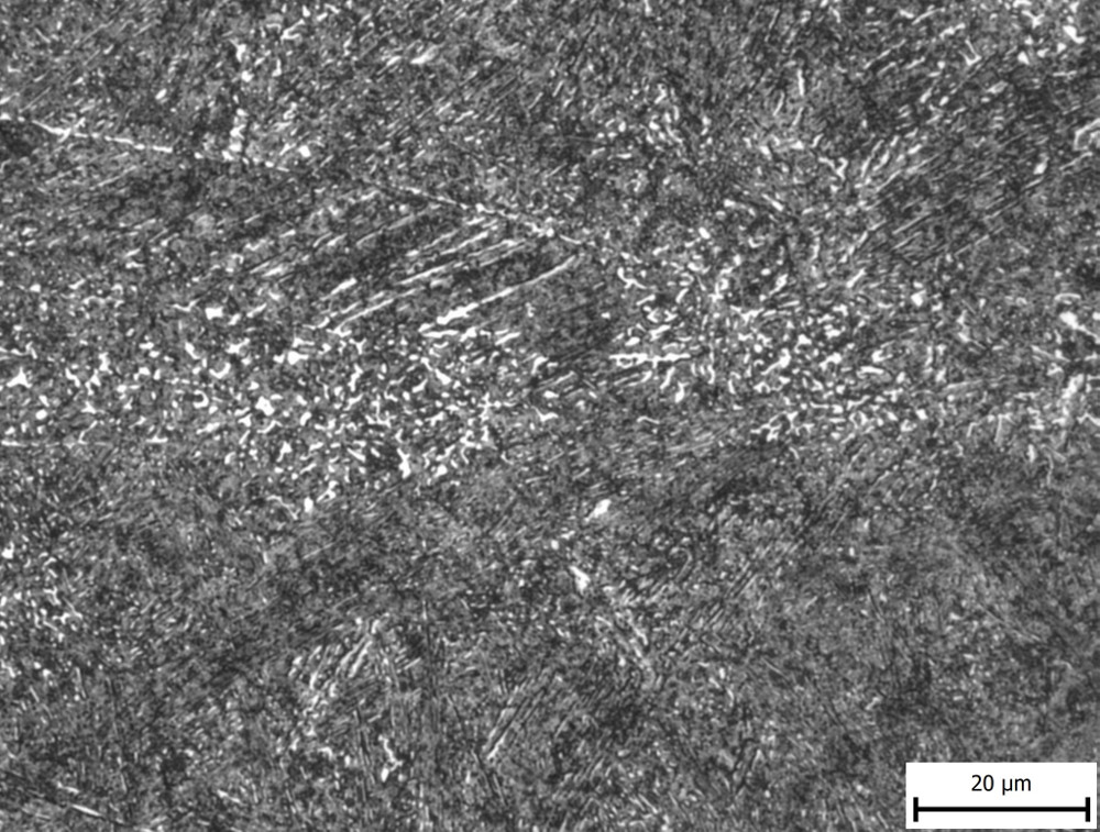

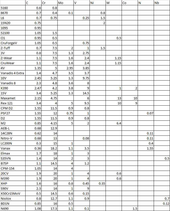

Low-alloy steels used in forging typically have relatively small amounts of carbide. For some reason I had a hard time removing scratches from these steels so there are stray scratches visible in some of the micrographs. The high toughness steels 5160, 15N20, L6, and 8670 barely have any carbide at all:

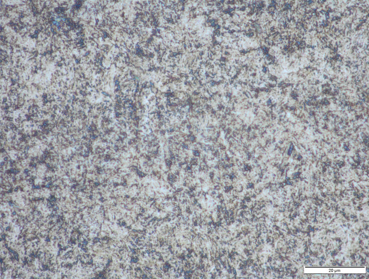

5160 (1525°F)
8670 (1525°F)
L6 (1550°F)
15N20 (1475°F)

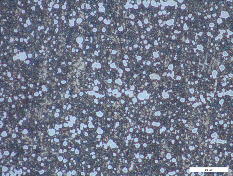

The common high carbon steels 1095, 52100, and O1 have some carbide, still less than 6% or so. The carbides are, in general, very fine, though O1 has the largest carbides followed by 52100 and finally 1095. This surprised me because typically it is reported that 52100 has the most carbide, and ThermoCalc predicts over twice as much carbide in 52100 as O1. However, the smallest carbides are not well resolved by the microscope so determining the carbide volume is difficult without scanning electron microscopy.
1095 (1475°F)
52100 (1500°F)
O1 (1475°F)

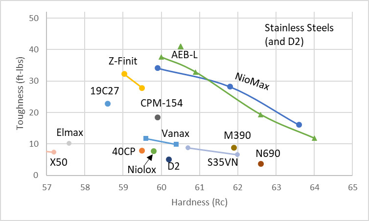

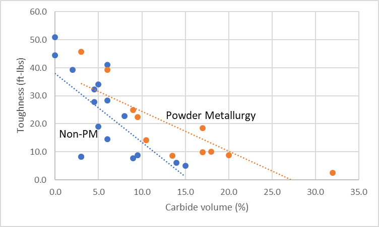

We can now compare our toughness measurements with carbide structure. Larger carbides and more carbide leads to poor toughness. However, having a small volume of small carbides is not a guarantee of high toughness. A steel that is overheated in hardening and then tempered in the embrittlement range will have poor toughness nor matter what. But there are more subtle factors that lead to different levels of toughness even if heat treated “optimally.” We don’t always know how the different alloying elements and steel processing interact to lead to the final properties that we measure. High carbon in solution leads to brittle “plate martensite” which reduces toughness. Nickel additions can improve toughness, particularly at low temperatures. And silicon suppresses carbide formation in tempering to avoid tempered martensite embrittlement. Therefore the carbide volume of the steel can be thought of as the “upper limit” of possible toughness. A 30% carbide volume steel is never going to have the toughness of a well heat treated 8670 or Z-Tuff, but a 0% carbide steel can be just as brittle. Ideally we would like to use steels that have the best possible toughness and wear resistance for a given amount of carbide. Some steels seem to outperform their carbide volume, which would be an example of a steel with near-maximal toughness for that amount of carbide. And some steels seem to do poorly in toughness testing despite small carbides. I will discuss a few examples here:
L6, 5160, 8670, Z-Tuff, 3V, AEB-L, NioMax, 52100, and Z-Finit all have a small volume of small carbides and that is reflected in their excellent toughness. Those steels show the benefits of a small volume of carbide. Steels with large carbides or a large volume of them include D2, Rex 121, and N690, and all of those have relatively poor toughness. The sprayform version of D2, PSF27, has roughly twice the toughness of D2 due to smaller carbides. I have not tested the toughness of CPM D2 yet. Z-Wear (CPM CruWear) also has double or better the toughness of conventional CruWear due to the powder metallurgy process. In those cases decreasing the carbide size while maintaining the same carbide volume improved toughness. The toughness of CPM-154 with 16% carbide volume was significantly better than Vanax, Elmax, or S35VN which have a similar amount of carbide. And that is despite CPM-154 having larger carbides than either of those steels. The reason for the better toughness of CPM-154 is not known to me. Perhaps the more “clumpy” carbides in Elmax or S35VN is detrimental to toughness. Or maybe the high molybdenum or CPM-154 leads to improved toughness. Vanax and Elmax have a similar amount of carbide/nitride, but the Vanax has smaller particles, which may explain why it has improved toughness in comparison to Elmax. M390 has slightly better toughness than S35VN despite having more carbide, and again I do not know the reason. It is probably due to more subtle alloy in solution or retained austenite differences which are more difficult to pin down. O1 and 1095 have small carbides and a small volume of them but both have significantly less toughness than steels like 52100 or AEB-L. My guess is that those steels are more likely to form “plate martensite” due to high carbon in solution but I can’t say for sure. I explained why 52100 has less carbon in solution in this article. The X50Cr15MoV steel has surprisingly low toughness, perhaps that is explained by the scattered large carbides that were seen in the micrographs. Niolox has a little bit less toughness than PM stainless steels like S35VN or Vanax which is probably also explained by the large carbides that are found in the steel.
I have correlated carbide volume versus toughness in the chart below, for hardness between 58-62 Rc, except for Rex 121 which was 67 Rc. It is clear there is a correlation between carbide volume and toughness but there is a significant amount of scatter for the reasons described above. 1095 and O1 in particular throw off the trend lines. Powder metallurgy in general shows better toughness for a given amount of carbide, but the difference is greatest for high carbide volumes. At small amounts of carbide non-PM steels can have similar or better toughness depending on the composition.
I also have extensive articles on the effect of carbide on edge retention: Part 1 and Part 2. The type of carbides is much more important for edge retention while for toughness it is the size and volume of carbide that primarily matters. I also have tables in both articles that have experimentally reported carbide types and amounts for a wide range of knife steels which come from different sources, mostly datasheets, patents, and journal articles. The exact numbers may not line up perfectly with those reported in this article because I measured the carbide area myself from the micrographs. Vanadium and niobium carbides are the hardest and they contribute the most to edge retention. In order of decreasing hardness, next comes chromium carbides, then molybdenum/tungsten carbides found in high speed steel, and finally iron carbide (in low alloy steels). Therefore we would expect low alloy steels with iron carbide only to have significantly less wear resistance and therefore slicing edge retention. Read those two articles to learn all about it.
