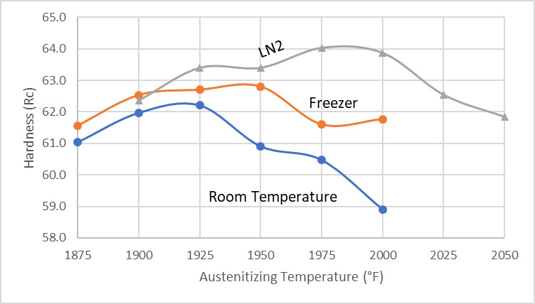

4. XXXX steel “needs” or “doesn’t need” cryo. I see frequently from knifemakers statement like, “I chose AEB-L because it doesn’t need cryo.” Or “Carbon steels don’t need cryo.” Or “Stainless steels need cryo.” This shows a fundamental misunderstanding of what cryo does or doesn’t do. I explained the mechanisms behind cryo in this article. It isn’t a light switch that either affects a steel or doesn’t. During quenching from high temperature, the steel hardens through the formation of a steel phase called martensite. The formation of martensite is measured with a “start” and “finish” temperature and the closer to the finish temperature you reach the more martensite forms and the closer to the maximum hardness you will achieve. Those formation temperatures are controlled by the steel composition and also the heat treatment, as higher hardening temperatures put more carbon and alloy “in solution” to affect the martensite formation. When the martensite finish temperature is below room temperature there will be some amount of “retained austenite” which isn’t transformed to martensite leading to lower hardness and other effects. Using cryo or other cold treatments means you get closer to martensite finish and retained austenite is reduced. Virtually any knife steel can be heat treated with or without cryo, depending on the hardening temperature that is selected. However, higher hardness levels can be achieved when using cold treatments, see the chart for AEB-L below, where the minimum temperature is labeled as “LN2” (cryo), “freezer” (a household freezer), or “room temperature” (no cold treatment):
You can see that the hardness peaks around 62 Rc with no cold treatment, using a hardening temperature of 1925°F. Above that temperature the hardness drops because of excess retained austenite, usually amounts greater than 15-20%, which is undesirable. Using liquid ntirogen with the same hardening temperature gets about 63.5 Rc as-quenched. Yet higher hardening temperatures can be used in combination with liquid nitrogen up to a hardness of about 64 Rc.

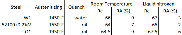

“Simple” carbon steels also have retained austenite and are affected by cold treatments. Here is a chart of retained austenite contents and hardness values achieved with and without cryo with low alloy steels:
Data from [2]
Now just because the retained austenite can be reduced with cryo doesn’t mean that you have to do so. However, you can do the same with high alloy and stainless steels with appropriate selection of austenitizing temperature. Those high alloy steels don’t “need” cryo either.

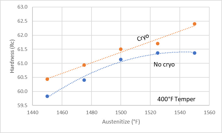

5. Cryo improves edge retention. Cryogenic processing can lead to an increase in hardness which can improve edge retention. In that way, this is not a myth. However, there is a whole industry of cryo companies advertising incredible improvements in wear resistance from cryogenic processing. Some of these claims are even found in peer-reviewed journals. I reviewed the literature in this article. I also performed an edge retention comparison between cryo and non-cryo D2 steel and found no difference apart from hardness, see that here. Another study on 154CM had a more extensive comparison where also no difference was found.

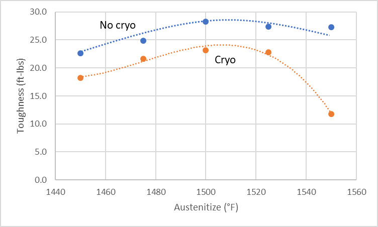

6. Cryo improves toughness. Cryo companies also advertise that cryo improves toughness, despite the fact that the majority of studies have found a reduction in toughness with cryo. I reviewed the literature here. Below is an example from our 52100 heat treatment study that shows the drop in toughness and improvement in hardness with cryo:

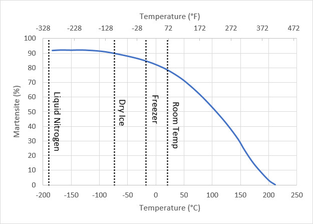

7. A freezer doesn’t do anything; at least dry ice temperatures are necessary for cold treatments. As described previously, martensite finish temperatures change for different steels and hardening temperatures, and the closer you get to martensite finish the lower the retained austenite. Cryo is not an on/off thing, and the colder you go the better for minimizing retained austenite. I found this with my own experiments of AEB-L as in the previous plot. Below shows martensite content for T1 high speed steel at different temperatures:

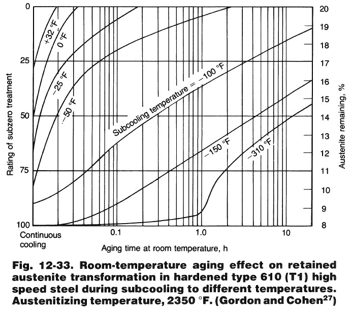

One other factor to keep in mind, however, is that retained austenite “stabilizes” if there is a delay between the quench and going into the cold treatment. Below shows the retained austenite for different cold treatments after different delay times at room temperatures. Make sure you get out of the quench and straight into the cold treatment no matter what steel and heat treatment is being used. In this case half of the retained austenite that transforms with liquid nitrogen can be eliminated with a freezer, but only if there is no delay at room temperature.
