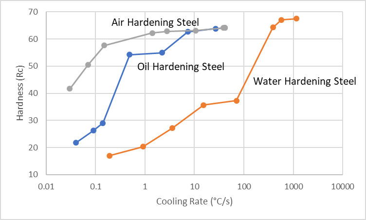

5. Insufficient quench speed after austenitizing. Different steels require different quench rates to achieve full hardness. Some steels can simply be left in air and will fully harden, others need a very fast oil quench or even a water quench to fully harden. If cooled too slowly, soft phases like ferrite or pearlite will form rather than the desired hard martensite. Those phases reduce the strength of the steel. Certain alloying elements like manganese, chromium, and molybdenum suppress the formation of ferrite or pearlite so that slower cooling rates are possible. The required cooling rate for a given steel is called its “hardenability” which I have written about in this article. Carbides can also form along grain boundaries during slow cooling, and those carbides reduce toughness. Steels with high hardenability that can be cooled in air and fully harden are called “air hardening,” steels with medium hardenability designed to be quenched in oil are called “oil hardening” and the lowest hardenability steels are called “water hardening.” Below shows hardness vs cooling rate for a water hardening, oil hardening, and air hardening steel, where you can see that much higher cooling rates are necessary to fully harden the water hardening steel.
The required cooling rate is also affected by the austenitizing treatment, typically higher austenitizing temperatures leads to higher hardenability and a slower required quench. This is most important with low hardenability steels like 1095 and W2 where insufficient austenitizing can lead to soft spots after quenching. This is balanced against austenitizing at too high a temperature for reasons described in number 3. There are many quenchants available, including a range of different oils. Oil designed for quenching is best, and must be selected based on speed. A “fast” oil can be almost as fast as water, while a medium or slow oil provides less distortion and risk of cracking for steels with higher hardenability. Some knifemakers try to use less expensive oils like canola and while they can work, they may not be optimal for certain steels, and the oil will eventually go bad and no longer work well.

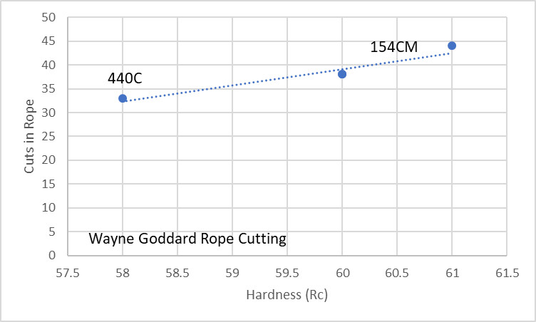

Similar principles apply when it comes to edge retention and wear resistance. Moving to higher hardness will provide better edge retention. However, edge retention can be improved much more by using a steel with more carbide and/or harder carbides. Below shows wear resistance vs hardness for several steels as tested by Carpenter steel, where you can see that moving to a higher wear resistance steel is more effective than increasing hardness (lower is better on the chart):
Similar differences are seen in CATRA and rope cutting edge retention testing.
